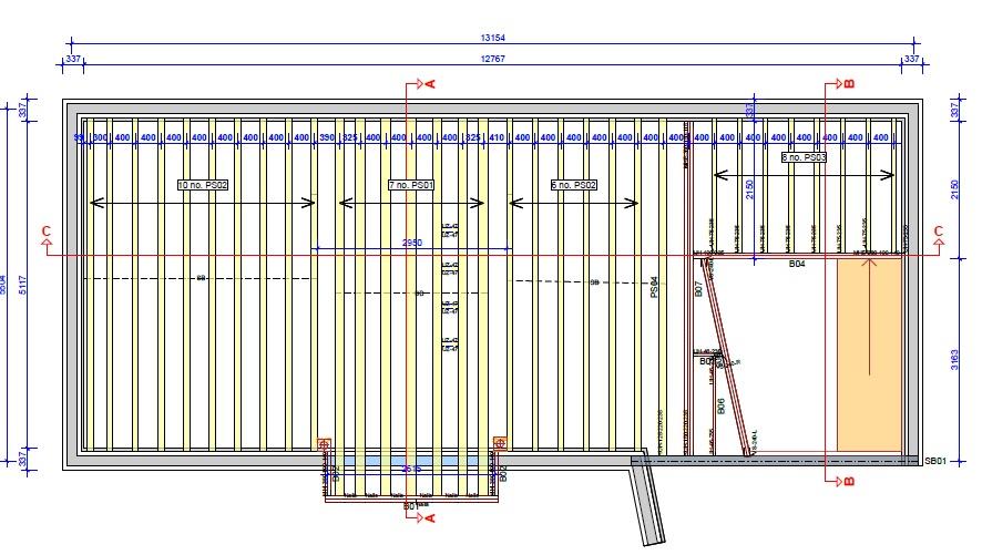

Mulberry View Posted October 13, 2023 Posted October 13, 2023 Our First Floor layout is pretty simple. Here's our latest Posi design. I specified a target of under 10mm deflection, which this design achieves. What is the best way to hang these joists in a Nudura build? My current mindset is in fixing Ledger Plates to the long walls in the required places before the pour, with pocketed concrete protrusions and J-bolt fixings. This would remove the need for resin fixing and also the need for cutting back the insulation. Any pitfalls to this method? Beyond this, am I best to top chord hang the joists or use normal hangers onto the Ledgers?
Russell griffiths Posted October 13, 2023 Posted October 13, 2023 The big problem with fitting the ledger board before the pour is the braces for the icf, if the ledger board is in the way it’s a right pain to fix the bracing. If your heights and design allows it to be fitted first then that’s what I would do. After that go for top hanging the joists, no hangers needed so money to save, and the sit really flat, just get the design done around that because there will be extra blocking between the joists to prevent sideways twisting. You will also also need some very very straight timber for the ledger board. i would use a metro beam from the joist manufacturer for them, and tell them if there not straight you will not accept them.
Mulberry View Posted October 13, 2023 Author Posted October 13, 2023 1 minute ago, Russell griffiths said: The big problem with fitting the ledger board before the pour is the braces for the icf, if the ledger board is in the way it’s a right pain to fix the bracing. If your heights and design allows it to be fitted first then that’s what I would do. After that go for top hanging the joists, no hangers needed so money to save, and the sit really flat, just get the design done around that because there will be extra blocking between the joists to prevent sideways twisting. You will also also need some very very straight timber for the ledger board. i would use a metro beam from the joist manufacturer for them, and tell them if there not straight you will not accept them. Thanks @Russell griffiths. Yes, I'm aware of the difficulty in propping. I plan to install the props on timber on the walls where ledgers are. I think I can use the props/timber arrangement to hold the ledgers in place (along with Timberscrews), I've had this in mind for a while and am yet to think of a pitfall. Good point in the straightness of the Timber, I need to research metro beams as I've not heard of them. I had hoped to not receive the Posi joists yet, so it's obtaining the beams if they are to come from the Posi people, but that's not insurmountable. Regarding the hanging, top chord was my preference it was only that someone raised a concern about strength with the joists hanging only from the top chord. Doing so would also help me to take the strength even further and into 147mm wide beams (8mm deflection) if I so wished). Why do some opt to hang Posi joists on hangers placed in the core as opposed to ledgers?

Mulberry View Posted October 16, 2023 Author Posted October 16, 2023 Thank you, I've asked my Posi supplier to quote on these. I'm thinking of putting a layer of DPM between the Nudura and the Ledger, leaving it long at the top so I can pull it down over the Ledgers to keep them dry. I might be worrying over nothing, but if I get them up pre-pour, it'll be months rather than weeks before the roof is on. As for the top chord hanging, why do more people not do this? It just seems really tidy and simple to me.

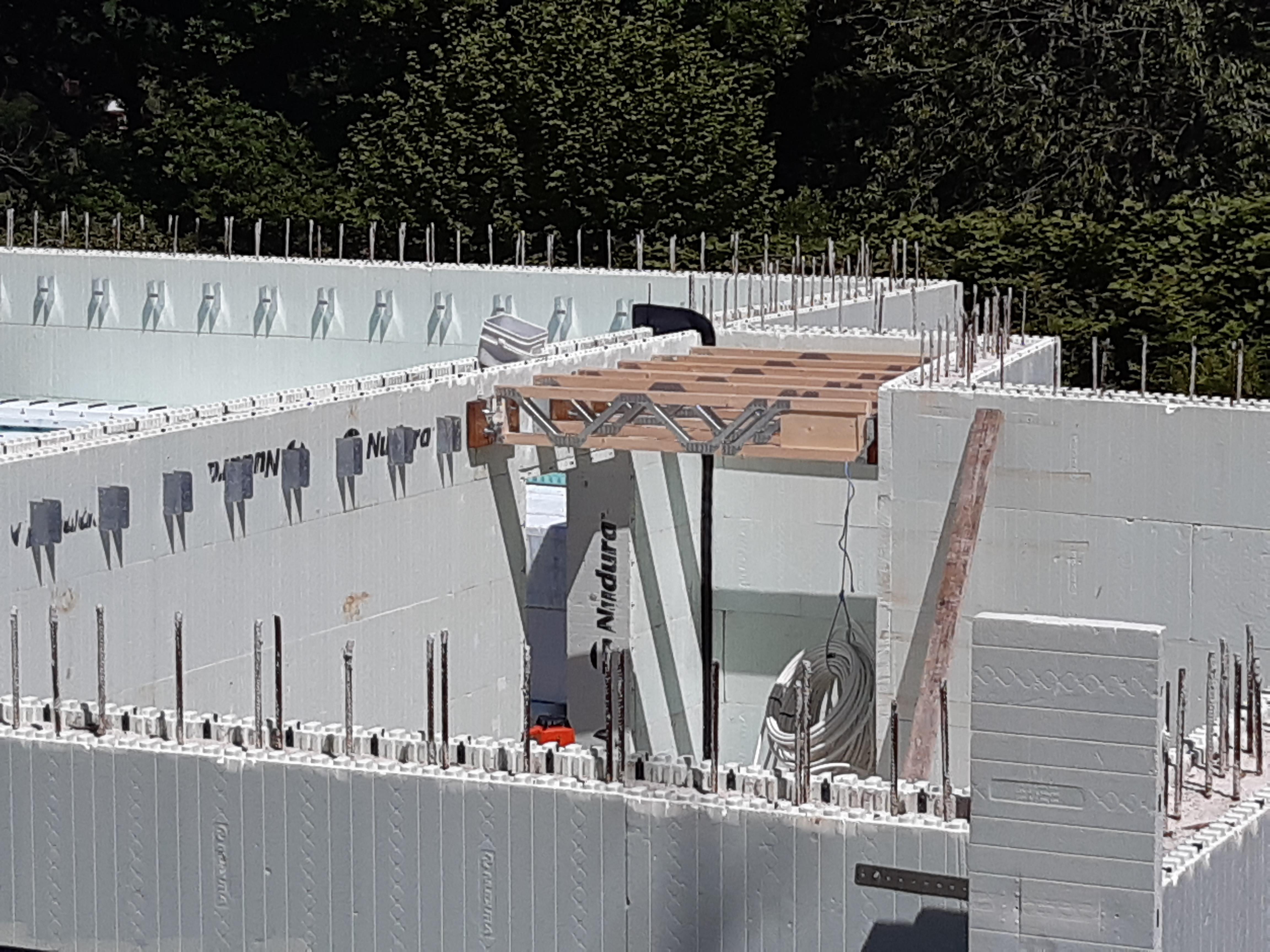

BotusBuild Posted October 16, 2023 Posted October 16, 2023 On 13/10/2023 at 09:51, Mulberry View said: What is the best way to hang these joists in a Nudura build? Use Nudura joist hangers where you can (see pics after YT link) - https://www.nudura.com/media/1913/nuduraicf_monotruss_hanger_system.pdf In the left hand picture you'll see some pieces of wood bolted into the concrete after as the Nudura joist hangers could not be inserted prior to the pour. . 1

FM2015 Posted October 17, 2023 Posted October 17, 2023 On 16/10/2023 at 17:19, BotusBuild said: Use Nudura joist hangers where you can (see pics after YT link) - https://www.nudura.com/media/1913/nuduraicf_monotruss_hanger_system.pdf In the left hand picture you'll see some pieces of wood bolted into the concrete after as the Nudura joist hangers could not be inserted prior to the pour. . Why didn't you use the Nudura retrofit brackets?

Mulberry View Posted October 18, 2023 Author Posted October 18, 2023 On 17/10/2023 at 18:44, FM2015 said: Why didn't you use the Nudura retrofit brackets? They just don't inspire me with confidence of a strong, bounce-free floor the same as hanging the joists directly onto a Ledger (Rimboard).

BotusBuild Posted October 19, 2023 Posted October 19, 2023 On 17/10/2023 at 18:44, FM2015 said: Why didn't you use the Nudura retrofit brackets? Wasn't aware they existed at the time 😞 1
