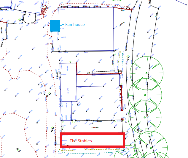

readiescards Posted September 3, 2017 Share Posted September 3, 2017 So the next project is on the cards - currently in planning - a barn conversion on the family farm for holiday letting. 3 bedroom, 120 m2 However it is 'ear-shot' of our wheat and barley storage sheds: https://youtu.be/H3GRG7_M9uw Any suggestions on how to muffle a large fan? (Only runs later August and early September) Link to comment Share on other sites More sharing options...
PeterW Posted September 3, 2017 Share Posted September 3, 2017 A wall ...... daft as it sounds you need to direct that noise upwards..! Baffles on the front of the shed will help as will ducting the inlet. Got a site layout plan ..? 1 Link to comment Share on other sites More sharing options...
readiescards Posted September 3, 2017 Author Share Posted September 3, 2017 21 minutes ago, PeterW said: Got a site layout plan ..? https://www.dropbox.com/s/zuyg4uc8oy7m83a/LDC1838-04 Block Plans A3.pdf?dl=0 Link to comment Share on other sites More sharing options...
PeterW Posted September 3, 2017 Share Posted September 3, 2017 Is the dryer on the top building on that plan ..?? Link to comment Share on other sites More sharing options...
readiescards Posted September 4, 2017 Author Share Posted September 4, 2017 Yes, see attached A wall could be possible but it would need to be at the edge of shed - approx 8 metres from the fan entrance - would that still help? Baffles on the front of the fan house: what might they look like? Link to comment Share on other sites More sharing options...

PeterW Posted September 4, 2017 Share Posted September 4, 2017 7 minutes ago, readiescards said: Yes, see attached A wall could be possible but it would need to be at the edge of shed - approx 8 metres from the fan entrance - would that still help? Baffles on the front of the fan house: what might they look like? So you're getting noise from the open door and the blower cage - you need a way of : - Ducting the air into the fan from a baffled source - stopping noise being transmitted across the yard. First one could be as simple as blocking the doorway up and using some big galvanised square ducting to go up and over the fan house roof. Square duct is easier to cover with foam or fibre to also muffle the sound. Second thing is to build a fairly heavy wall about 6ft from the fan house to deflect the noise back away from the house. Sometimes easier to get the pre-made acoustic panels they use on roadsides - you can work out where it works best then by moving it about. Its not a permanent noise source so you need to weigh up cost vs benefit anyway - decent sound insulation in the house would be a good start ! 1 Link to comment Share on other sites More sharing options...

readiescards Posted December 18, 2019 Author Share Posted December 18, 2019 Well back on with this sound issue,. we've built the Stables holiday cottage and installed triple glazing. Inside the property with all the windows and doors shut the noise from the dryer is difficult to hear ? But it being late summer when the fan is used the guests often want to have the doors and windows open and be outside on the garden bench. Unfortantely one family were unlucky and suffered with the fan running flat out every day from 8 to 10pm (we were very lucky to get the harvest in before the heavy rain and so needed to use the fan to cool the grain) and I fully understood when they complained so I switched the fan off at 4pm when they returned from visiting but is not going to be always possible. I did look at building a wall of straw bales about 10m from the fan intake but by the time the straw had been baled the grain was cool enough not to need airing. I've asked the company who re-wind the motor in 2011 if they can advise why it is so loud. A metal square channel so the air is sucked in from the opposite side to the holiday as suggested might work but that would deflect the noise to a couple of other residences (one of them being my house!) Lourved vents I'll investigate. One question I have is: Would spray foaming the inside of the fan house help to absorb the sound - the fan house is probably 10ft square, mainly brick with absetos sheeting type roof. I wondered if spray all those hard surfaces would absorb some sound before it is reflected internal? Link to comment Share on other sites More sharing options...

Moonshine Posted December 18, 2019 Share Posted December 18, 2019 (edited) 1 hour ago, SteamyTea said: O.k, probably something I can help with.... - Have you got any pictures of inside the fan room? - any pictures of the space between the fan room and housem - do the residents complain about the noise in all rooms of the house, or just a couple? - how is the fan room ventilated? - do you know the make model of the dryer? - what is the construction of the fan room and door? Edit: just watched the video, that is loud! Is it the same now as then? Edited December 18, 2019 by Moonshine 1 Link to comment Share on other sites More sharing options...

dpmiller Posted December 18, 2019 Share Posted December 18, 2019 piccies would help. is there line-of-sight in through either outlets or inlets to the fan/fan room? Ensuring there's no straight-line for the sound to travel on is a good start, a foam lined baffle of some kind would work for this A dodgy fan would certainly need addressing beyond this, yes, absorbant lining of the fan house (especially with proper mass-loaded stuff) would be next... 1 Link to comment Share on other sites More sharing options...
