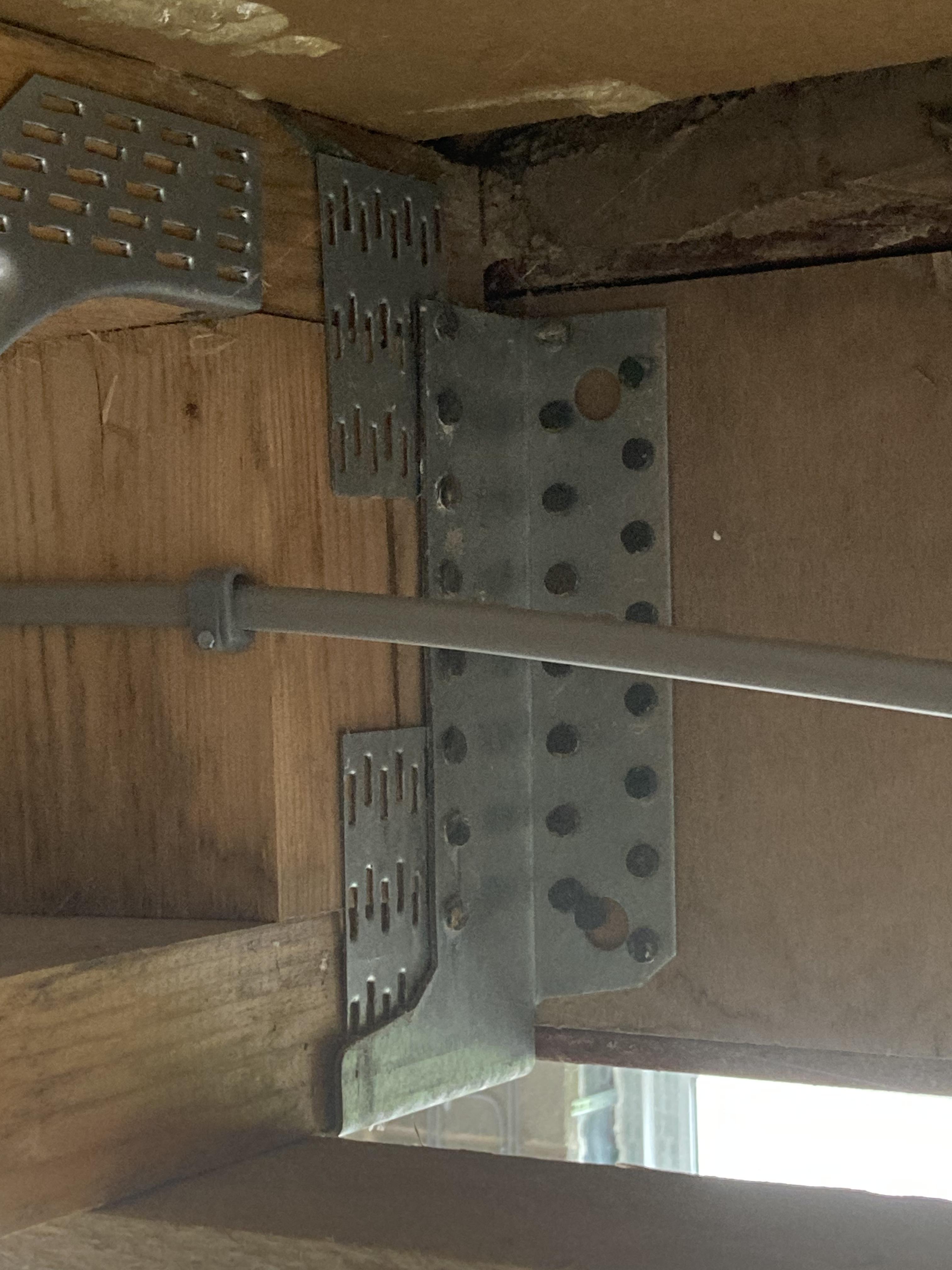

Canski Posted October 8, 2023 Share Posted October 8, 2023 Morning all. My joists are going on this weekend but I noticed an issue with the hanger connection to the steel. The Chippy suggested getting some 12 mm ply to pack out the plate to the edge of the flange so I supplied some. Then I turn my back and he has fixed it to the front. Even so the face of the ply is still short of the flange. Then the hangers go on and there is no chance of fixing through the vertical nail holes. We have had a conversation about this and I am insisting that the other house is changed to pack out the plate to suit the joist length but I am left with the first house like this. The Chippy is insisting that Posi joists don’t need to be nailed vertically. What are others thoughts on this ? Link to comment Share on other sites More sharing options...
nod Posted October 8, 2023 Share Posted October 8, 2023 (edited) That is really poor BC will pick that up I went out and bought a dozen deeper hangers for the two deep steels He also should trim the ends off Or add a block the Posi so that they sit plush With so few nails it a quick easy job to alter at this stage Edited October 8, 2023 by nod 1 Link to comment Share on other sites More sharing options...

nod Posted October 8, 2023 Share Posted October 8, 2023 Not good Nailing right on the end won’t hold much I’ll snap a picture of the ones I’ve done Link to comment Share on other sites More sharing options...

Big Jimbo Posted October 8, 2023 Share Posted October 8, 2023 The wood within the web of the steel is simply not deep enough. It should be at least as deep as the web, and in an ideal world, extend a few mm beyond. The joist at 90 degrees would then be fully supported in the joist hanger. Don't accept that crap work under any circumstances. If the wood in the web is not deep enough, and needs a packer to bring it out clear of the steel, ply would be fine, but I would expect it to be glued and screwed onto the timber behind, and specified by a structural engineer. No problem using packers, but they have to be done correctly. 1 Link to comment Share on other sites More sharing options...
markc Posted October 8, 2023 Share Posted October 8, 2023 Packing out behind hangers is not acceptable. Timber in the web should have been packed out or doubled to bring the face out flush with the flange or to meet the end of the posi if needed. 2 Link to comment Share on other sites More sharing options...

Canski Posted October 8, 2023 Author Share Posted October 8, 2023 The next solution offered is to prop the joists and remove the hangers then loosen all of the bolts and then slide another 2 Nr 12.5 mm ply strips behind the plate (one above the steel bolts and one below) then retighten the bolts. This would put the plate back in the position it should have been. 14 minutes ago, ProDave said: And isn't the top chord of the posi joist supposed to extend further and rest on the top of the steel? Not according to the joist plans. FF Joists- Posi-Joist Floor Layout - REV. E.pdf Link to comment Share on other sites More sharing options...

nod Posted October 8, 2023 Share Posted October 8, 2023 30 minutes ago, nod said: Not good Nailing right on the end won’t hold much I’ll snap a picture of the ones I’ve done 1 1 Link to comment Share on other sites More sharing options...
Canski Posted October 8, 2023 Author Share Posted October 8, 2023 13 minutes ago, markc said: Packing out behind hangers is not acceptable. Timber in the web should have been packed out or doubled to bring the face out flush with the flange or to meet the end of the posi if needed. I agree. If it had been me I would have put the steels in position and measured the pozi joist then packed the timbers to suit. Then again I am just a bricky and not qualified to think for the chippies.🤔 1 Link to comment Share on other sites More sharing options...
ProDave Posted October 8, 2023 Share Posted October 8, 2023 8 minutes ago, Canski said: The next solution offered is to prop the joists and remove the hangers then loosen all of the bolts and then slide another 2 Nr 12.5 mm ply strips behind the plate (one above the steel bolts and one below) then retighten the bolts. This would put the plate back in the position it should have been. Not according to the joist plans. FF Joists- Posi-Joist Floor Layout - REV. E.pdf 282.72 kB · 0 downloads Then the joist detail of PS1 does not look right to me. the end hanging on the hanger off the steel I would expect the solid timber between top and bottom chord to go tight to the end not recessed as the plans show it. And agree with others it is the infill timber on the steel joist that is wrong. I am also very uneasy about a hanger that does not wrap over the top of the timber it is hanging from. 1 Link to comment Share on other sites More sharing options...

Canski Posted October 8, 2023 Author Share Posted October 8, 2023 5 minutes ago, ProDave said: 6 minutes ago, ProDave said: Then the joist detail of PS1 does not look right to me. the end hanging on the hanger off the steel I would expect the solid timber between top and bottom chord to go tight to the end not recessed as the plans show it. I agree. Seems like a poor design that I overlooked. 7 minutes ago, ProDave said: And agree with others it is the infill timber on the steel joist that is wrong. Yep this is where the main problem lies 8 minutes ago, ProDave said: I am also very uneasy about a hanger that does not wrap over the top of the timber it is hanging from. Its not really possible when the steel is tight in the web Link to comment Share on other sites More sharing options...

Canski Posted October 8, 2023 Author Share Posted October 8, 2023 1 minute ago, Big Jimbo said: To be fair to the chippie. He is booked to do a job. Turns up, and this is the position he is in. He has tried to get over it, but just badly. It would have been better if he had said, mate that timber in the web ain't deep enough. We are going to have to sort that before we start hanging joists. Yep it seems like that but .... I had sent hime the joist drawings 2 weeks ago and also the sizes of the web of the steels. This is where he noted that the timbers would need packing out and suggested 12.5 mm ply to do this. He said he was going to place the ply behind the timber which seemed fine to me providing it was the full height of the timber. Then I turned my back ! 2 Link to comment Share on other sites More sharing options...
ProDave Posted October 8, 2023 Share Posted October 8, 2023 6 minutes ago, Canski said: Yep it seems like that but .... I had sent hime the joist drawings 2 weeks ago and also the sizes of the web of the steels. This is where he noted that the timbers would need packing out and suggested 12.5 mm ply to do this. He said he was going to place the ply behind the timber which seemed fine to me providing it was the full height of the timber. Then I turned my back ! So I would not be paying him yet and telling him to come back and re do the job as you both agreed with the packing behind the timber in the joist and the additional work is at his expense. 1 Link to comment Share on other sites More sharing options...
Canski Posted October 8, 2023 Author Share Posted October 8, 2023 23 minutes ago, ProDave said: So I would not be paying him yet and telling him to come back and re do the job as you both agreed with the packing behind the timber in the joist and the additional work is at his expense. That's what they are doing now. Thanks all for your comments. Sometimes its good to get a bit of confirmation to your thoughts. 1 Link to comment Share on other sites More sharing options...

Canski Posted October 8, 2023 Author Share Posted October 8, 2023 2 hours ago, ProDave said: Thanks. I am sure we would all love to see the pictures when re worked. 3 1 Link to comment Share on other sites More sharing options...
ProDave Posted October 8, 2023 Share Posted October 8, 2023 That is looking a whole lot better. Link to comment Share on other sites More sharing options...
joe90 Posted October 8, 2023 Share Posted October 8, 2023 Soo much better and nails in every hole (which it should be) it’s a good job us build hubbers keep an eye on what the trades (who should know better) are doing. Link to comment Share on other sites More sharing options...
