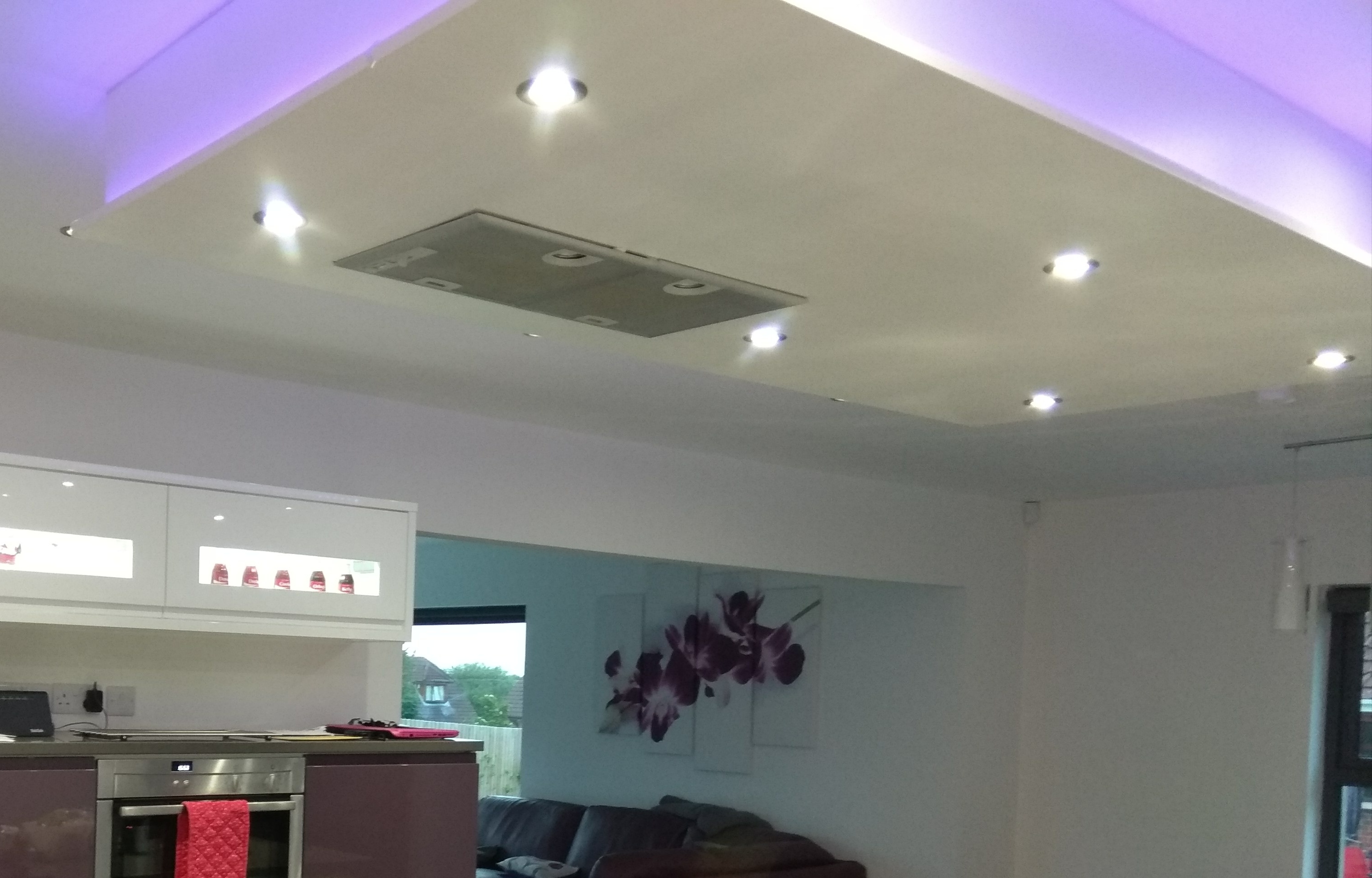

Declan52 Posted September 2, 2017 Share Posted September 2, 2017 I done a similar thing in my kitchen. It was just a sheet of 18mm MDF with a bit of stud to make a frame. Plenty of big screws to hold the studs to the underneath of the joists. I put some down lights in it to shine light on the island and a colour changing led strip around the edge. The extractor fan is just a normal type you would put in any built over type unit. All in including the fan it was approx £250. I have the fan wired into a switch on the wall so just gets turned on here. 3 Link to comment Share on other sites More sharing options...

stepheni Posted September 3, 2017 Author Share Posted September 3, 2017 Really appreciate the feedback guys. Unfortunately too late for ducting any of the downdraft type extractors as the floor slab and ufh is in with final screed being laid this week. I did consider these a few months ago but again discounted them due to cost and I suppose wrongly assumed a flat ceiling one wouldn't cost much, Declan - Whats the overall depth of the drop ceiling you have there. One of the kitchen designers suggested the same as you that putting a standard canopy extractor in works fine. I was concerned about the depth of the drop required as the extraction duct seems to sit on the top of the all of these type whereas the flat ceiling ones come out of the side. I only have standard 2400 ceilings so really wanted to keep the drop minimal. 1 Link to comment Share on other sites More sharing options...
PeterW Posted September 3, 2017 Share Posted September 3, 2017 I have an island with a 200mm drop ceiling over it as it also disguises the steel that was put in to allow the removal of a wall. As it's over the island you don't notice the drop anyway as you can't walk under it. Link to comment Share on other sites More sharing options...
Declan52 Posted September 3, 2017 Share Posted September 3, 2017 It is 300mm down. You could get away with more depth because the whole thing is white against a white ceiling so isn't very noticeable at all. Mine is out the top so in order to get it to fit I cut out a square in the gap between joists in my ceiling, I have attic truss but would work with any kind of joists. I put some 50mm insulation on the sides and top of the hole and to stop sound from going through to the room above. The duct comes out the top and then loops into the hole comes back down and then goes outside. Just make sure you buy a fan that is powerful enough. It's more important to take the steam away than be fancy looking. The flat ceiling fans I looked at where all up wards of £1k and the vertical type where even more expensive and I just couldn't justify paying more on a fan than I did on the hob, oven ,fridge and dishwasher combined. Google dropped ceilings and have a look as there are a lot of very nice looking ones. Any joiner worth his salt could make one very handy enough out of MDF. Link to comment Share on other sites More sharing options...

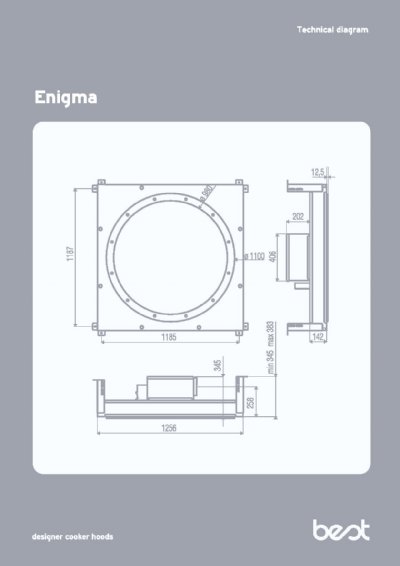

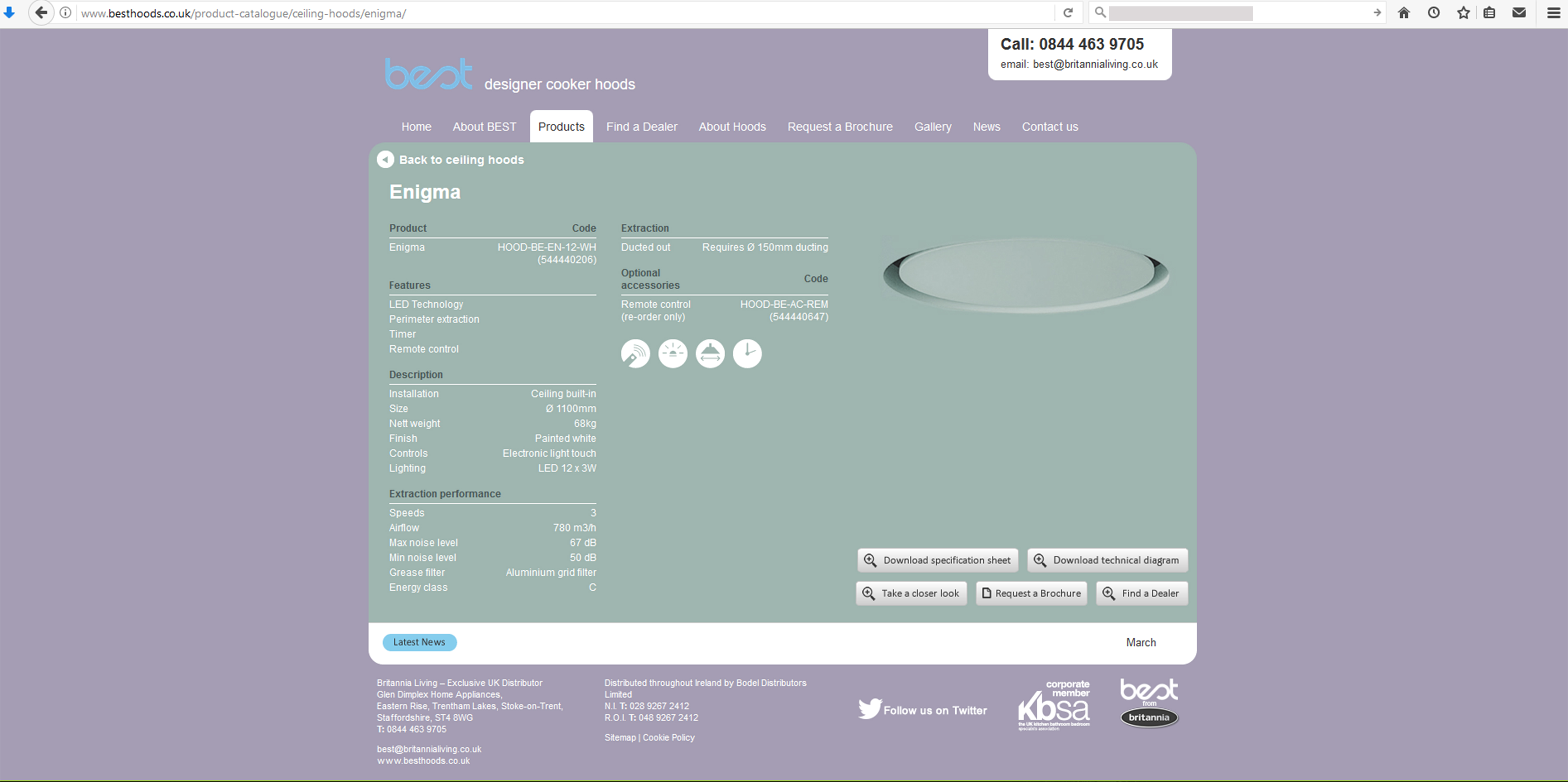

Plumbersmateuk Posted September 3, 2017 Share Posted September 3, 2017 Something like this? 1 Link to comment Share on other sites More sharing options...
Nickfromwales Posted September 3, 2017 Share Posted September 3, 2017 12 minutes ago, Plumbersmateuk said: Something like this? Now they do look cool. You could even have 2 of those and run them at lower speeds so extraction rates were high but noise was low. Good for those who like to cook and chat / entertain. Linky Link to comment Share on other sites More sharing options...
Declan52 Posted September 3, 2017 Share Posted September 3, 2017 It weighs 68kg that must be some unit. I will put the screws in while you hold it up @Nickfromwales. Link to comment Share on other sites More sharing options...
