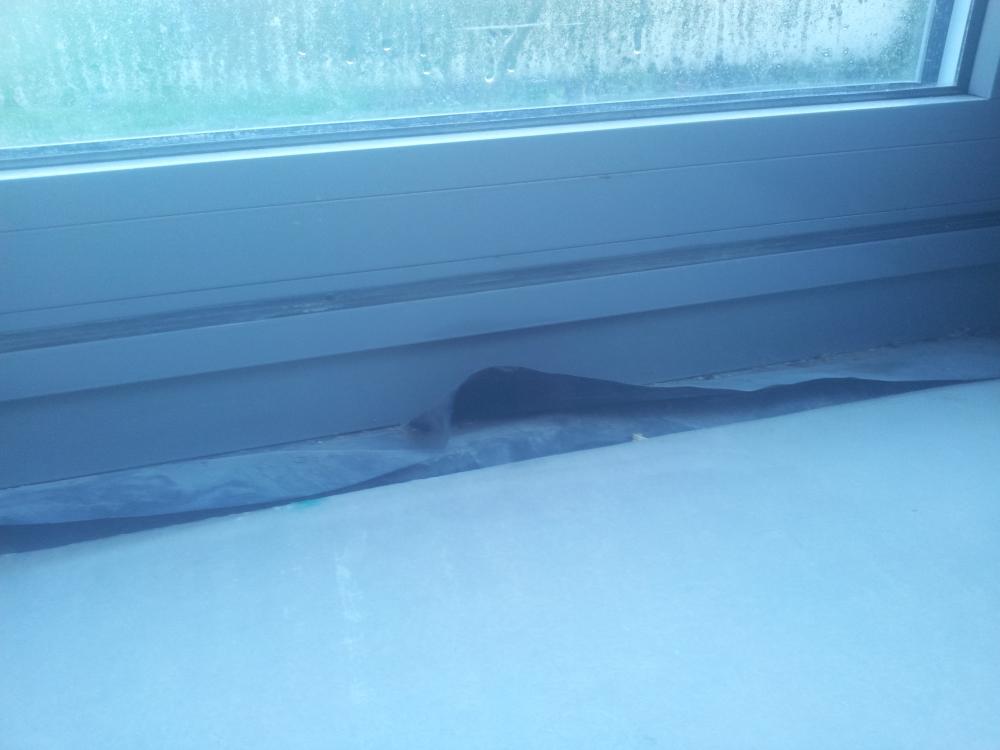

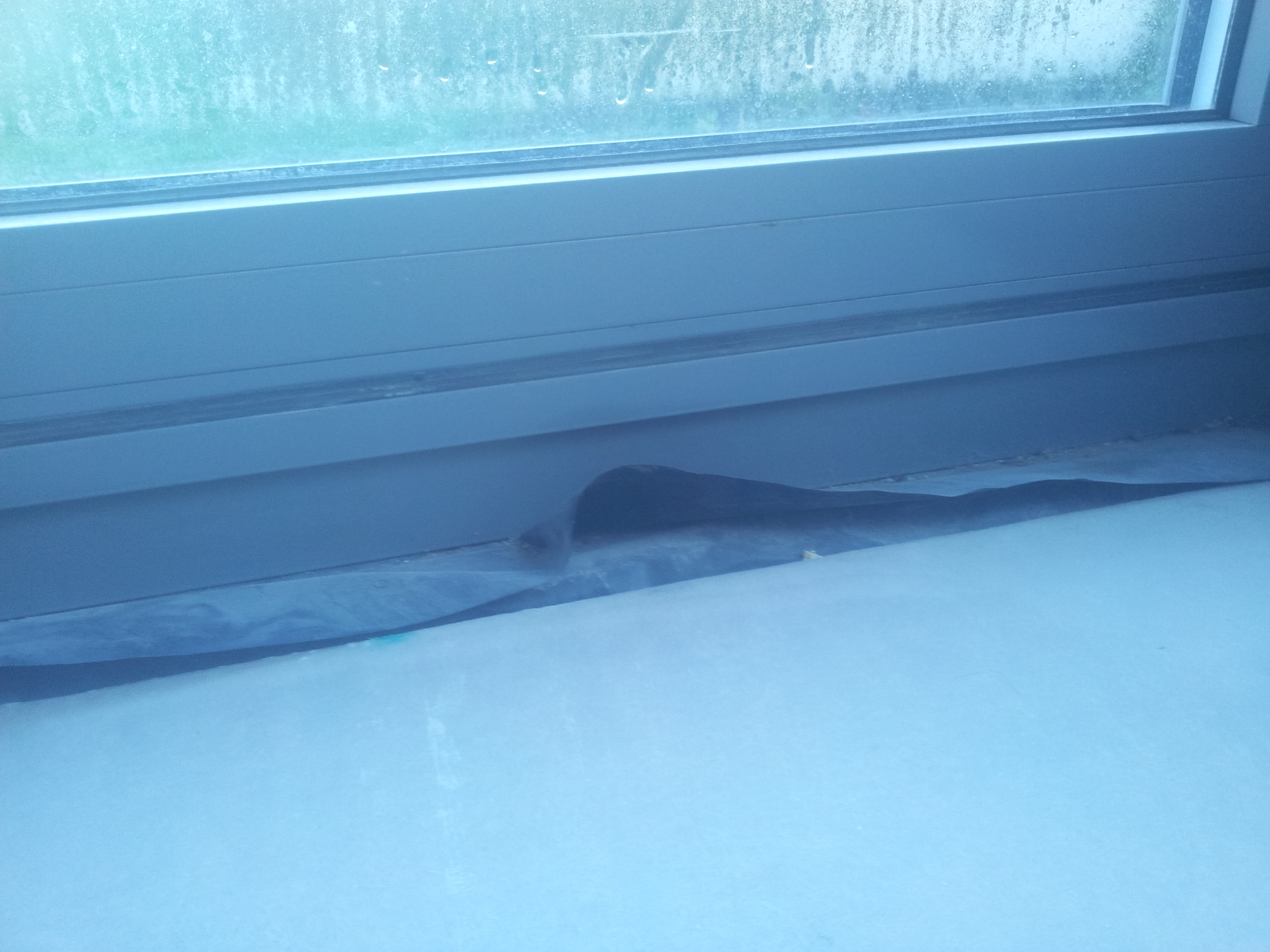

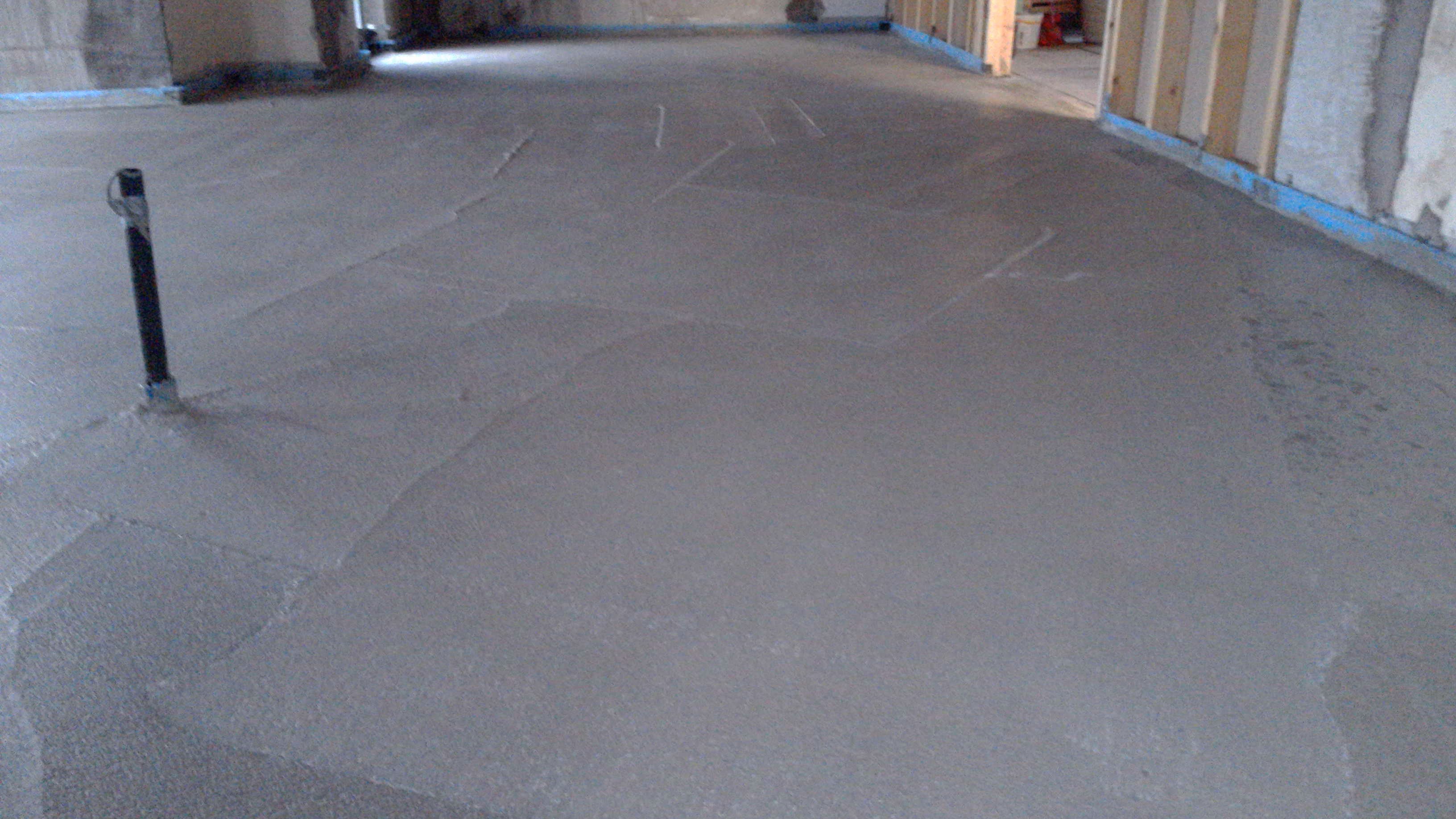

  2. I have uploaded a few pictures of the floor. Would you say that I am right to be disappointed with this. The builder is coming tomorrow morning to take a look so just wondering what I should be expecting from him as a resolution. After speaking to the karndean installers they say they would always be laying a 3-4mm screed anyway before laying floor but there is no way as far as I could tell that it would fix this floor. Do I ask him to grind/sand the ridges away and level of any bad areas (can this even be done) or should I just leave the levelling to the karndean installers. The karndean guy said the screed they use for levelling has latex in it and normally goes down after kitchen is installed. appreciate any further advice
  3. He has only done a couple of jobs for me and things have been fine until now. Haven't paid anything yet so onus on him to resolve. Just popped into the karndean place round the corner from my work to explain what has happened. He kind of laughed and said 100% of the jobs they do need the floor screeded no matter how smooth the builder says he has got the floor too. So it looks like I would have had to pay to get this done anyway about £6 m2. I still need to get the worst of the ridges sorted though.
  4. I figured they could just be cut off with grinder but would appreciate the builder just saying that after coming to take a look rather than having a go at me. Even if I was laying a carpet with thick underlay wouldn't hide these ridges!

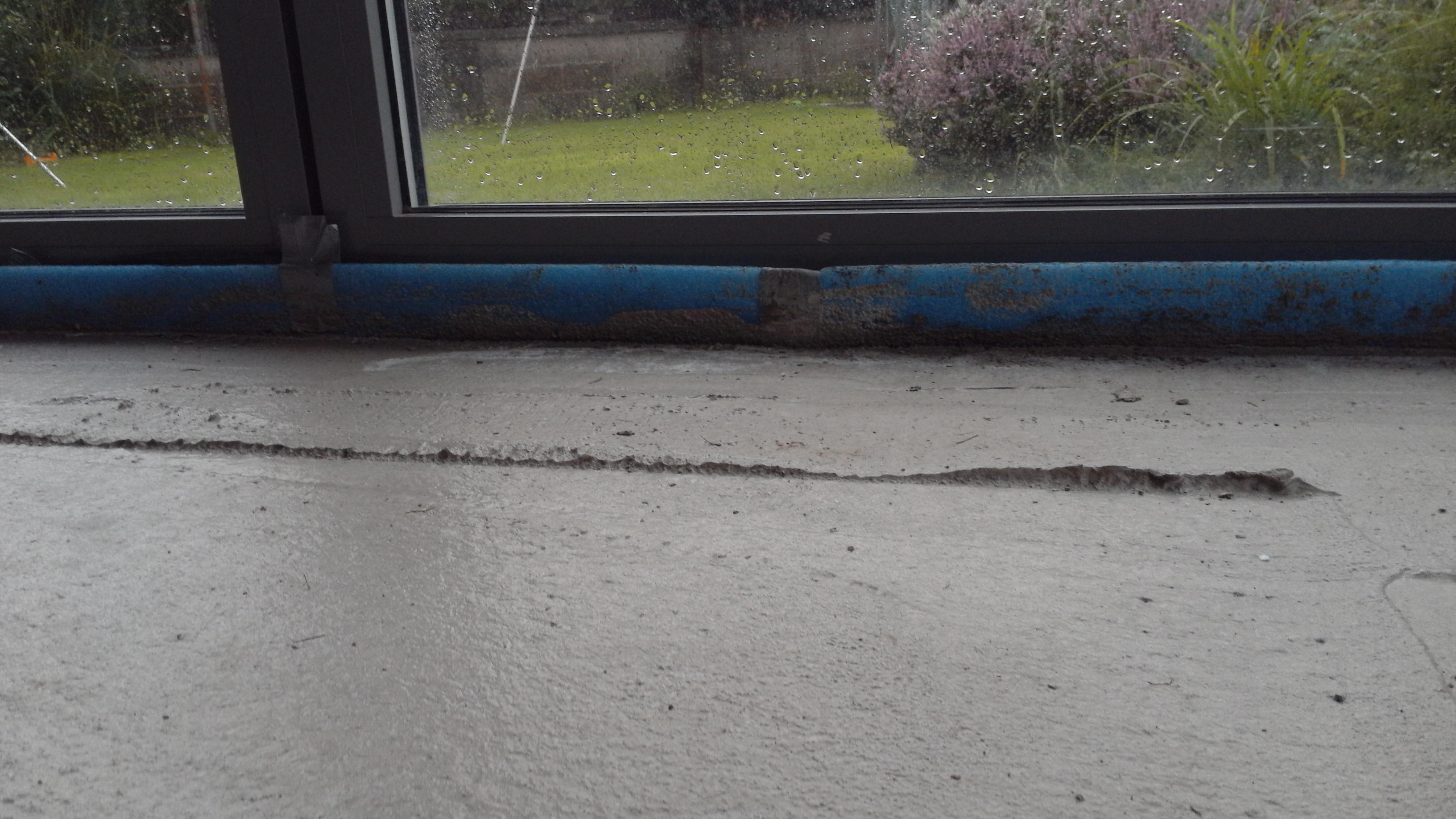

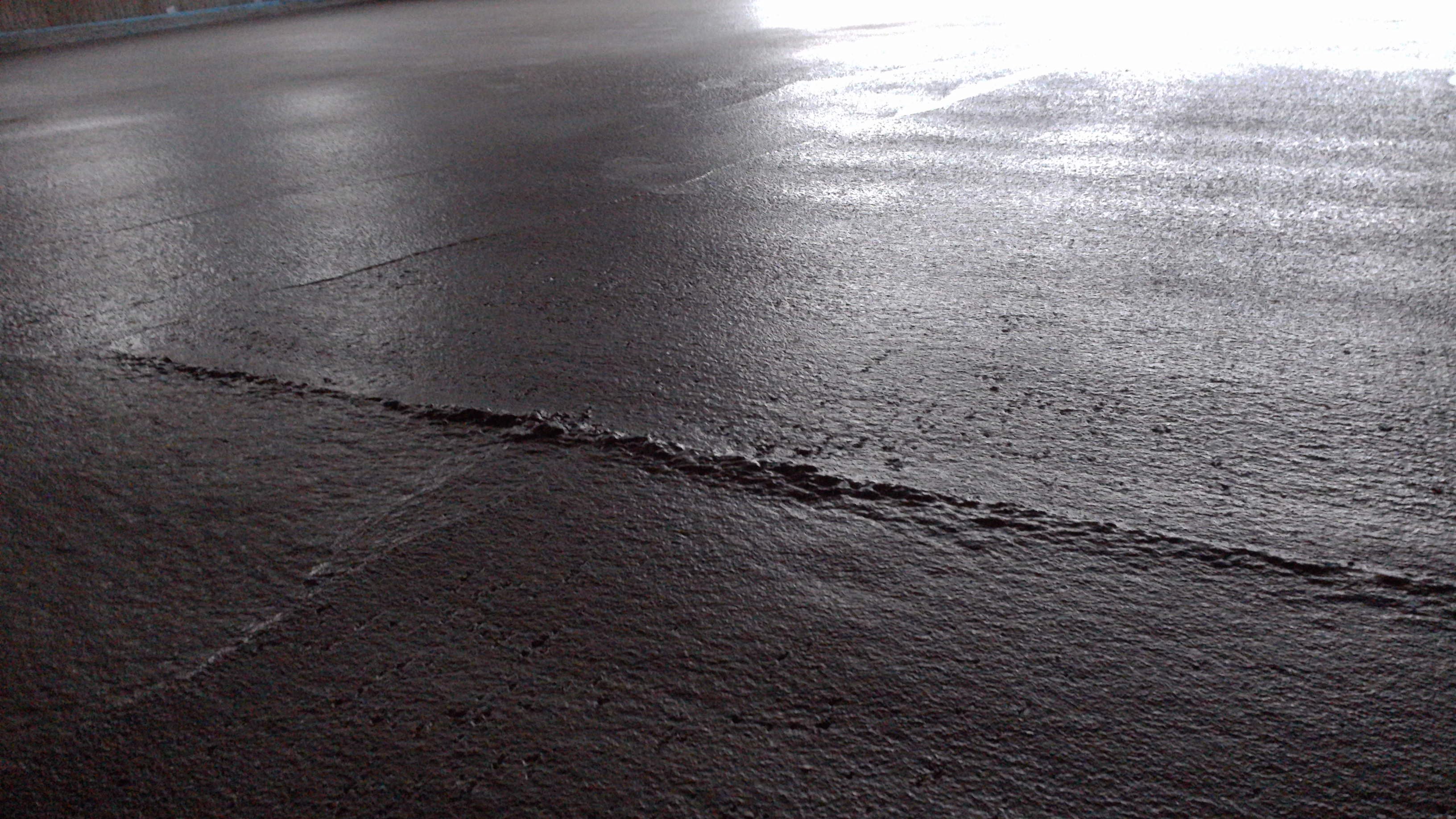

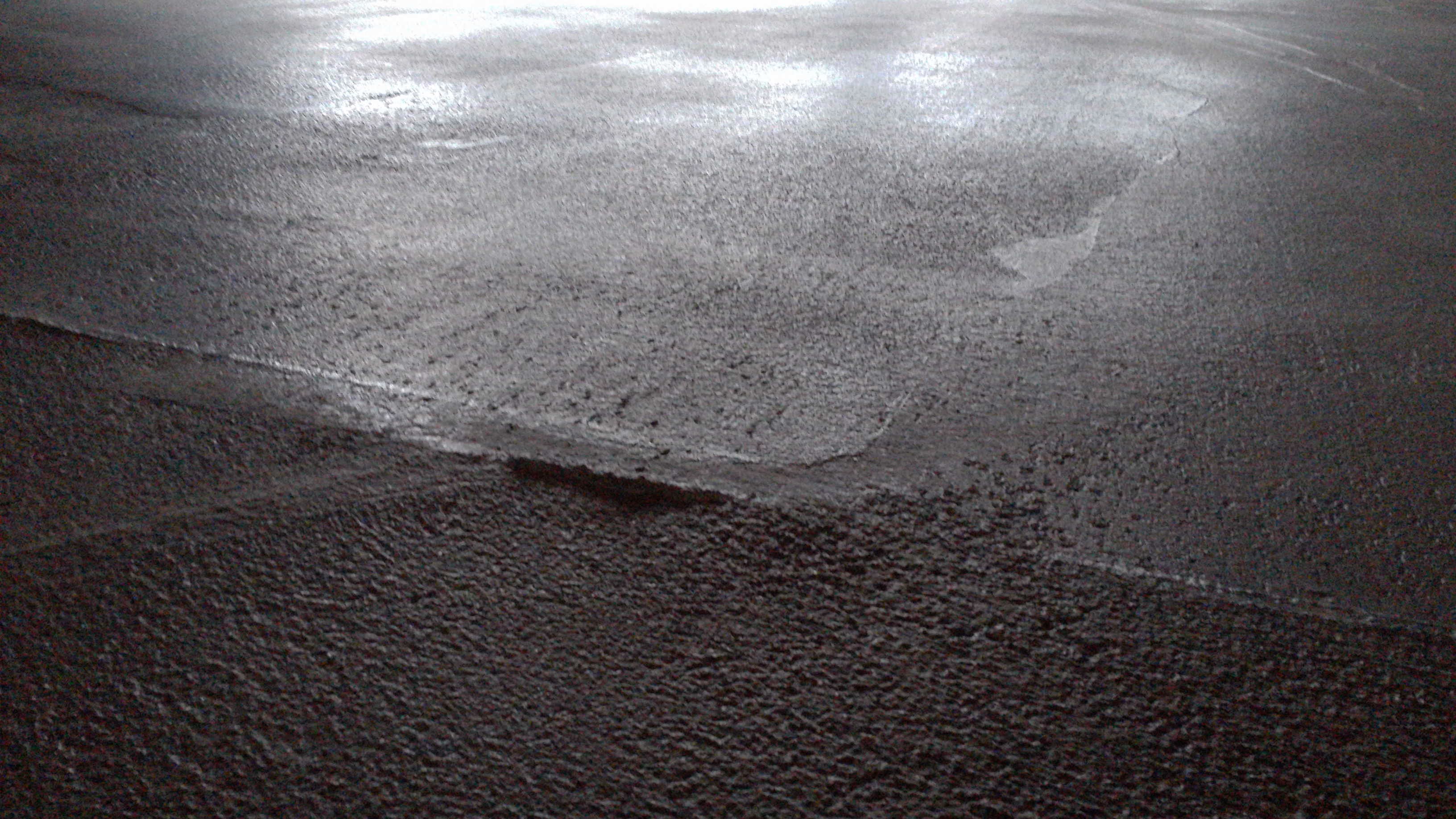

  5. wet concrete finished about 5pm last night. I haven't walked over it but standing at the door looking across I can see about 3 or 4 ridges about a metre or so long which are sticking up about 20mm. It is obviously where they have just lifted up the float and it has stuck to the floor a bit and created a ridge. Overall it looks pretty flat and they were using a laser its just these few ridges. The builder said on the phone that I was just "being difficult". He hasn't turned up and hasn't responded to text yet.
  6. I have just had my concrete screed laid yesterday for my ufh. I explained to the builder that it needed to be a smooth flat finish as I was just laying karndean directly to this. I was told this was no problem and that it would be perfect. Got home last night to see a far from perfect floor with a 3 or 4 long ridges protruding some 20mm. I have phoned the builder and he is supposed to be coming round this morning. What are my options here? Pretty disappointed.

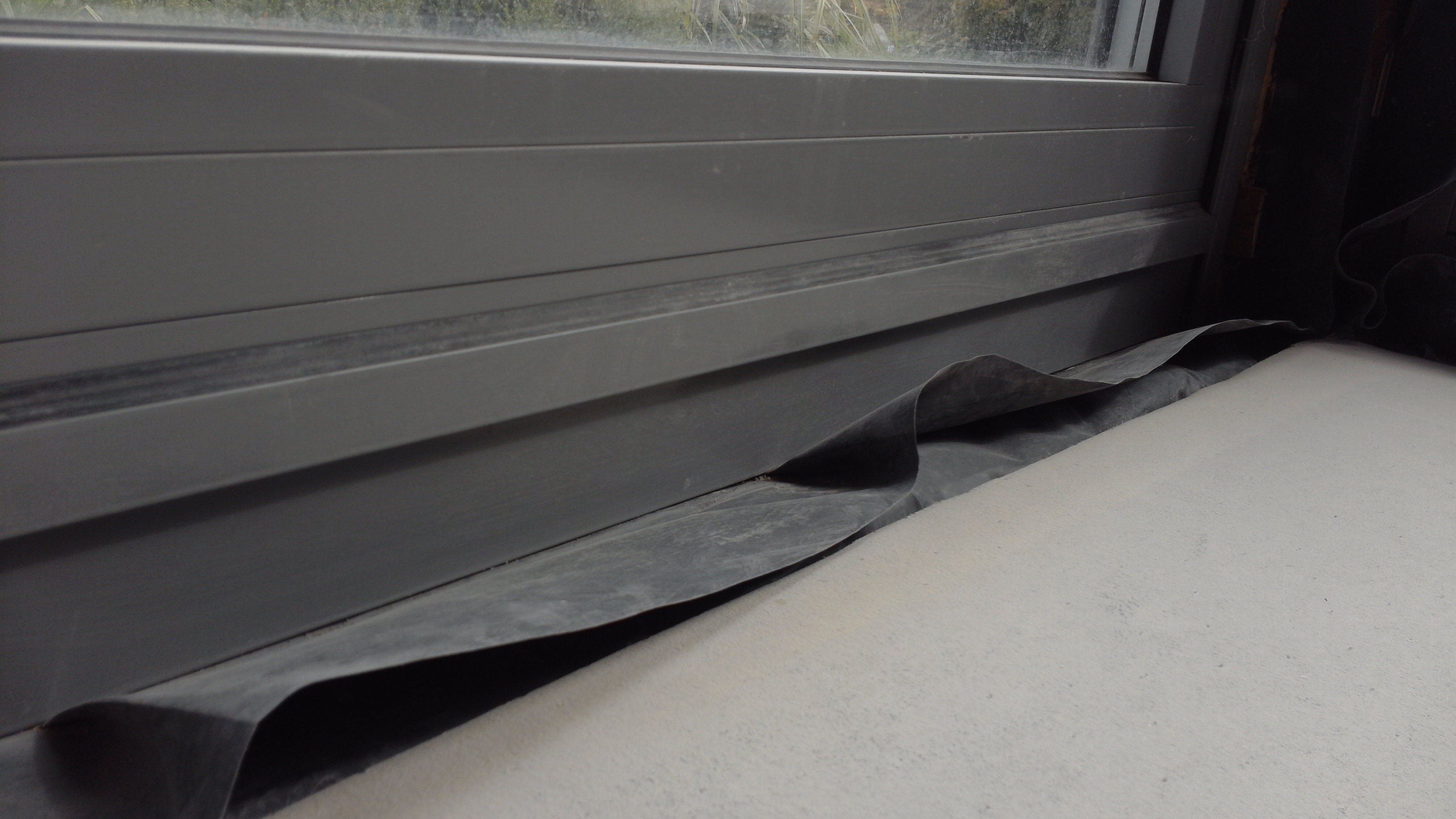

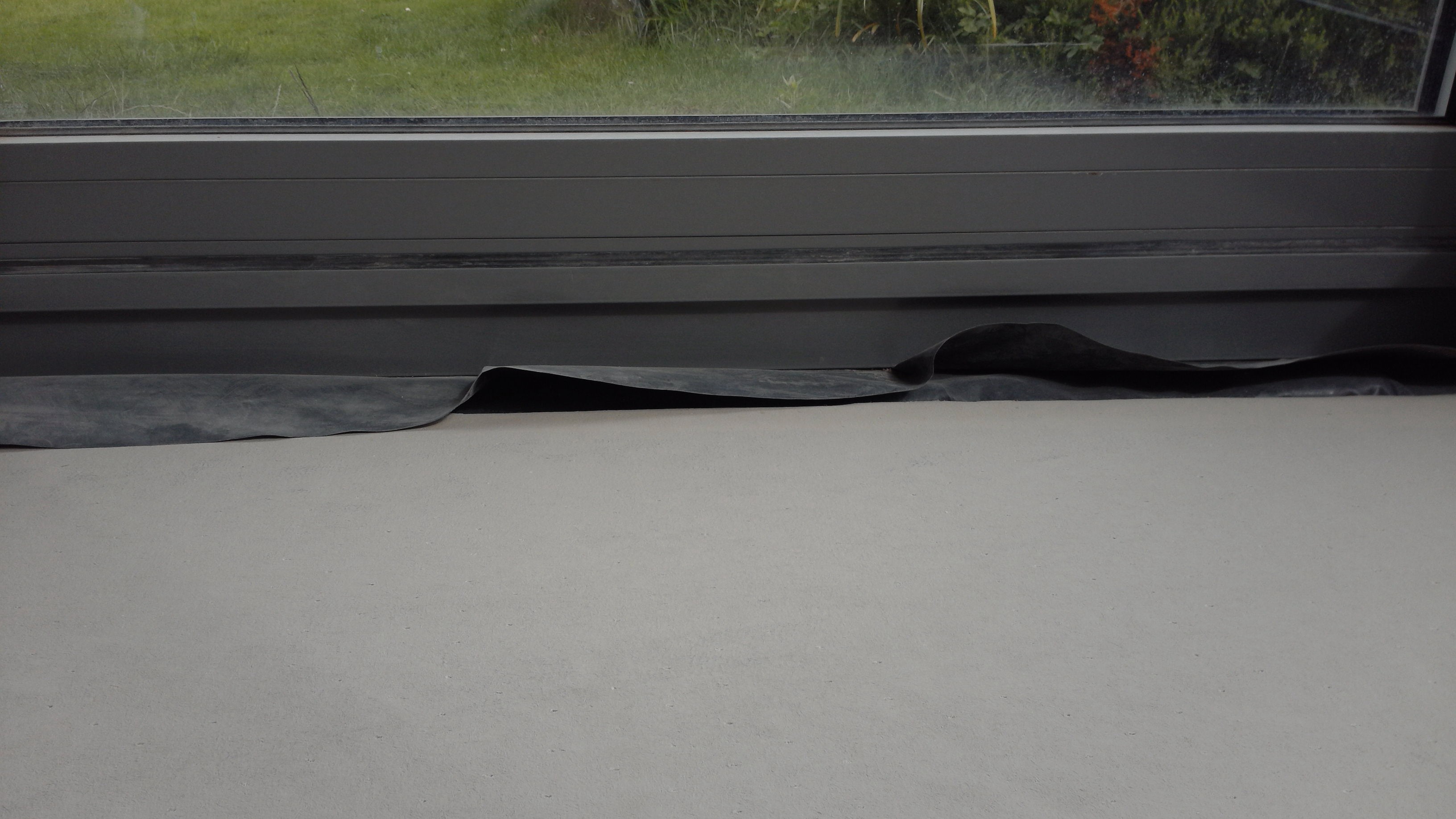

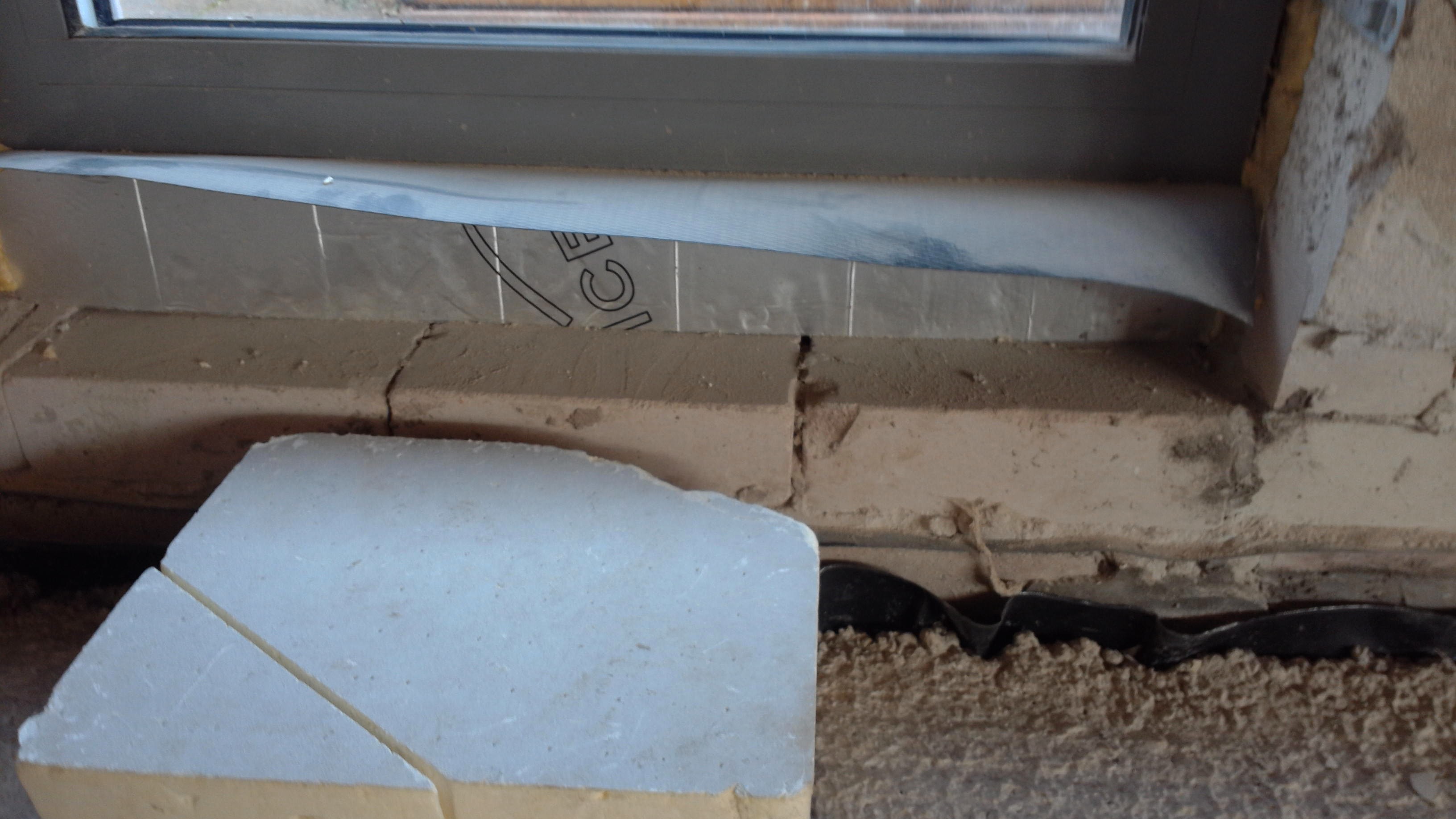

  11. This is picture of my floor to ceiling window where it meets the floor. I am about to lay the insulation boards for below the ufh(example board cut in photo) but I am unsure how to finish off this area from the floor across to the window. Should I just leave as is per photo and just run the concrete screed straight across from here to meet the cavity insulation board? Alternatively do I knock that last course of brick out and run the insulation right through to meet the cavity insulation therefore all ufh within the insulation. Also I am using paper backed insulation boards rather than foil with a standard concrete screed. Do I need to a plastic sheet over the top of this prior to screed going down or tape the joins? thanks Stephen

  15. I am soon to be laying my underfloor heating in my extension but have a couple of queries. Is it ok to use non-foil PIR insulation under the screed? I am sure I read on the celotex website that the foil was only necessary if there was an air gap behind the insulation. This would then be covered in polythene before pouring the screed See from picture that I have 75mm left from top of insulation. Was planning on a traditional sand/cement screed (65-70mm) then leaving 5-10mm for vinyl flooring (karndean or similar). Would this be ok or should I look at liquid screed? What do you do round the perimeter for UFH for insulation? Also if you see in the photo at the bottom of the doors there is a ridge how do you deal with this for the perimeter insulation
