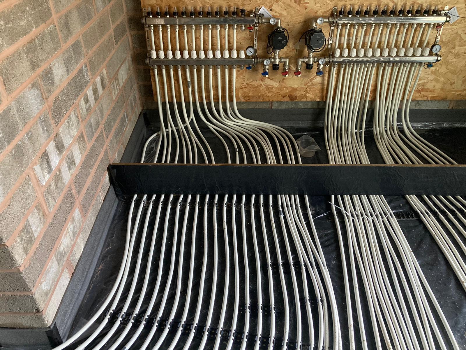

Tom Posted October 2, 2023 Posted October 2, 2023 I really need to get some heat in to our screed and I'm thinking a Willis could do the job. Is this doable for a keen DIYer? Here is the manifold as it is now (it's the one on the left I need to get heat through). Parts I'm guessing heater, expansion vessel, pump?, thermostat? Thanks all

Tom Posted October 2, 2023 Author Posted October 2, 2023 Hmmm, eleven loops, guess average about 80m each, so 880m. What's the internal bore of Wunda pipe? Lets say 14mm, so that makes about 135 litres - does that sound about right?

John Carroll Posted October 3, 2023 Posted October 3, 2023 22 hours ago, Tom said: I really need to get some heat in to our screed and I'm thinking a Willis could do the job. Is this doable for a keen DIYer? Here is the manifold as it is now (it's the one on the left I need to get heat through). Parts I'm guessing heater, expansion vessel, pump?, thermostat? Thanks all You left hand manifold has 11 loops, at a dT of 8C and a flowrate of say 2.5LPM will output 15.3kw so the willis at 3kw will do OK for initial heat up/drying out especially since you can set it's thermostat but hasn't a hope of supplying the required UFH output when drying out or whatever when completed.
joth Posted October 3, 2023 Posted October 3, 2023 2 hours ago, John Carroll said: hasn't a hope of supplying the required UFH output when drying out or whatever when completed. Tbf that really depends more on the expected heating load (heat loss) of the property. Just cus it has a huge emitter kW capacity does not necessarily mean it actually needs to use that much (Obviously if you want to regularly reheat the property from cold, or blast heat in in a short window of time e.g. E7 cheap rate, it's a different matter, but a single cobbled together Willis heater doesn't sound like this is the goal anyways)
John Carroll Posted October 3, 2023 Posted October 3, 2023 (edited) True, but generally the emitter would/should be matched however roughly to the expected heat loss, I think/hope the OP is only talking about the commissioning process, he is hardly going to oversize by a factor of ~ 5. Edited October 3, 2023 by John Carroll

Tom Posted October 5, 2023 Author Posted October 5, 2023 A few questions for those in the know if I can: - would I need a circulation pump in addition to the one already on the manifold? I guess so, given that only circulates water round the loops - could I run one 3kW willis off an extension lead and 13A plug? Thanks all
JohnMo Posted October 5, 2023 Posted October 5, 2023 38 minutes ago, Tom said: would I need a circulation pump in addition to the one already on the manifold? No, the one on the manifold will move the fluid around the loop 39 minutes ago, Tom said: could I run one 3kW willis off an extension lead and 13A plug? I wouldn't, not really suitable for 13A for a long period.
