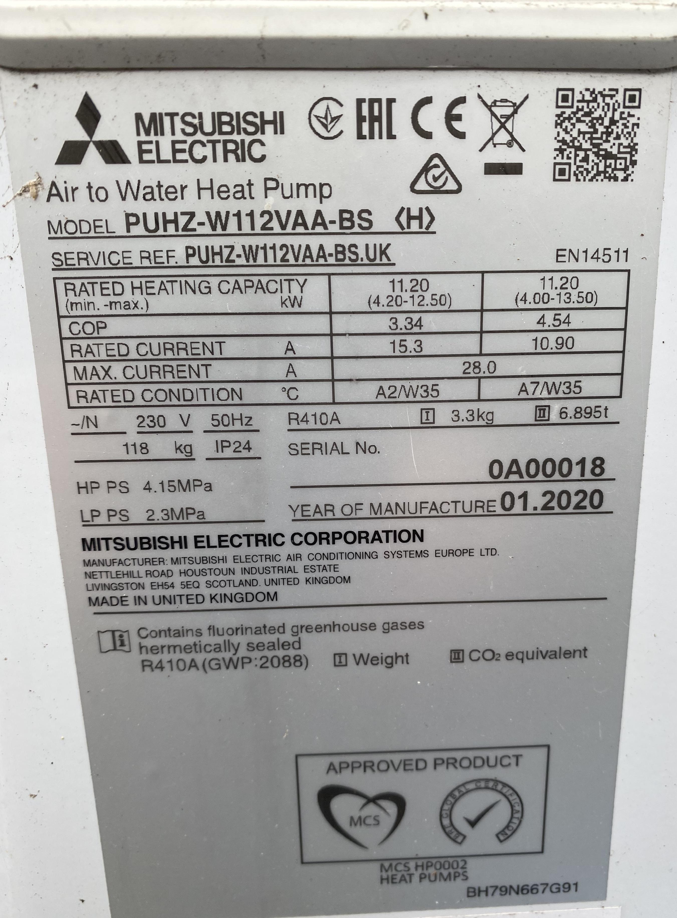

Bozza Posted September 29, 2023 Posted September 29, 2023 Currently my wee Draper / toolstation back up generator runs some essential basics during power cuts at my house. I’m looking at upgrading with a proper changeover switch and a bigger generator. There are plenty of guidance lists online with regards to the consumption of the usual domestic appliances, to allow me to estimate the correct capacity generator I require. The bit I need help with is - How is the best way to figure out the consumption of my ASHP, to see if it’s viable to have it running off a back up genny. Appreciate its consumption will relate to variable outdoor temperatures etc. I’m a bit of a biff when it comes to watts, kWh, and such calculations and can’t seem to get an answer anywhere else online. cheers Bozza

Bozza Posted September 29, 2023 Author Posted September 29, 2023 Thanks @joth have attached the label for the pump how do I interpret these numbers in relation to what you’re advising, it’s all gobledegook to my brain.

sharpener Posted September 29, 2023 Posted September 29, 2023 It looks as though the 28A starting current would need as a bare minimum a 6kW genny and as @markc says they are notoriously difficult to size correctly. Modern inverter based gennys are more economical at part-load but have all sorts of protection in them which may trip. Suggest you hire one for the weekend and if successful buy the exact same model. Does your HP have a quiet mode or night mode which might draw less current? Another old trick is to get a biggish induction motor and run that in parallel. Start that first with a star-delta starter, then its rotating mass will help supply the HP on startup. But this would require intervention every time and is not easy to automate. 2
