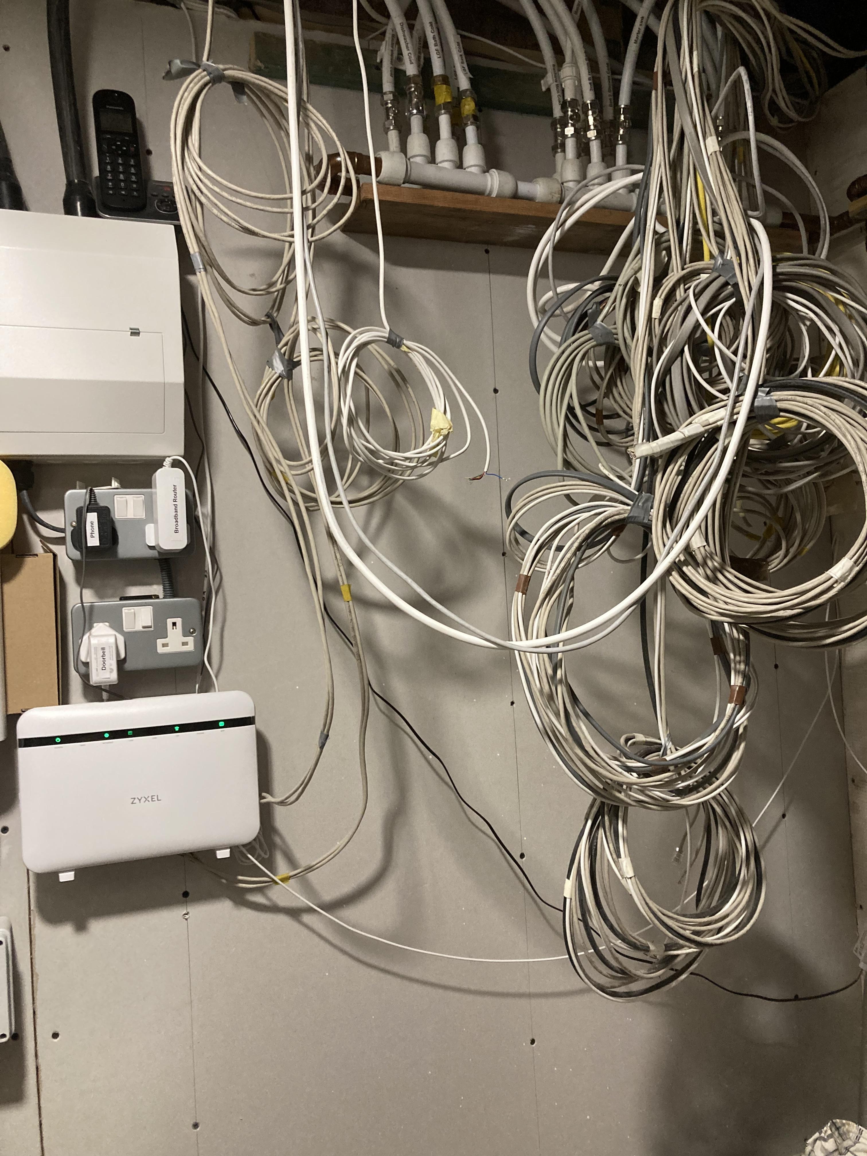

Triassic Posted September 23, 2023 Posted September 23, 2023 (edited) I have fibre gigabit broadband, lots of network cabling (CaT6 to every room) and wiring for 3 security cameras (CAT6 and a power supply), I also have meshed wifi. I have never installed network equipment before and was wondering if someone could advice what I need? To be honest, this is the last of the indoor jobs and I’ve been putting it off !!! Edited September 23, 2023 by Triassic
TonyT Posted September 23, 2023 Posted September 23, 2023 All depends you could buy a rack, patch panels etc , shelves for equipment etc spend loads you could also terminate cable ends into plugs and plug into switches. you could put sockets on the data points and then patch across, depends on you I suppose
Triassic Posted September 23, 2023 Author Posted September 23, 2023 I’m thinking of keeping it simple. At the moment I have 4 items plugged into the router, but I need about 4 more spare ways. I also have the 3 security cameras to install. Ideally I’d like a smart phone app type thing, so I can see what’s going on when away from home. I’d also like to extent the Wifi to an outbuilding, to which I have a CAT6 cable installed.
TonyT Posted September 23, 2023 Posted September 23, 2023 (edited) You could fit 2 double surface boxes and fit 8 data points to them, that will let you patch to switch etc Edited September 23, 2023 by TonyT
Triassic Posted September 23, 2023 Author Posted September 23, 2023 21 minutes ago, TonyT said: You could fit 2 double surface boxes and fit 8 data points to them, that will let you patch to switch etc Could you be specific, which boxes and which switch? Make, model etc. Is there a diagram of how it wall goes together?
TonyT Posted September 23, 2023 Posted September 23, 2023 Surface Double socket boxes with data points in these boxes you then buy a data switch which provides you with ports to then patch into your various data points
TonyT Posted September 23, 2023 Posted September 23, 2023 https://www.tlc-direct.co.uk/Products/VLXDQG4S.html https://www.tlc-direct.co.uk/Products/CXCAT6M.html https://www.amazon.co.uk/NETGEAR-Ethernet-Unmanaged-Internet-Splitter/dp/B07PWHGQSS/ref=mp_s_a_1_2_sspa?adgrpid=48674266290&hvadid=259224352990&hvdev=m&hvlocphy=9046861&hvnetw=g&hvqmt=e&hvrand=3073186192901928029&hvtargid=kwd-298720216058&hydadcr=11872_1766805&keywords=netgear+switch&qid=1695474144&sr=8-2-spons&sp_csd=d2lkZ2V0TmFtZT1zcF9waG9uZV9zZWFyY2hfYXRm&psc=1 so your router connect to the netgear switch with a patch cable. this then allows you to patch it to your various data points. 1
joth Posted September 23, 2023 Posted September 23, 2023 2 hours ago, Triassic said: I have fibre gigabit broadband, lots of network cabling (CaT6 to every room) and wiring for 3 security cameras (CAT6 and a power supply), I also have meshed wifi. I have never installed network equipment before and was wondering if someone could advice what I need? To be honest, this is the last of the indoor jobs and I’ve been putting it off !!! So how many data points total, and how many of them need PoE? Will you only ever want to use these for ethernet, or do you think there's any chance you'd want to repurpose any of the wire for other things like HDbaseT? (I expect the answer is no, else you'd be not asking this sort of question). Easiest thing is to select a network switch of the correct size and with sufficient PoE outlets, terminate all the cat6 in rj45 plugs and plug straight into the switch. Installing a patch panel before the switch makes sense if you think you might want to swap around what each data point is used for over time. Either way, you then plug the router LAN port into the switch and off you go. What meshed WiFi do you have? Do they need PoE?

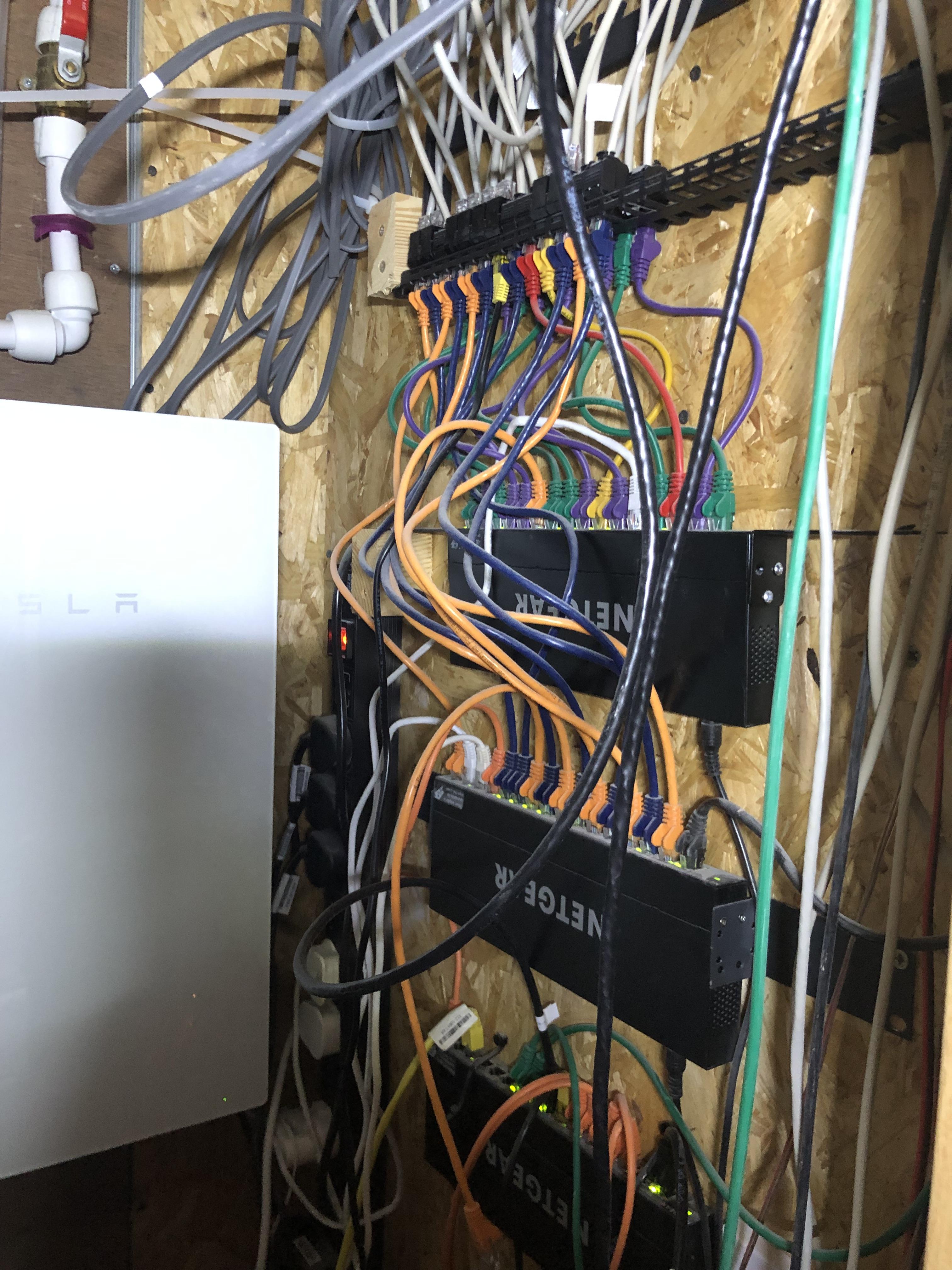

markharro Posted September 26, 2023 Posted September 26, 2023 Hi @Triassic your photo mirrors my situation right now. Lots of CAT6 cable in the plant room waiting to be connected up. For me its for internet to rooms/TV/wifi points/doorbell and some PoE cameras and lots of other misc stuff. I have bought a wall mounted 12U rack and am now trying to work out what to buy to fit in the rack and connect everything to. I have decided to use Ubiquiti kit so atm I am thinking do I use there (cheapish) Dream Router and try and deal with the compromises or pay more for the Dream machine pro (the video recording on this being useful). So far so good. Whichever of these I go for I need another device(s) to connect all the CAT6 cables to to distribute the signal to the network. I think I need the "switch" @joth mentions with enough capacity for all the wiring and PoE (with enough total wattage to power all the PoE things to be connected). If so I think I then connect RJ45 plugs to the CAT6 and basically plug these in the front of the switch and then plug the CAT6 from the router to the switch as @joth sets out? What I don't really understand though @joth is where the "pntch panel" fits into the equation? What is its function and how does it integrate with the router and switch? Finally the Ubiquiti switches seem to cost a fortune. Am I correct in thinking that any switch will work in a Ubiquiti system......it would just mean that you would lose the fancy functionality you get with the Ubiquiti interface?
PNAmble Posted September 26, 2023 Posted September 26, 2023 2 minutes ago, markharro said: Am I correct in thinking that any switch will work in a Ubiquiti system......it would just mean that you would lose the fancy functionality you get with the Ubiquiti interface? Yes. They just become ‘dumb’ which may not be an issue. I use Ubiquiti, for my security server and Poe switches. If I need to extend my none Poe network i use cheaper switches. I’d avoid mesh and use POE access points in the wall or ceiling personally.
markharro Posted September 26, 2023 Posted September 26, 2023 1 minute ago, PNAmble said: I use Ubiquiti, for my security server and Poe switches. If I need to extend my none Poe network i use cheaper switches. Thanks @PNAmble so maybe if I work out the total number of PoE outlets I will have get a Ubiquiti switch to cover these and another brand for all the non PoE stuff? For the latter is it an "unmanaged" switch I need? For the non PoE I will probably need at least 24 sockets - can you recommend anything cost effective for that?
PNAmble Posted September 26, 2023 Posted September 26, 2023 24 minutes ago, markharro said: Thanks @PNAmble so maybe if I work out the total number of PoE outlets I will have get a Ubiquiti switch to cover these and another brand for all the non PoE stuff? For the latter is it an "unmanaged" switch I need? For the non PoE I will probably need at least 24 sockets - can you recommend anything cost effective for that? Something like this will work perfectly fine https://www.cablemonkey.co.uk/switches/3296-netgear-24-port-gigabit-rack-mountable-network-switch.html?gad=1&gclid=CjwKCAjwgsqoBhBNEiwAwe5w0xk6VOuAfOVozqY4FmUmQ-jZ_fztsQ4rYIq3JBdI6k4hn5Tq9IKRnhoC3nMQAvD_BwE. but lots of other different options. It depends how many POE ports you need and other ports ... you could just get a single switch which does both something like this https://www.4gon.co.uk/ubiquiti-unifi-48port-poe-switch-usw48poe-p-9283.html does 32 POE the rest not. There is no problem running none poe stuff via a PoE Switch hence it reduces the number of components. btw a patch panel is just something that terminates all the cables at the cabinet, and then allows you to "patch" into the switches using a small patch cable. it adds flexibility and neatness to the solution.

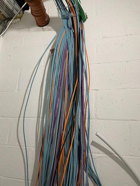

Thorfun Posted September 26, 2023 Posted September 26, 2023 7 hours ago, markharro said: your photo mirrors my situation right now. Lots of CAT6 cable in the plant room waiting to be connected up here's mine! and that's not including the the Green Cat6A for the Loxone system which runs to the wall behind the camera. 1

Thorfun Posted September 26, 2023 Posted September 26, 2023 8 minutes ago, JohnMo said: There's more wires there than I have in my whole house. I may have gone a tad overboard with the number of network sockets planned. 🤷♂️😂
Pocster Posted September 26, 2023 Posted September 26, 2023 10 minutes ago, Thorfun said: I may have gone a tad overboard with the number of network sockets planned. 🤷♂️😂 Won’t post mine . But mine is bigger ! ; much bigger . Like big , bigger ! 2
PNAmble Posted September 26, 2023 Posted September 26, 2023 3 hours ago, Thorfun said: here's mine! and that's not including the the Green Cat6A for the Loxone system which runs to the wall behind the camera. What are you running? A cloud ? 1
MikeGrahamT21 Posted September 26, 2023 Posted September 26, 2023 4 hours ago, Thorfun said: here's mine! and that's not including the the Green Cat6A for the Loxone system which runs to the wall behind the camera. I’ve seen server rooms with less cables than that! 😂 1

Thorfun Posted September 26, 2023 Posted September 26, 2023 2 hours ago, PNAmble said: What are you running? A cloud ? Well I will have a number of VMs running on a NAS so I guess you could say that! 😂
