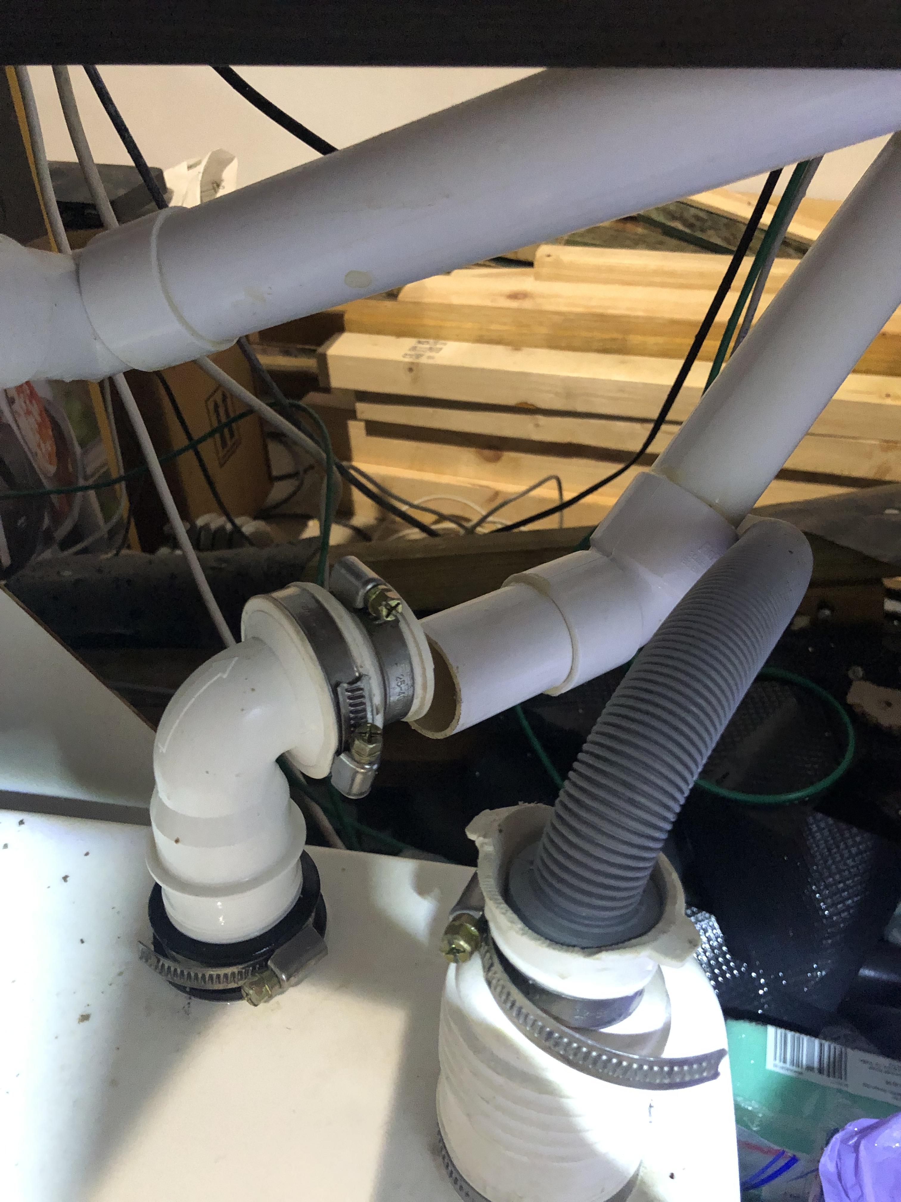

Pocster Posted September 17, 2023 Posted September 17, 2023 I (expletive deleted)ing hate these ! Had one fail ages ago outside on rainwater pump so no big drama . Sunday ; chilled ; sipping wine then woooosh ! Sound of water pissing everywhere ! Washer outlet had come free from its shitty jubilee clip ! If I hadn’t been there washer would have carried on and flooded the floor more . Apart from checking the clips every day ! - surely there must be a better fixing. This washer in our temp kitchen has been fine for 2 yrs . That happening in the new kitchen wouldn’t do the kitchen units any good . There must be a better - 100% solid as a dogs dangles fitting . I (expletive deleted)ing hate jubilee clips ! - accident waiting to happen ; and it did !

Russell griffiths Posted September 17, 2023 Posted September 17, 2023 Fitting a smooth outer pipe into that rubber and relying on a jubilant cup is asking for trouble you need a pipe with a lip on it so it’s trapped behind the jubilee clip. Sort of how the neck on a car radiator is. I would sort out your 100% finished idea and then visit a pump and hose specialist and get some better fittings made up. Just out of interest any fitting on the pressure side of the system, should they be pressure pipe rather than just 40mm waste and flexible fittings. The sort used on swimming pool and jacuzzi setups not just a dribble from a kitchen sink. 2
Pocster Posted September 17, 2023 Author Posted September 17, 2023 51 minutes ago, joe90 said: @Pocster in what way did it fail?, just come off or break? Just come off !
Pocster Posted September 17, 2023 Author Posted September 17, 2023 42 minutes ago, Russell griffiths said: Fitting a smooth outer pipe into that rubber and relying on a jubilant cup is asking for trouble you need a pipe with a lip on it so it’s trapped behind the jubilee clip. Sort of how the neck on a car radiator is. I would sort out your 100% finished idea and then visit a pump and hose specialist and get some better fittings made up. Just out of interest any fitting on the pressure side of the system, should they be pressure pipe rather than just 40mm waste and flexible fittings. The sort used on swimming pool and jacuzzi setups not just a dribble from a kitchen sink. Appreciated! A link to something more suitable ??
joe90 Posted September 17, 2023 Posted September 17, 2023 10 minutes ago, Pocster said: Just come off ! So it didnt fail (break),as said above there needs to be ribs or something for the rubber pipe to grip on.
Pocster Posted September 17, 2023 Author Posted September 17, 2023 1 minute ago, joe90 said: So it didnt fail (break),as said above there needs to be ribs or something for the rubber pipe to grip on. Yep . The fitting used were the ones supplied with the pump ; so naturally I used them . A similar fitting with a lip would indeed be better 1

Big Jimbo Posted September 18, 2023 Posted September 18, 2023 "Bit like a car radiator" You can make that on the 40mm exit pipe. Use a straight solweld pipe connector. Cut a 3mm ring, and glue it on the end. 1

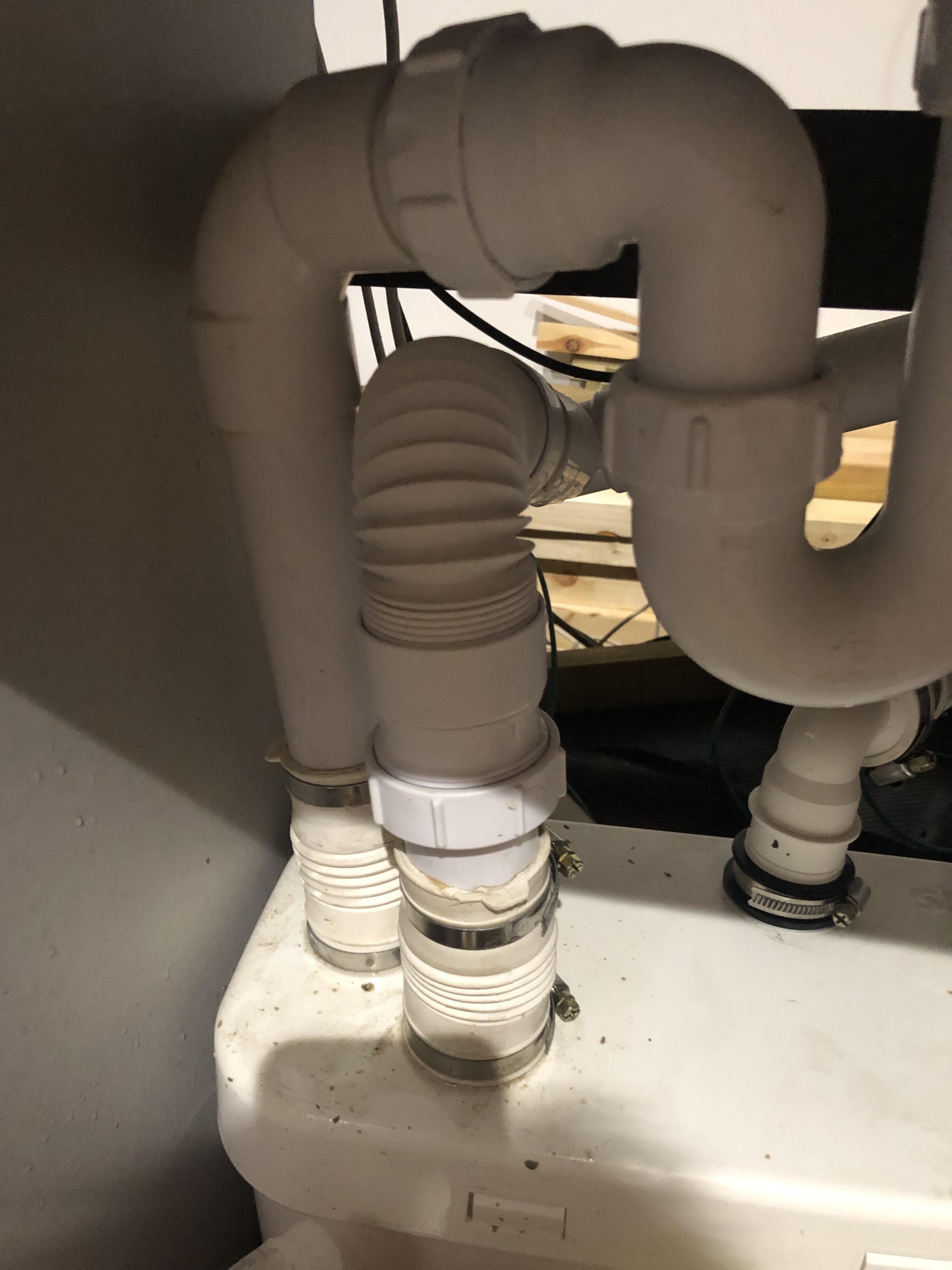

Mr Punter Posted September 18, 2023 Posted September 18, 2023 If those pipes are connected to a saniflo you got what you deserved for dining with the Devil! 1 1
Pocster Posted September 18, 2023 Author Posted September 18, 2023 3 minutes ago, Mr Punter said: If those pipes are connected to a saniflo you got what you deserved for dining with the Devil! Evil ! What should I use ! Only grey water - but yes; dance with the devil !

Onoff Posted September 18, 2023 Posted September 18, 2023 Can't you redo the whole lot in solvent weld?
