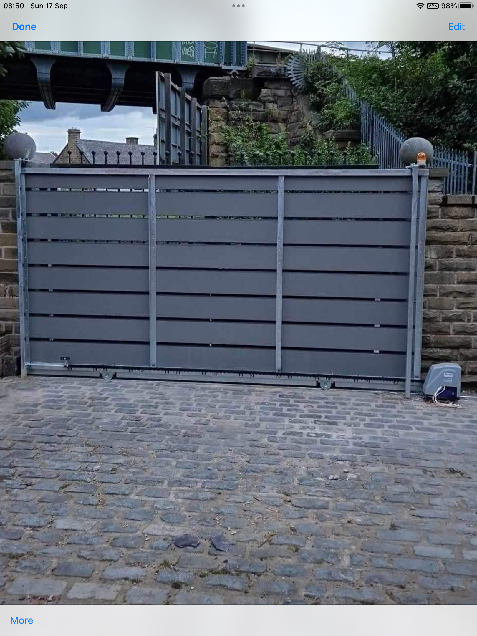

markc Posted September 17, 2023 Posted September 17, 2023 (edited) One I’ve just made and fitted, ignore the wires hanging around the motor and the old/existing gate immediately behind as it’s work in progress. Fabricated steel frame, galvanised and boards are composite T&G cladding. Edited September 17, 2023 by markc 1
Conor Posted September 17, 2023 Author Posted September 17, 2023 A DIY box section steel frame with timber slats was the original choice, but with a three year old and a 4month old in the house there just isn't the time. Just not sure how sturdy a 1.2mm thick aluminium slatted panel gate will be? We could get something bespoke made out of galvanised steel from Lithuania for about £2.5k. But a good 6-8week waiting time.

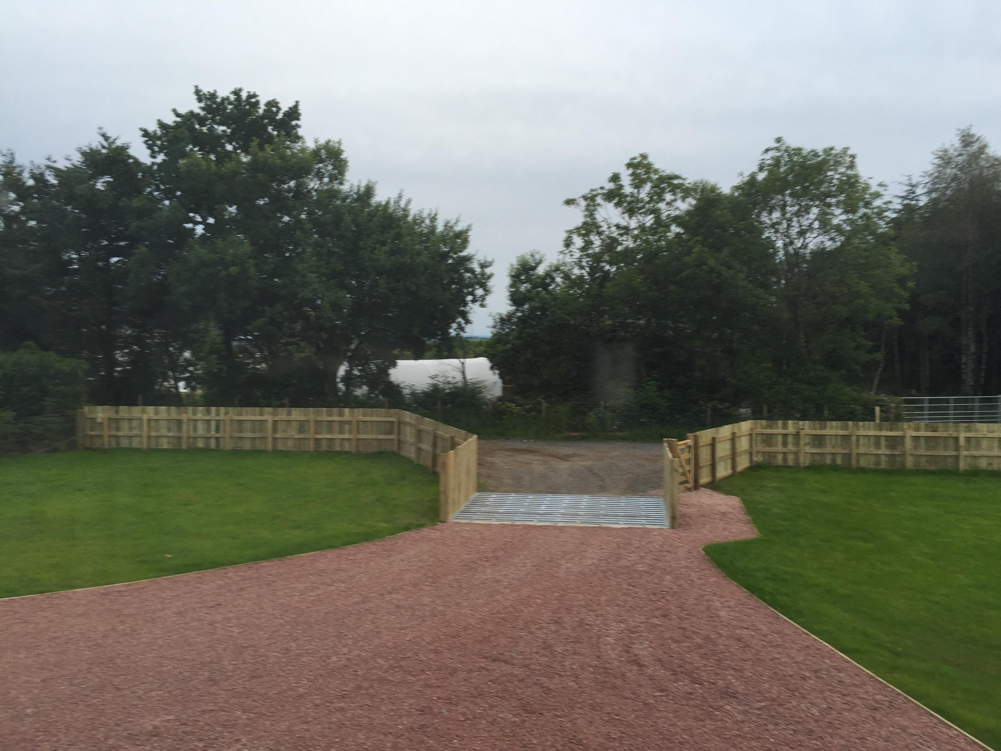

Ecthelion Posted September 18, 2023 Posted September 18, 2023 People near me have electric gates and I found them ridiculously expensive. They also break a lot. Instead I put in a cattle grid, with a bit of fencing either side. Cost £2k all in, including the digging. it keeps the dog in and other dogs out. The kids can cross the cattle grid but it slows them down considerably and they won’t be wee and daft for long.
