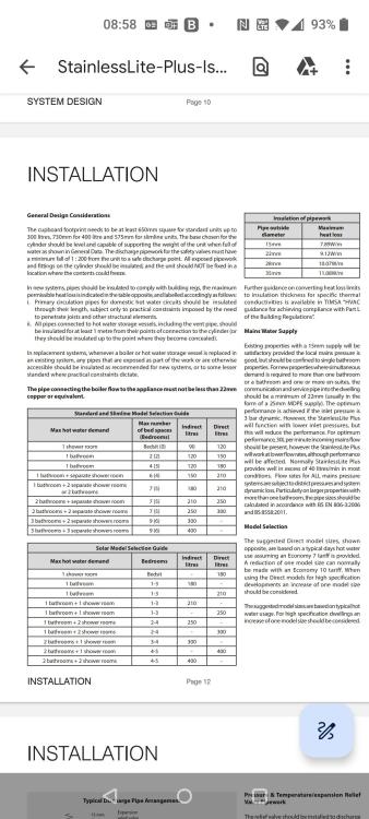

JohnMo Posted September 15, 2023 Posted September 15, 2023 Would think you need to know some basic info first, if you have water available. The static and dynamic pressure and flow rate available. Here is a snippet from a a Gledhill cylinder installer manual, let's you know about flow and pressure. 1

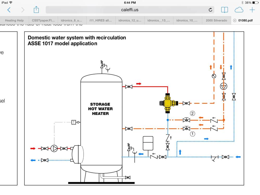

ReedRichards Posted September 15, 2023 Posted September 15, 2023 I thought the correct way to plumb the TMV was to run a loop of pipe down from the top of the cylinder then position the TMV at the bottom. Hot water from the cylinder can rise up to the top of the loop but for heat to travel down to the TMV it has to work against convection so the TMV stays suitably cool and lives longer. I cannot remember the exact length of pipe you can use for the loop but you should be able to look it up.
ReedRichards Posted September 15, 2023 Posted September 15, 2023 On 15/09/2023 at 07:38, joth said: Fundamentally putting a TMV inside a secondary return circuit is bad design, as you're trying to mix in additional water with no where for it to go to. Expand There is a rather complicated plumbing arrangement you can use to fix this (see figure 4 https://www.hpacmag.com/features/recirculating-domestic-hot-water-system/ . In the North America you can buy this as a single integrated unit but they're not available here for any reasonable price. 1

JohnMo Posted September 15, 2023 Posted September 15, 2023 On 15/09/2023 at 11:06, ReedRichards said: There is a rather complicated plumbing arrangement you can use to fix this (see figure 4 https://www.hpacmag.com/features/recirculating-domestic-hot-water-system/ . In the North America you can buy this as a single integrated unit but they're not available here for any reasonable price. Expand Every day a learning day. So had a dig round the internet to find a drawing of the layout in fig. 4 more applicable to a UK cylinder with a dedicated recirculation loop taping point. See below. The bypass and return valve would be a globe valve or similar to allow accurate and repeated flow control. This setup should allow a continuous flow of water through the cold port of the mixing valve 1
ReedRichards Posted September 15, 2023 Posted September 15, 2023 (edited) It was in 2020 that I was looking at this. After wracking my brains for a bit I remembered that it's ESBE who do the most integrated unit and you can now buy one on eBay for a much more reasonable price than I could find then. Here are some details: https://esbe.eu/group/products/thermostatic-units/vtr300-vtr500 . Oh, here's a nice little video: Edited September 15, 2023 by ReedRichards
