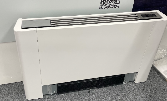

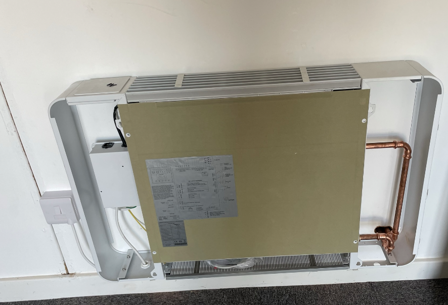

LaChab Posted January 23, 2024 Share Posted January 23, 2024 I was wondering if a few of these would work if they were fitted into the ceiling........ https://www.myson.co.uk/products/kickspace.htm Even with water at 40c, just one could probably contribute 1kw, enough for a whole well insulated house! And they're cheap enough to fit in each (downstairs) room. Run all day off nightime off-peak heat. There's a sophisticated variant, but it's a bit pricey. https://smithsep.co.uk/catalogue/caspian-universal-concealed-fan-convector/ Link to comment Share on other sites More sharing options...
joth Posted January 23, 2024 Share Posted January 23, 2024 Yeah not bad shout on plinth heaters especially if you could install them at floor level. If paying more for the fancy unit I'd want something that could cool too (ie wih condensate tray). And why on earth did they name it a UVC 🙄 Link to comment Share on other sites More sharing options...
