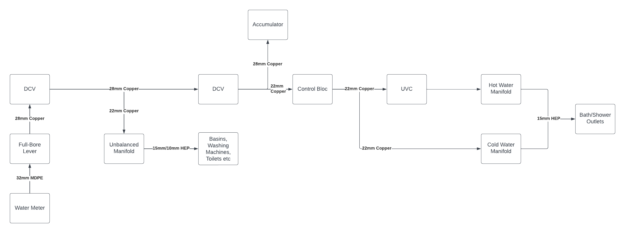

jayc89 Posted September 13, 2023 Author Share Posted September 13, 2023 So if using an accumulator would something like this look right? I'm assuming the additional DCV before the accumulator would be needed to avoid it boosting the outlets connected to the unbalanced manifold too. Link to comment Share on other sites More sharing options...
markocosic Posted September 14, 2023 Share Posted September 14, 2023 I'd boost the lot. The toilets etc will reduce incoming mains pressure for a given flow rate anyways; so something off only helps marginally Link to comment Share on other sites More sharing options...
jayc89 Posted September 14, 2023 Author Share Posted September 14, 2023 10 minutes ago, markocosic said: I'd boost the lot. The toilets etc will reduce incoming mains pressure for a given flow rate anyways; so something off only helps marginally Seems a bit of a waste doesn't it? My thinking was to only use the accumulator for "priority" supplies where I care about the flow; basically showers. Everything else works fines on mains pressure/flow. We'd also want "fresh" drinking water, rather than water stored in the accumulator for any length of time. Link to comment Share on other sites More sharing options...
markocosic Posted September 15, 2023 Share Posted September 15, 2023 More check valves is more pressure drop was my thinking Also the hassle of running (unbalanced) cold water to basins/toilets separately You won't get accumulator water at the kitchen tap if it's teed off before the accumulator unless the mains pressure happens to be high overnight and drop meaningfully during the day Link to comment Share on other sites More sharing options...
jayc89 Posted September 15, 2023 Author Share Posted September 15, 2023 45 minutes ago, markocosic said: More check valves is more pressure drop was my thinking Fair point. I think I saw @Nickfromwalesrecommended an oversized DCV and use a reducing ring to go back to the pipe size at either side of it. But given it's already on a 28mm pipe, I think the next size up would be 35mm and they're crazy expensive. Surely the cost outweighs the benefit of saving, what, approx 0.1 bar pressure? 45 minutes ago, markocosic said: You won't get accumulator water at the kitchen tap if it's teed off before the accumulator unless the mains pressure happens to be high overnight and drop meaningfully during the day That's OK, we typically shower in the evenings so want to try keep the accumulator fully charged throughout the day if we can (assuming pressure increases overnight) and mains flow is 12 LPM so, if that's predominantly shared between toilets, washing machine, dish washer and drinking outlets, we can probably manage with that. It's the drop when someone wants a shower that I'm trying to fix. Link to comment Share on other sites More sharing options...
Nickfromwales Posted September 15, 2023 Share Posted September 15, 2023 7 hours ago, jayc89 said: Fair point. I think I saw @Nickfromwalesrecommended an oversized DCV and use a reducing ring to go back to the pipe size at either side of it. But given it's already on a 28mm pipe, I think the next size up would be 35mm and they're crazy expensive. Surely the cost outweighs the benefit of saving, what, approx 0.1 bar pressure? That's OK, we typically shower in the evenings so want to try keep the accumulator fully charged throughout the day if we can (assuming pressure increases overnight) and mains flow is 12 LPM so, if that's predominantly shared between toilets, washing machine, dish washer and drinking outlets, we can probably manage with that. It's the drop when someone wants a shower that I'm trying to fix. You should have all the ‘white goods’ etc straight off the mains, then a NRV and then the accumulator > bathing. The outside taps should be off the mains before it enters the building. 1 Link to comment Share on other sites More sharing options...
jayc89 Posted September 15, 2023 Author Share Posted September 15, 2023 2 hours ago, Nickfromwales said: You should have all the ‘white goods’ etc straight off the mains, then a NRV and then the accumulator > bathing. The outside taps should be off the mains before it enters the building. Thanks Nick. What about drinking water (i.e. kitchen tap)? Or is that down to personal preference? Link to comment Share on other sites More sharing options...

Nickfromwales Posted September 15, 2023 Share Posted September 15, 2023 39 minutes ago, jayc89 said: Thanks Nick. What about drinking water (i.e. kitchen tap)? Or is that down to personal preference? Always off the hard mains normally, but down to preference (and understanding why the choice is made) tbh. 1 Link to comment Share on other sites More sharing options...
