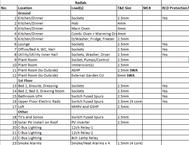

I thought I post this for a)interest b)to seek the views of the collective!
I'm planning on radial circuits and my draft list is as follows. My first thought is it seems like a lot of circuits requiring a big CU!
The last two columns are incomplete.
Thoughts?
(Circuit 16 is for fail safe only. No plans to install the electric rads initially. I've gone with 4 core as that matches the electric radiator control system we have in the flat (it uses the 4th core as a comms/control).
Edited by Barney12
Table didn't appear! Now a JPG.

9 and 11 need to be unified IMO,mas the controls of a device should be fed from the same breaker as the device. 4mm2 cable going to the plant room, and the ashp isolator and feed there. ?
Yep that can work. CU is in plant room and that SWA is also already in the plant room as it was one of the slab insertions.

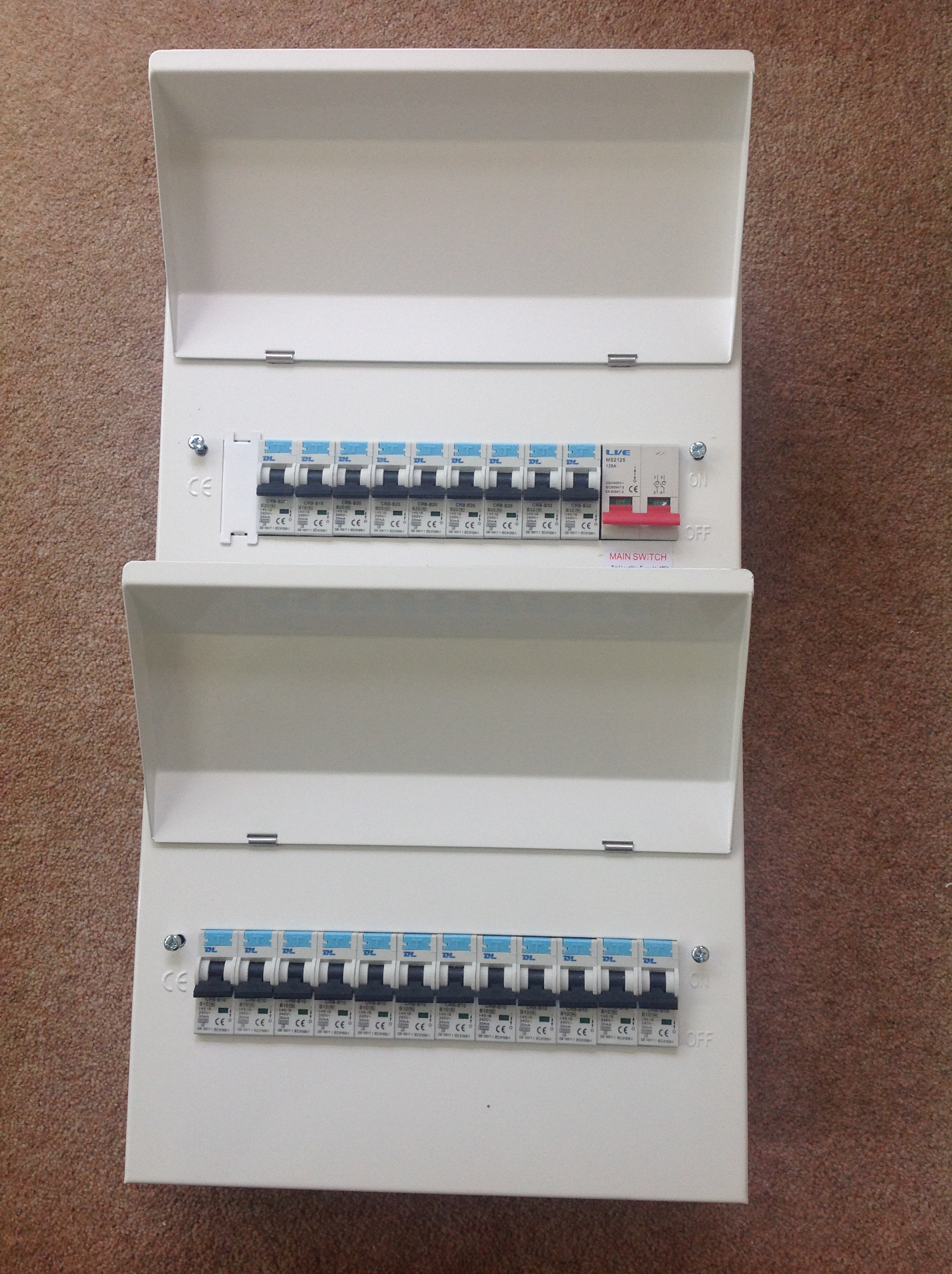

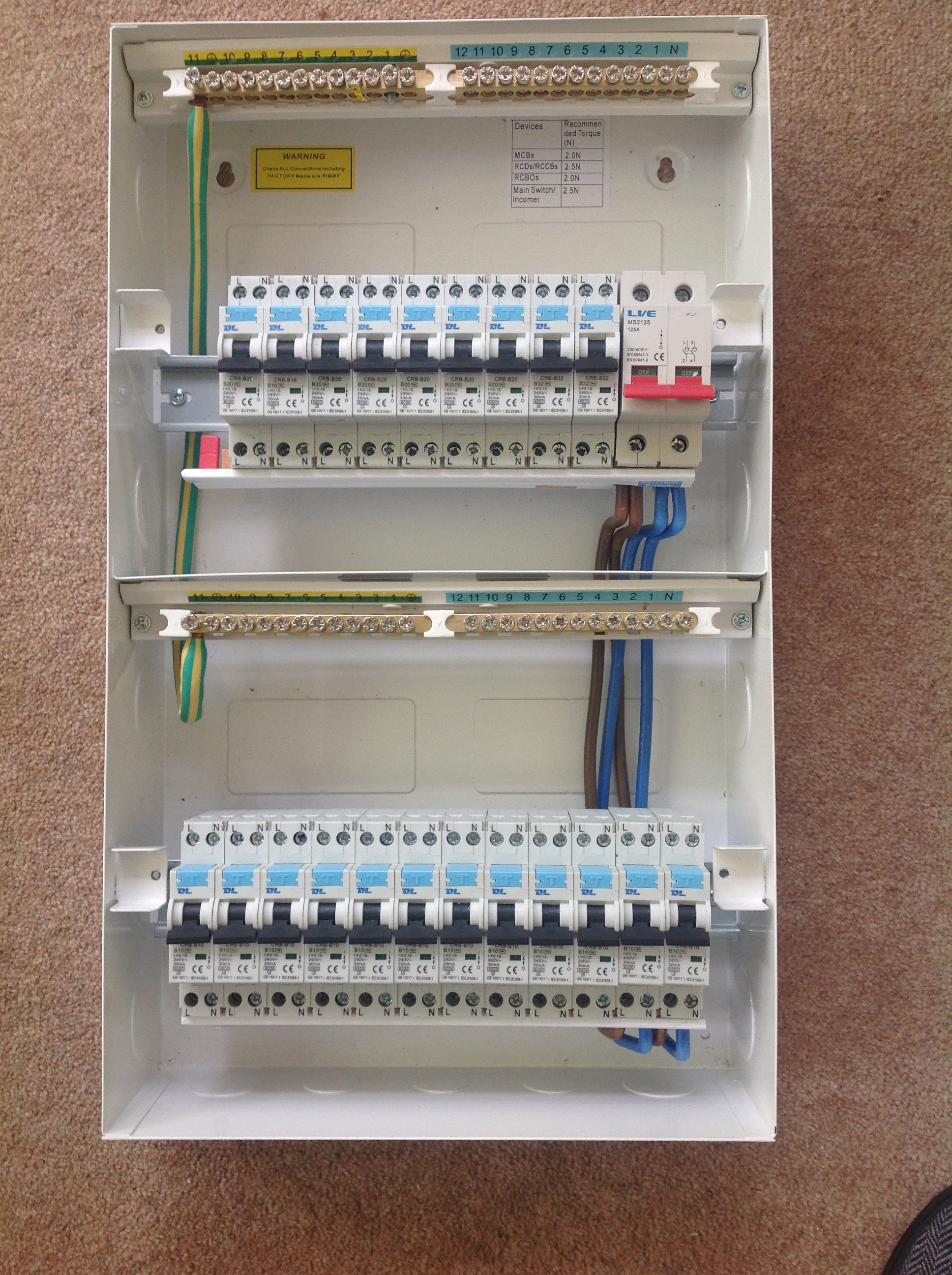

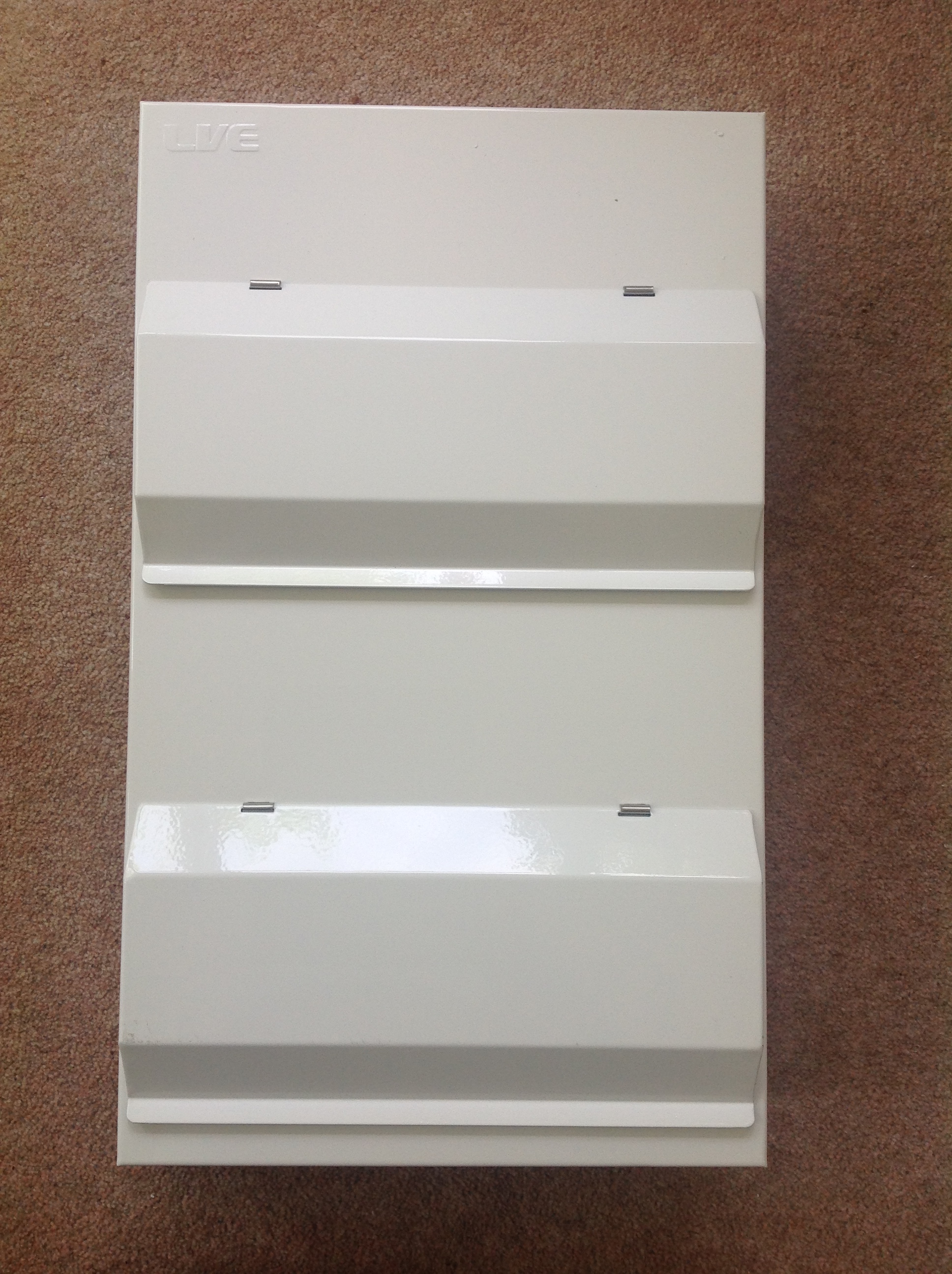

I enquired to Dave at SBS ref his Compact RCBO boards in this sceanario, he's come back:
"The biggest size of double decker (in fact, the only size that LiVE do) is a 24-module / 22-way box.
This would not give you the 24 circuits you need, unless there is a circuit rethink. Attached, is one I did for a customer, with 22 circuits.
A good solution would be stacked 2 x 14-mod boxes, giving you 26 usable ways, if using 1 x Main Switch, or 24 usable ways, if using 2 x Main Switches.
They could be coupled together, using brass or plastic bushes, giving room for all cables to pass through. Alternatively, they could be coupled them together with, say, 2 small bushes and bring all the cables, including tails, through the back knockouts, using my Stand Off Frames.
Let me know if I can be of further assistance and I look forward to hearing from you again.
Regards
David"

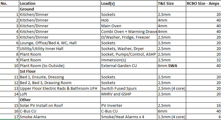

That looks bloody ideal. I'm down to 22 circuits if I combine 9 and 11 as per Nick's advise?
Will he supply me (my sparky is labour only with me supplying all materials)?
