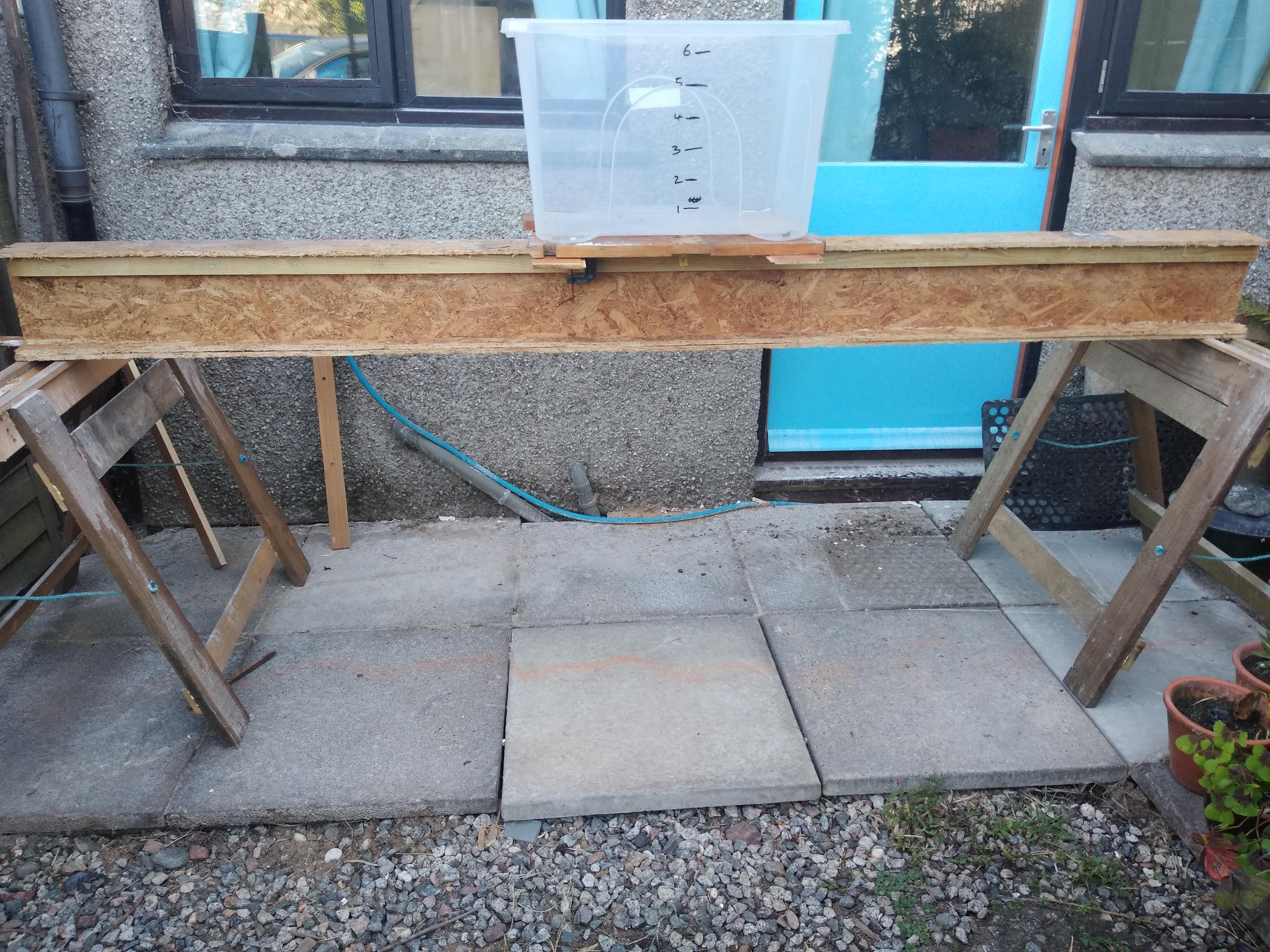

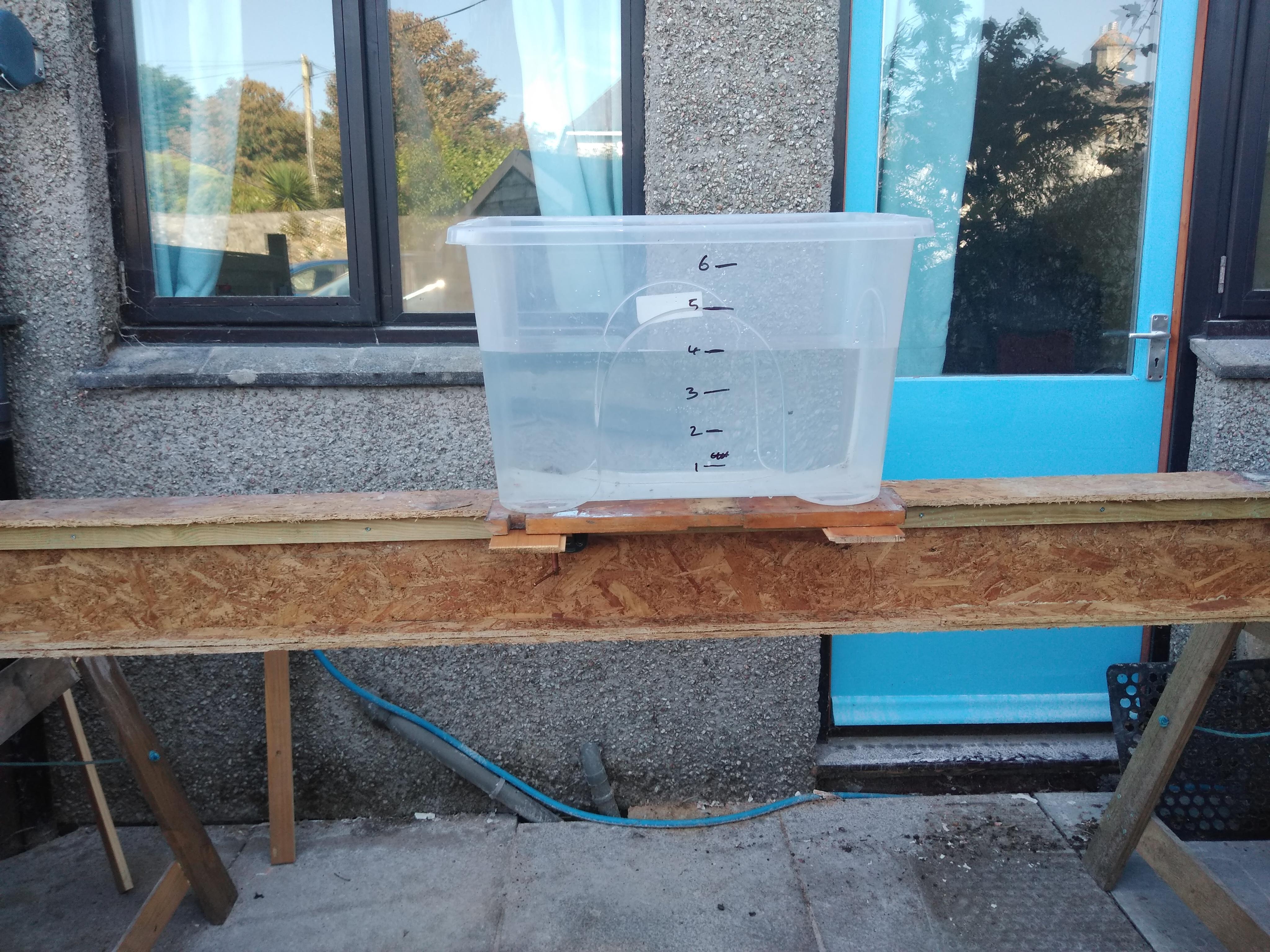

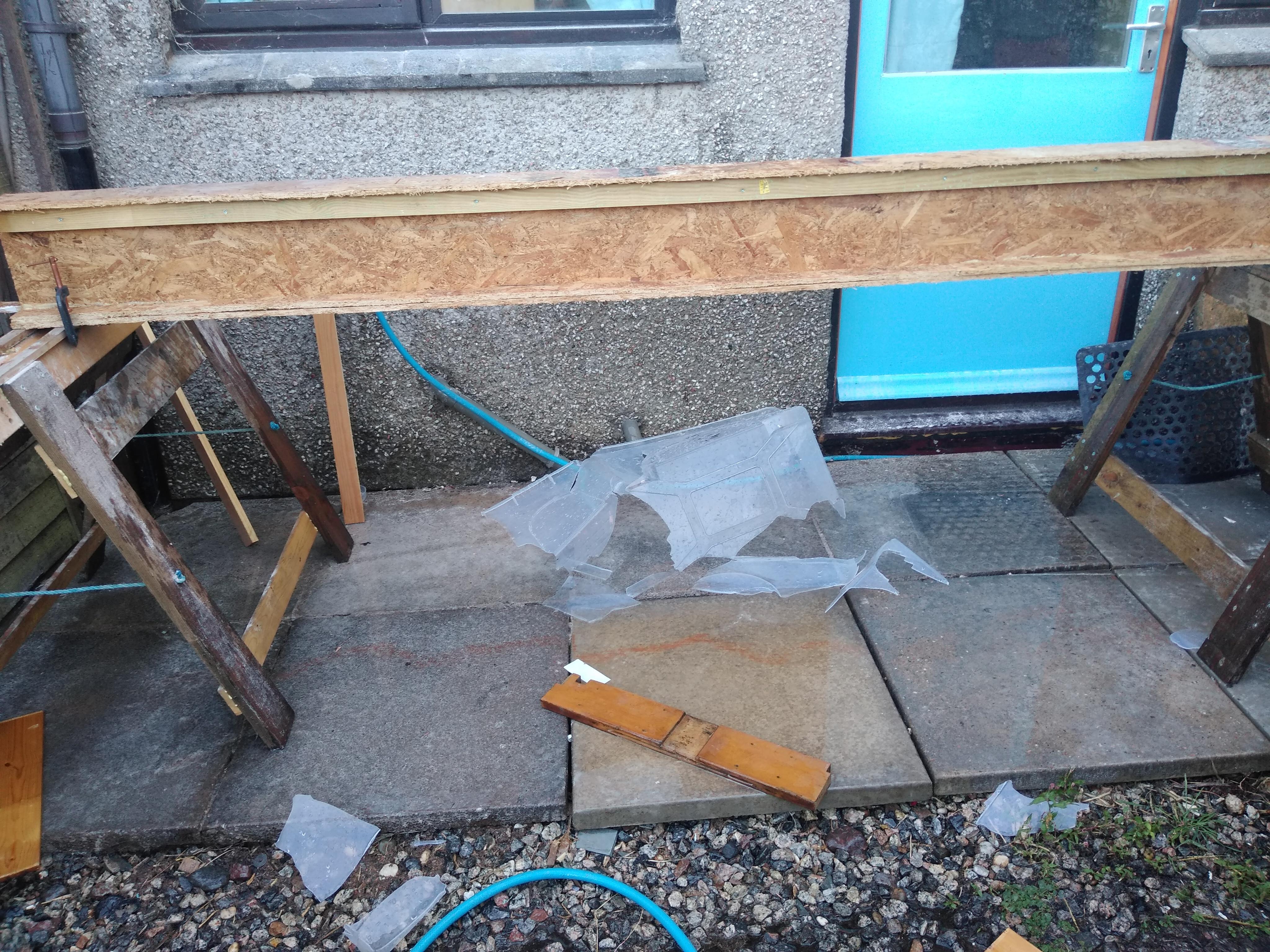

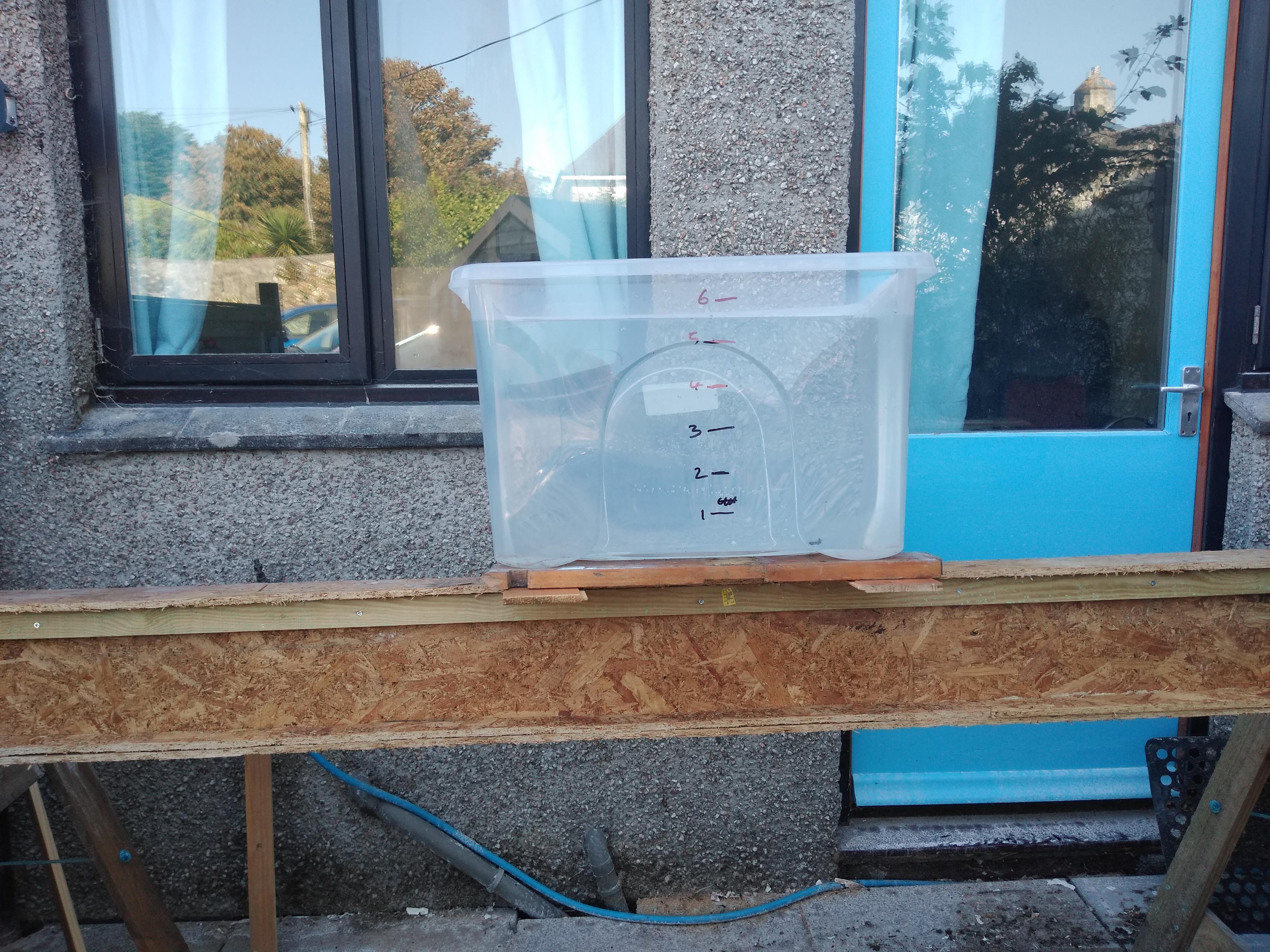

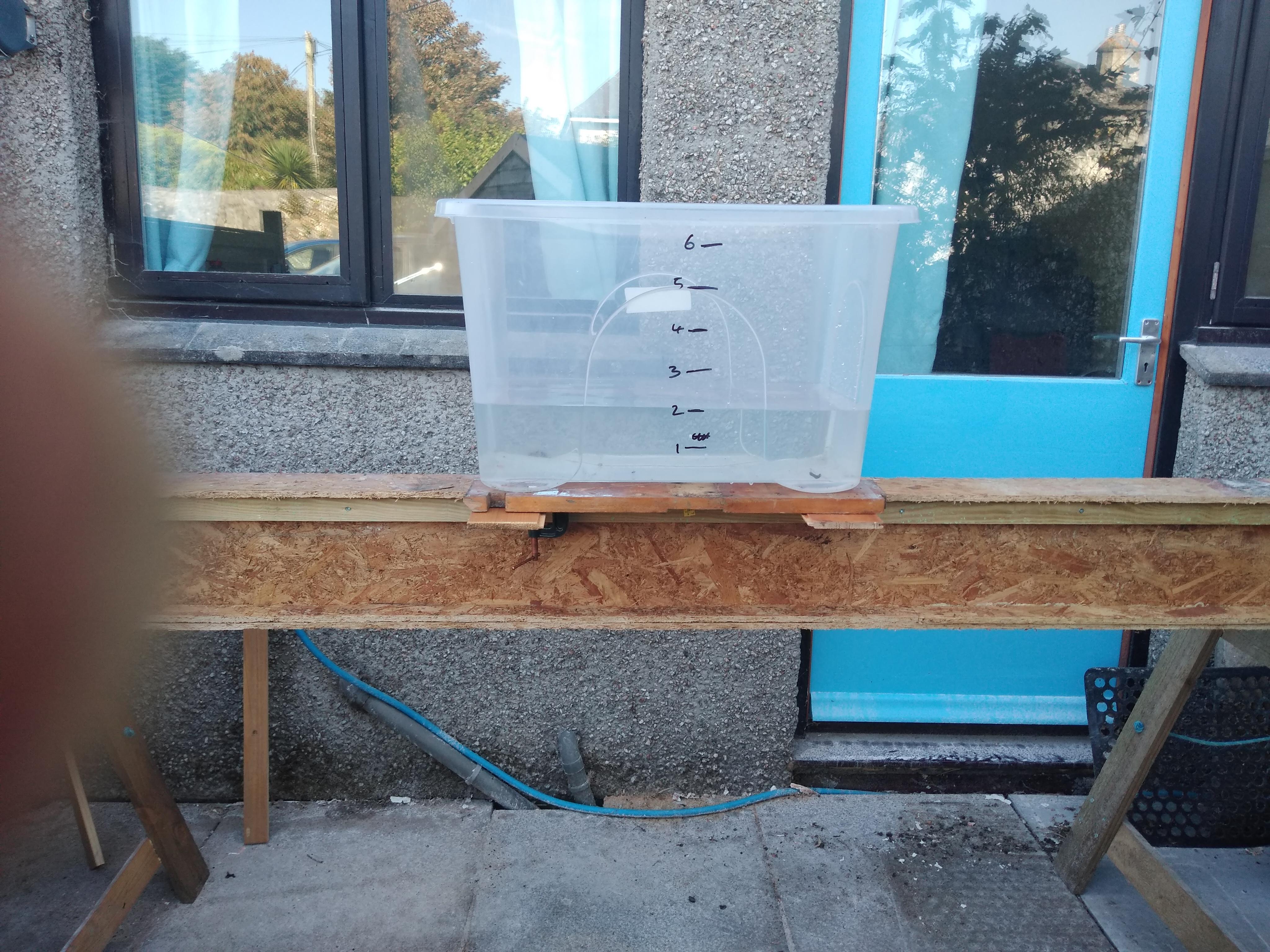

SteamyTea Posted September 6, 2023 Posted September 6, 2023 Tomorrow I go back to work after 2 months off. Now I have totally wasted that time, so thought I better catch up with a little experiment I had in mind. With some old 9mm OSB, I made a 200mm deep beam. It is 2.26 m long, and held together with cheap PVA 'no nails' type adhesive (cost a quid a tube). The flange is 100mm wide. One flange is 2 layers of OSB, the other is 2 strips of timber, 20mm by 35mm holding the other flange in place. To test it I put a box on it and filled it with water. It basically only moved 6mm when I had put 52 kg of mass in the middle. Some of that will be because the whole thing became unstable on the trellises. The result is shown in the last picture. Going to be plenty strong enough to make a shed from, so may use cheaper, thinner ply and smaller battening timber. Ā I think I will get @Gus PotterĀ and @saveasteading work out the numbers, my moments if gryration were jumping out the way when the box of water fell. Ā Ā Ā Ā Ā Ā 2

saveasteading Posted September 6, 2023 Posted September 6, 2023 Well i am impressed. I think I'd put some nails in, in case the glue deteriorates with time or temperature. I don't think there are any rules for garden shed strengths. Even so, I have delegated beam strength calculation for some decades so am not about to restart now. What's the worst load? 1m of snow or a person. Your 50kg load is good enough for me. The decking board will also act as a flange if fixed well enough.Ā Ā Now if you can get the materials cheap as seconds...you know the boards delivered with corners bashed that should be in a corner of the bm. Ā
SteamyTea Posted September 6, 2023 Author Posted September 6, 2023 6 minutes ago, saveasteading said: What's the worst load? 1m of snow or a person. Your 50kg load is good enough for me. A person, but maybe a green roof.Ā Be nice if I could hang my kayak from it if I can get enough height. I want a shed where I can open up one side (near enough).Ā That way I can make the door like a garage door and get an extra 1.8 covered area.Ā That way I can do dusty work but still be out of the sun, or the rain. Ā 10 minutes ago, saveasteading said: The decking board will also act as a flange if fixed well enough.Ā I was thinking of using the decking as the flange.Ā Make it in panels and then just glue and screw together. Basically all panels will be the same, i.e. 2.4m by 1.2m and just do infill panels to make the roof slope.

Gus Potter Posted September 8, 2023 Posted September 8, 2023 On 06/09/2023 at 17:09, SteamyTea said: I think I will get @Gus PotterĀ and @saveasteading work out the numbers, my moments if gryration were jumping out the way when the box of water fell. Hi Steamy. Ā If you want a quick set of section properties (unverified by calculation) I can do that.. I would cheat a bit in that I would draw the cross section in Auto CAD, and use the MASSPROP function.. this gives the I (second moment of area) values, centre of gravity, radius of gyration etc. Do a sketch of the cross section and I'll try and post the results. From that you could work out the stresses in the outer fibres. To do this you would use the same approach as you would do for a flitch beam... timber and steel combined.. but it would be more complex due to the geometry.. I won't do that for you. Ā You are using two different types of timber that have a different Youngs Modulus.. thus things suddenly get a lot more complicated to do manual calculation. Ā If you fancy it you can expand you experiment to calculate the average Youngs modulus using a true central point load as follows: Ā For a simply supported beam the deflection Delta = PL^3 / 48 E* I Ā Delta = deflection in mm, I = second moment of area mm^4 , E = Youngs modulus N/mm^2 , P = your point load (N) and L (mm) = the length between the supports. Use units of N (Newtons and mm as you units) Ā This rearranges to E = PL^3 / 48* I * Delta Ā Load up the beam increments and measure the deflection mid span. Plot a graph and you should get a fairly good result for E if done carefully and you have a good gauge... a tape measure won't really do. Ā Now you can compare your E value with that for chipboard. Now to be safe you may want to divide your E value by 1.96 (Conservative) based on a 95% normal distributon. You could use a value closer to the codes of dividing by 1.5 ish. This would give the the minimum modulus for a transfer beam... no load sharing etc. Ā For stength design you want to apply a material factor to your timber / chipboard grade stress of about 1.3 thus you take your grade stresses and divide these by 1.3 Ā And again to be safe you want to factor up your applied loads by say 1.5 so you multiply your load you have calculated by 1.5. Ā For the strength check you calculate the factored bending moment by using the formula P* L/4 and then calculate the stress using the formula M / Z = stress, Z is the section modulus. You then check that the applied stress is less than the allowable stress. Ā But there is an inherant weakness in these types of beams an that is web buckling over the bearing point so you need to add in vertical web stiffeners over the supports. Ā Have fun and let us know any results of further experiments! Ā Ā Ā Ā Ā Ā Ā Ā Ā Ā Ā Ā Ā Ā
