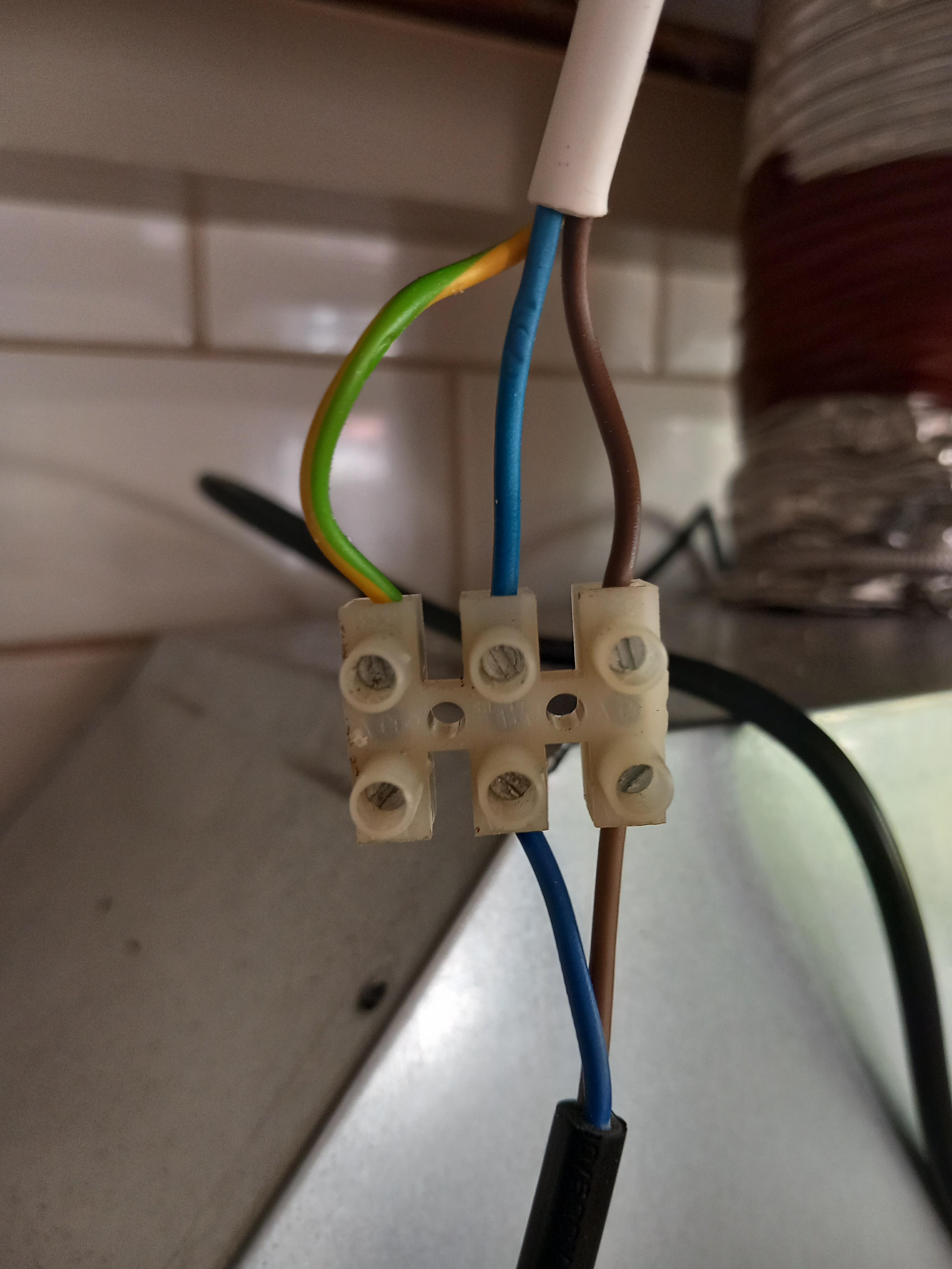

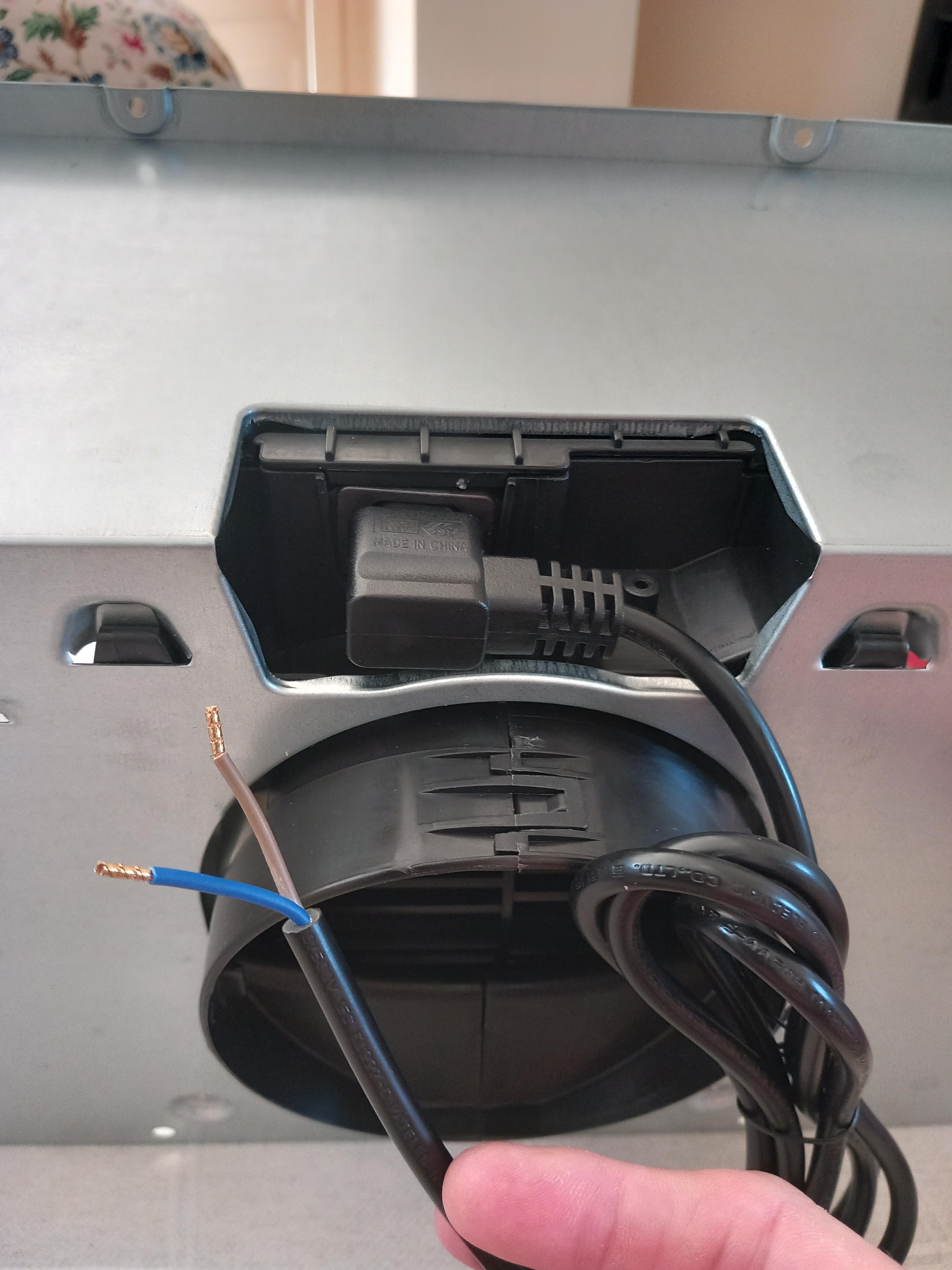

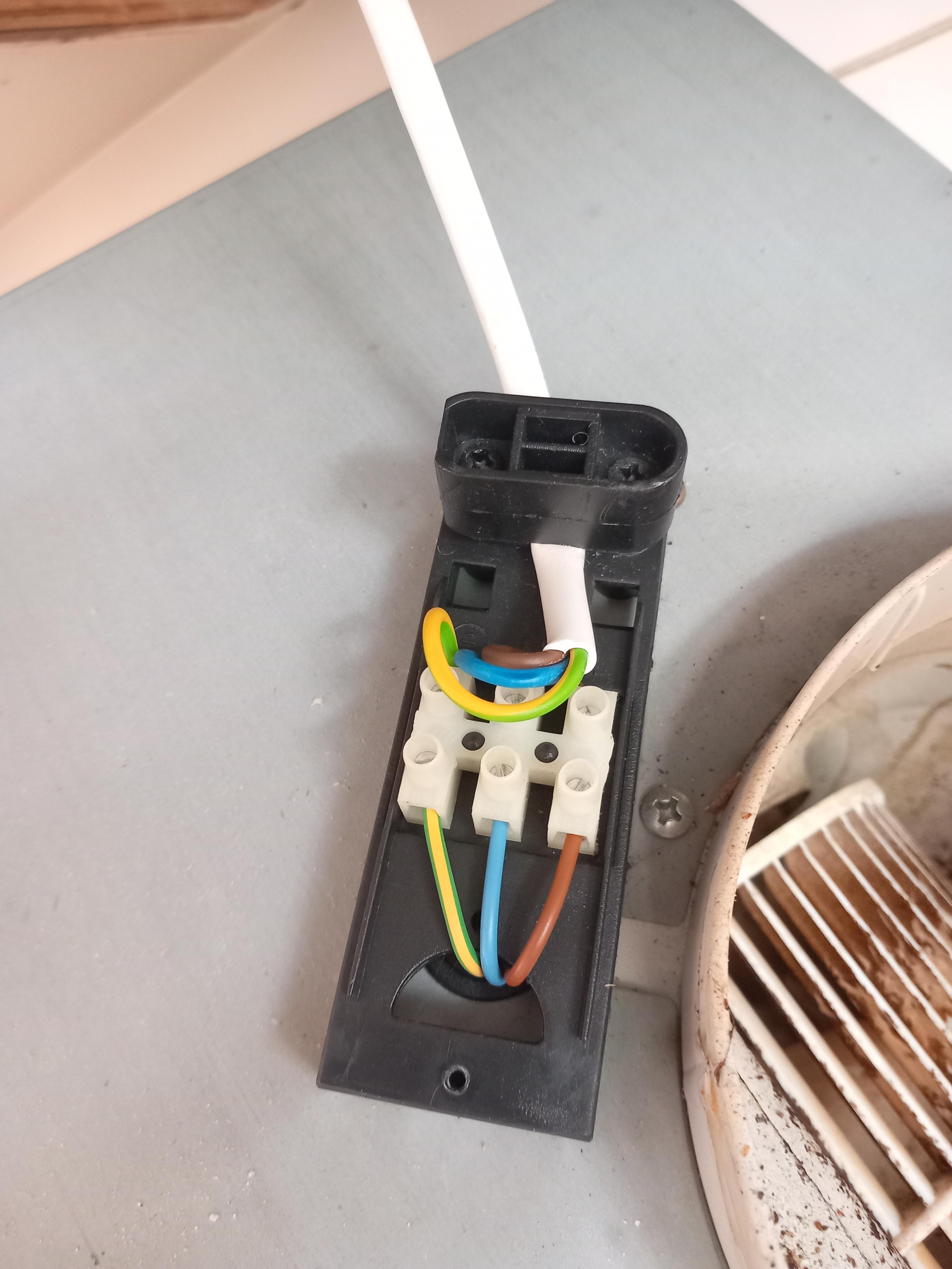

Dee Posted September 8, 2023 Author Posted September 8, 2023 Photo showing old fans wiring. New one does have a plug with brown and blue stripped wires at the other end. There's no earth on the new fan either. I want to completely remove the old fan anyway, so how do i 'cap' off the white cable to make it safe so i can turn the mains power back on?
markc Posted September 8, 2023 Posted September 8, 2023 Leave the ends in the connector or if you want to lose it, cut cores to different length and then wrap with insulation tape (cutting to different lengths prevents any chance of stray “hairs” shorting across 1

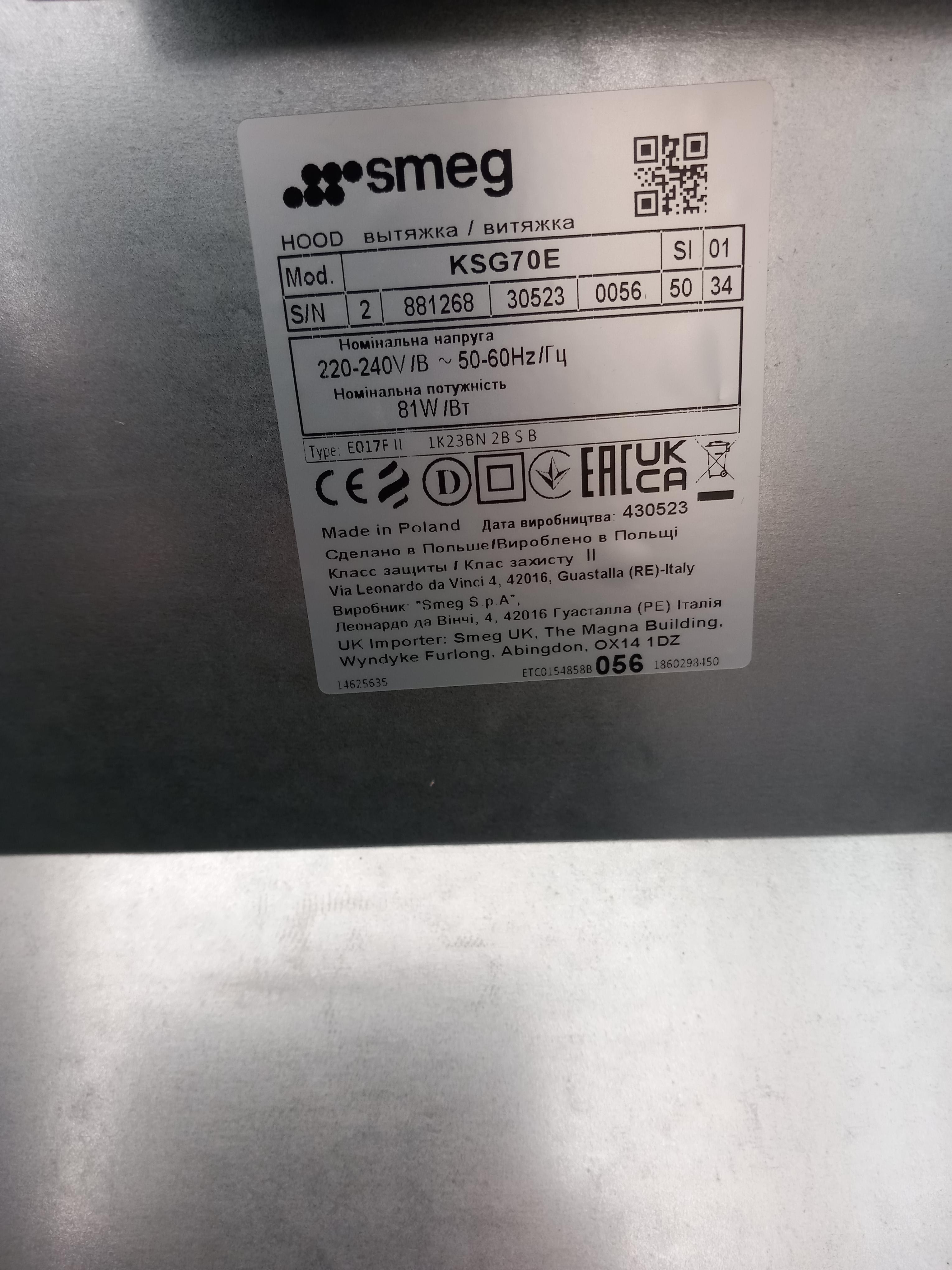

Dee Posted September 9, 2023 Author Posted September 9, 2023 So I guess the fan is double insulated therefore not requiring an earth? Live and Neutral and earth cable wired into old fan and disappearing into ceiling void (that I can't access) so can I simply 'splice' the new plug wires into the one that's hanging from the ceiling void and if so what do i do with the earth ? (see earlier image of white cable)
ProDave Posted September 9, 2023 Posted September 9, 2023 Use the old terminal junction box that was on top of the old hood to join the cables. Just leave the earth terminated going nowhere. You just have to work out how to detach the old junction box from the top of the old cooker hood, it looks like it might be riveted there? 1
Dee Posted September 9, 2023 Author Posted September 9, 2023 I can do that. But when you say terminate the earth somewhere, what exactly do you mean??? Thanks
ProDave Posted September 9, 2023 Posted September 9, 2023 17 minutes ago, Dee said: I can do that. But when you say terminate the earth somewhere, what exactly do you mean??? Thanks The 3 core cable comes in just as it did originally with all 3 cores terminated one into each terminal. Then only the 2 cores of the new cable to the new hood are connected so nothing coming out of the earth terminal. 1
Dee Posted September 10, 2023 Author Posted September 10, 2023 So this is how I wired the new fan in. Should I wrap insulation tape around it too? Turned power on and it all works!!!
FuerteStu Posted September 10, 2023 Posted September 10, 2023 2 hours ago, Dee said: So this is how I wired the new fan in. Should I wrap insulation tape around it too? Turned power on and it all works!!! If it were me, I would want a 'choc box' around that. https://www.screwfix.com/p/debox-24a-in-line-junction-box-50-x-102-x-28-5mm-white/8692H?kpid=8692H&cm_mmc=Google-_-Datafeed-_-Electrical and Lighting?kpid=KINASEKPID&cm_mmc=Google-_-TOKEN1-_-TOKEN2&gclid=Cj0KCQjw0vWnBhC6ARIsAJpJM6d7h7UdlLnHpLyERO9o6pgd1Jp-e6ufXM-IAlVHMIOeEhDR6ycdd_IaApBzEALw_wcB&gclsrc=aw.ds Reason being any movement on either flex could pull one of the terminations out. 1
ProDave Posted September 10, 2023 Posted September 10, 2023 2 hours ago, Dee said: So this is how I wired the new fan in. Should I wrap insulation tape around it too? Turned power on and it all works!!! I was expecting you to keep it in the original black plastic enclosure used on the old cooker hood so it was enclosed. I was rather making the assumption you had the lid for that box.

Dee Posted September 12, 2023 Author Posted September 12, 2023 Yes, i reslise in hindsight a chocbox would have been belt and braces. There is plenty of eire up there so even if the fan fell out the connection eoukd survive. I did wrap plenty of insulation tape around it. Did I do wrong?
markc Posted September 12, 2023 Posted September 12, 2023 4 hours ago, Dee said: Yes, i reslise in hindsight a chocbox would have been belt and braces. There is plenty of eire up there so even if the fan fell out the connection eoukd survive. I did wrap plenty of insulation tape around it. Did I do wrong? It will be ok with or without tape, long before choc boxes they were done like you have and before connector strip were available it was done (and still is in a lot of industrial places) by twisting or tying the cores together and then wrapping with tape. We used to make even 33Kv (33,000v) splices and Tee’s by twisting and taping.
TonyT Posted September 12, 2023 Posted September 12, 2023 A little joint box enclosing all the conductors would be good otherwise it’s a negative mark when any testing and inspection is carried out
