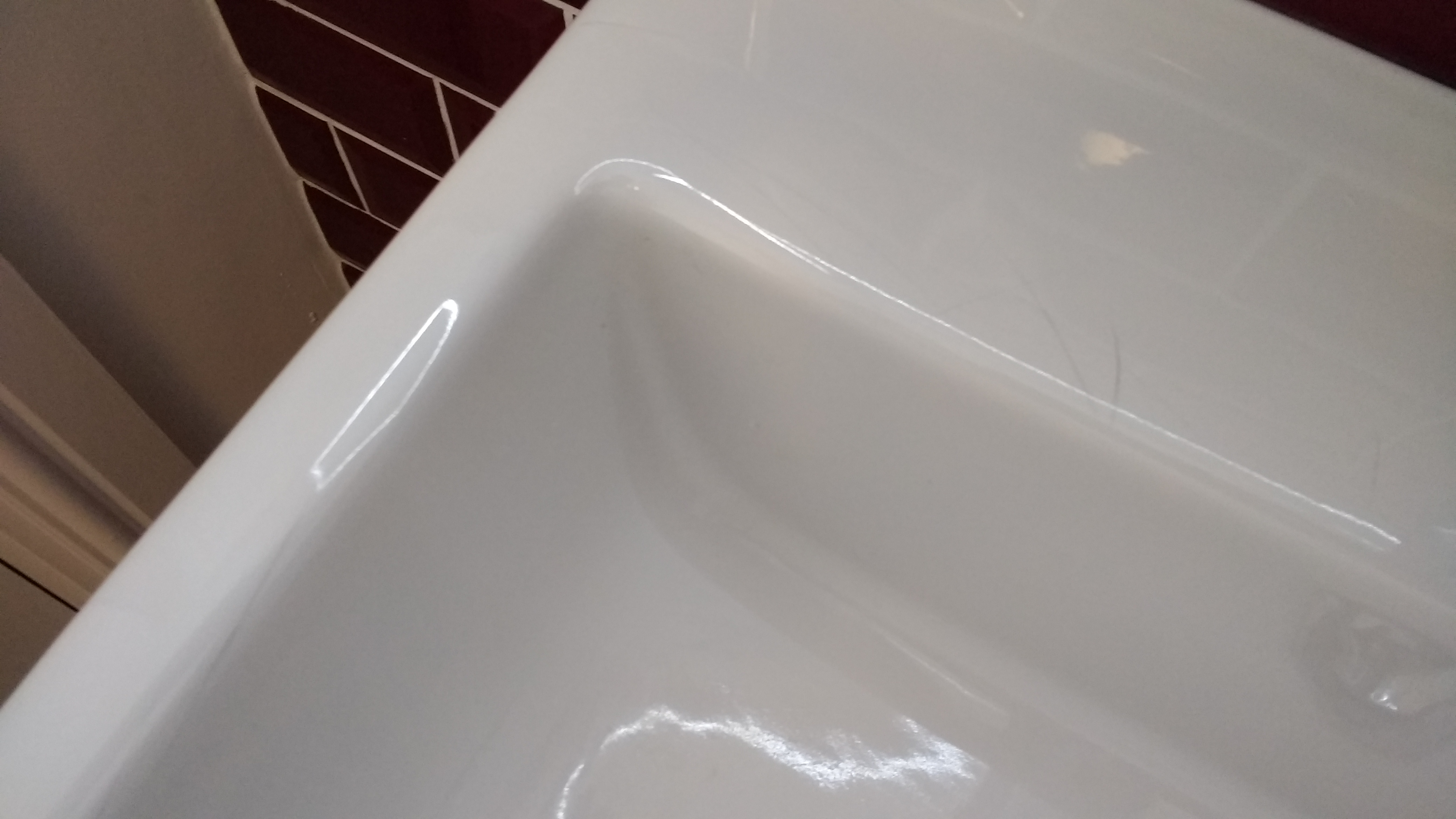

Tennentslager Posted August 28, 2017 Share Posted August 28, 2017 Two months old and slight black scratches/marks are appearing...hard to see in a photograph but I thought I could detect a pattern maybe indicating a stress fracture emminating from where it's bolted to the wall. Fitted it myself so was sure I didn't over tighten it and had the nylon bush property seated...visual check confirmed all was well underneath. Anyway, I worked it out. Faffing around drying the basin with toilet paper to get a clear picture I realised that I'd just added an identical type of scratch in a new place! It was my new Titanium wedding ring that's the culprit...maybe it's not Titanium and I was ripped off online again. Anyone ever heard of such a thing???? Link to comment Share on other sites More sharing options...
Stones Posted August 28, 2017 Share Posted August 28, 2017 (edited) @Tennentslager If the marks are not shifting with normal cleaning, and they are not deep scratches, try ceramic hob cleaner. Worked a treat on some marked sanitary ware (transit/packaging marks) we had. Edited August 28, 2017 by Stones 1 Link to comment Share on other sites More sharing options...
Nickfromwales Posted August 28, 2017 Share Posted August 28, 2017 This is gold mate. Wedding rings even my gold one ( which I never take off for anything regardles of the possibility of being skinned alive, as losing it would involve me being skinned from head to foot anyway ) cause serious marking. Watch straps are the same. On the £3k Victoria and Albert bath I posted pics of recently I rubbed a mark off, just some sticky residue from the electrical tape I used ( as a reference marker for the taps before the job got started as the customer then went to Spain for 3 weeeks ) and I noticed a small dark grey graze. I rubbed it vigorously and it eventually went, then another one. After two I realised I was making the chuffing new marks with my ring by rubbing off the other one. Its only £3k lol. Link to comment Share on other sites More sharing options...
PeterW Posted August 28, 2017 Share Posted August 28, 2017 I swear by one of these http://www.lakeland.co.uk/24466/3-Magic-Eraser-Stain-Remover-Cleaning-Blocks Bath and basin both had marks on them and this got them off in seconds. Link to comment Share on other sites More sharing options...
RichS Posted August 29, 2017 Share Posted August 29, 2017 https://www.toolstation.com/shop/Plumbing/d20/Plumbing+Consumables/sd2711/Cramer+China+and+Bath+Rubber/p93933 Wife uses one of these on our kitchen sink. Link to comment Share on other sites More sharing options...

Stones Posted August 29, 2017 Share Posted August 29, 2017 I tried using an eraser (unsuccessfully) prior to using hob cleaner. A useful fall back to have. Link to comment Share on other sites More sharing options...
