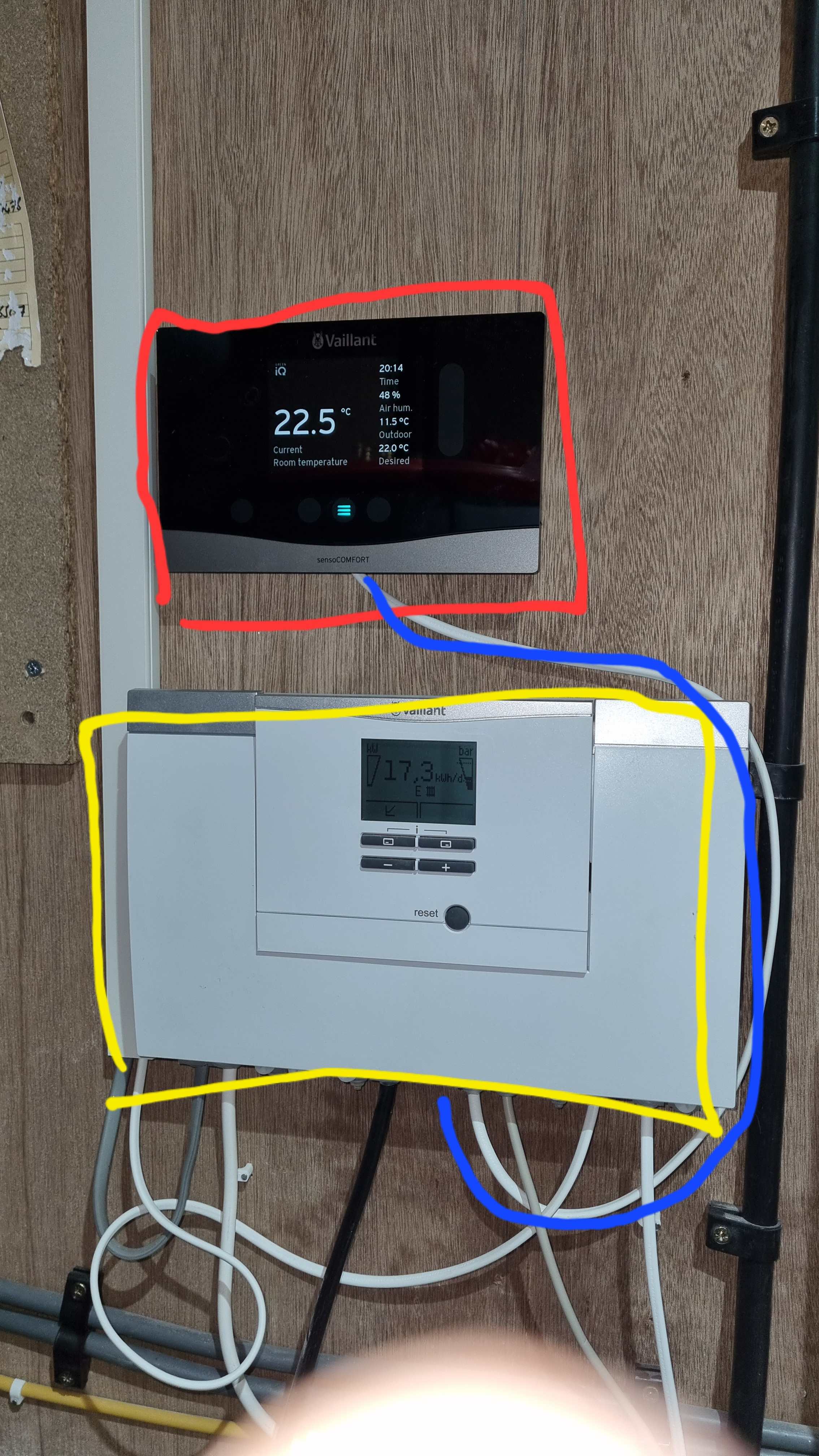

I've just sent Zoot a link to an article on the basics of how to setup the heating on the Vaillant controller (the black box) found on the FB Vaillant group.
Also, I've given Zoot the spec of cable (blue) needed to link the black box (in red) to the white box. (In yellow). Its 0.75mm twinflex as stated earlier.
FYI: I'm in the process of moving mine once my plumbing is sorted out. I suspect that Zoot's black and white box are also this close to each other.

Hi BB,
much appreciate the PM & this photo. The bigger interface box is exactly like mine.. but the controller-thermostat small black box, isn't like mine. Yours here is the VRC720.
Mine is the VRC700, just an older white model. It would've been ideal if I -did- have this newer one. But engineer informed me it was only the HP & the hydraulic unit to be swapped out (last time I ever need to say those 2 dreaded words!). I can't complain. I did ask engineer if newer black one could be fitted? No.
But basically, it's still the same though. @-rick- No the engineer -was- correct, he said 240v flying around the interface box, but only 20v flying around the small controller-thermostat box. Meaning in theory, I could by 30m of twin-core flex, & reposition this thermostat. Which he also agreed was feasable. But quite a job even so, for me.

AIUI the (white) VRC700 is compatible with current production HP units and probably capable of everything you need.
So I would not count on a VRC720 upgrade being the fix to whatever is wrong with your HW (which you do not describe in detail), though it is perfectly feasible to DIY involving only low voltage wiring as it does.
Also if you are going to upgrade then worth considering a switch to the wireless version while you are at it to get the internal temp sensor in a more sensible place. However this as already noted will involve fitting a wireless receiver and a new OAT sensor as well. This will be a considerable extra cost and you might struggle to recommission the new setup without paying for professional help. Then I would also recommend getting the internet interface installed so you can control the whole system from your smart phone which for everyday things is much easier to do.

Edited by sharpener
Posted
28 minutes ago, zoothorn said:
@BotusBuild Ive just had another glitch with the HW not doing it's thing. Called Vaillant, chap queried whether my VRC700 (left in place from prior HP system) should be a VRC 720 newer black job. Like your pic.
So 3x employees now concur with this query. Vaillant refusing to update it though.
I'm trying to persuade them though, to please pls pls at least just send me a VRC 720. I then pay an installer to fit it. They'll call back 48 hrs yes or no. If no.. I do see just the black box £50 on ebay.
OR maybe even fit it myself. So BB, how feasible is this to do?
I already know it's only 20v, & I have fitted an electric shower myself (even fully rebuilt a 100w fender Twin Reverb complicated amp- 450v flying round that monster!). I'd obviously power down the whole thing: this has two big yellow/ red plastic switches. Kinda 'mother switches'. And also can put all house power off too, to be super-sure.
Thanks Zoot
This is installer negligence / error. Tell them the system hasn't been left functionable, and demand that they send the proper unit out. Tell them you will agree to send the U/S unit back to them.
Posted
14 minutes ago, sharpener said:
Unfortunately finding someone to do all this might not be easy, from the Vaillant FB forum it seems installers do not like working on systems they did not originally install as there is so much scope for things to go wrong.
So in summary my recommendation would be to get the current setup working properly first. Have you looked at the Heat Geek map to see if there is someone on their register near you? They seem to be quite highly regarded though I have no personal experience.
These are all going to charge to attend, and as said not many installers will want to be left holding someone else's baby.
Posted
Good luck with that. V will argue that the VRC700 is compatible and they did not agree to upgrade the control box.
To understand whether this is a relevant factor we need more detail of the HW "glitch".
Of course. Better for @zoothorn to get to know the underlying physics, how his system works, its capabilities and limitations. But in the real world he may have to shell out folding money instead.
Posted
Zoot,
Others have answered on behalf. Thanks to them.
Agreed that the HW glitch needs sorting first, before you start replacing things that MAY not need changing.
Just a thought on the heating. If the VRC700 is inside a closed cupboard with the cylinder, is there enough length of cable (the blue one) to move it just outside the cupboard. That will then be in a slightly cooler place and so it won't switch off the heating as quickly, and before the rads have had more time to warm things up  a bit more. This is without making any setting changes so should be a simple to do move.
Posted
In the hope it’s good money after good, as so far…… :/
Posted (edited)
5 hours ago, BotusBuild said:
Zoot,
Hi BB,
no the VRC700 is not in a hot tiny enclosure with the cylinder.. I don't think any installer would be -that- inept. It's where it was, in the small bedroom on a wall outside the cylinder enclosure (this thin wall is never ever, even barely warm). This bedroom is gonna be the warmest, cos it's the smallest, cos it's got the cylinder in the corner enclosure... but it's still a feckin freezing cold room compared to yours! It's got cold loft air behind the plasterboard walls, no insulation bar loft fluff above, & a cold sittingroom below it.
Only way I can move the thermostat is buying 30m of cable & running it thru an attic, drill hole in ceiling, run cable down to kitchen/ thermostat there. But this room is SOO damn cold, 2nd coldest (one reason is bc there's no convenient wall to put anything but a single small double rad on: a mini fan heater is FAR better at heating this mostly ininsulated room, than this small rad ever does, or could ever do I reckon). I don't think this is a sensible place to put it myself, as surely just --too-- cold??
Anyway point is I can't afford to buy new wireless thermostat/ transmitter- receivers. Nor can I afford a plumber to reposition this vrc700. Nor will V likely send me a vrc720. So it's me do the job, if a freezing cold room is a sensible place for it.. rather than merely a cold room.
Thanks, Zoot
Edited by zoothorn
Posted
I'm never going to understand the basics of the difference between this ON setting that I thought was being suggested, & this timer setting that I thought wasn't being suggested.
I've tried today to read BB's link he sent me, but it's for the black controller vrc720, furthermore I'm lost immediately on the most seemingly simple stuff. Basic settings.
I think the only way forward, is saying maybe what I don't want. And seeing if something fits around this. So what I don't want, is the heating on overnight. I don't want the heat, the wasted cost, nor any mechanical noise (absolutely fumdamental is no machinery "wakes up" kicking into gear at 3am, no murmerings/ nothing/ not even outside cos some noise transmits via pipes, into bedrooms, the very rooms you least want mechanical noise entering at 3am).
Thanks, Zoot
