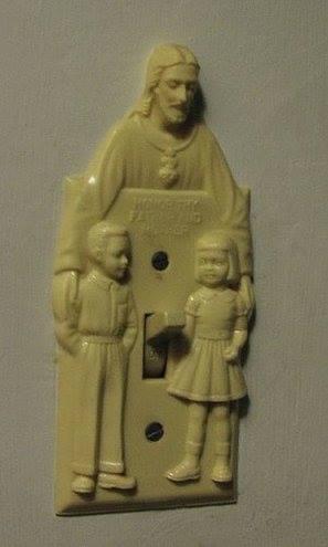

SteamyTea Posted August 26, 2023 Posted August 26, 2023 13 hours ago, Pocster said: What about this switch Catholic church was it? And what is this around his neck
