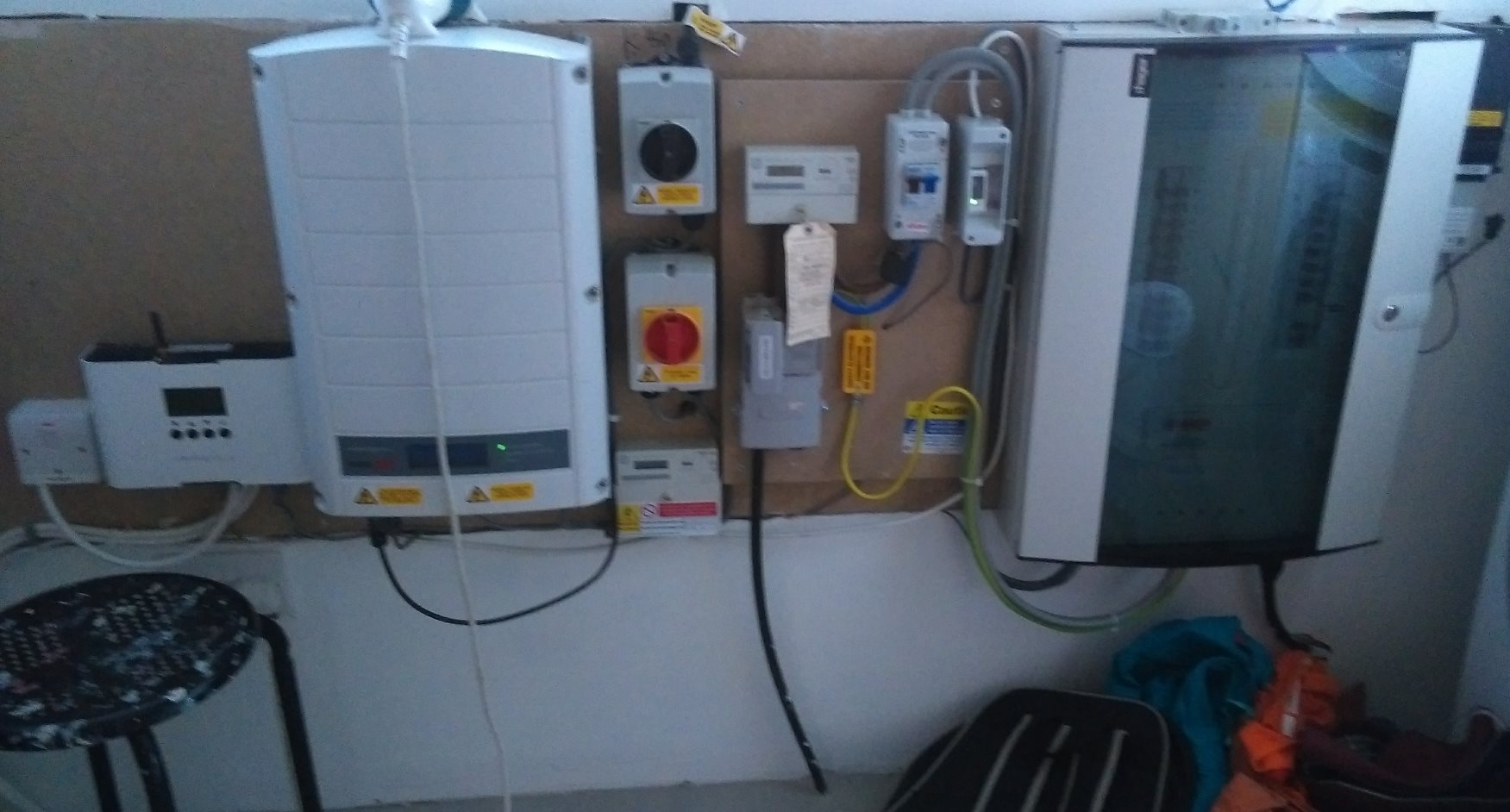

ragg987 Posted August 24, 2017 Posted August 24, 2017 It depends on the DNO. Our supplier (UKPN) stipulates that all new supplies can only be connected to an external meter point, not inside the house, and require a regulations box (horrible grey fibre-thingy which I did not want on my shiny new render exterior)). I argued that ours was not a new supply but a move of an existing one based on demolition and construction, they conceded after a lengthy discussion and an appeal to a manager, and installed it indoors provided I gave space for maintenance at the supply point. Interestingly, they did not require a meter box and just wanted a bit of board to mount their bits on. Our supply is open in the utility room. From left to right: PV stuff: Immersun, inverter, isolators and meter Incoming mains stuff: termination, fuse, meter, isolator (note cable coming up through the screed from the basement, we came into the basement underground and used waterproof cement to close off and make it airtight) sub-meter for ASHP measurement purposes DB (Hager 3-phase unit but used for a single phase - this confused the DNO as they expected to fit single phase supply and saw a 3-phase box on site) controller for movement sensor lighting. 1

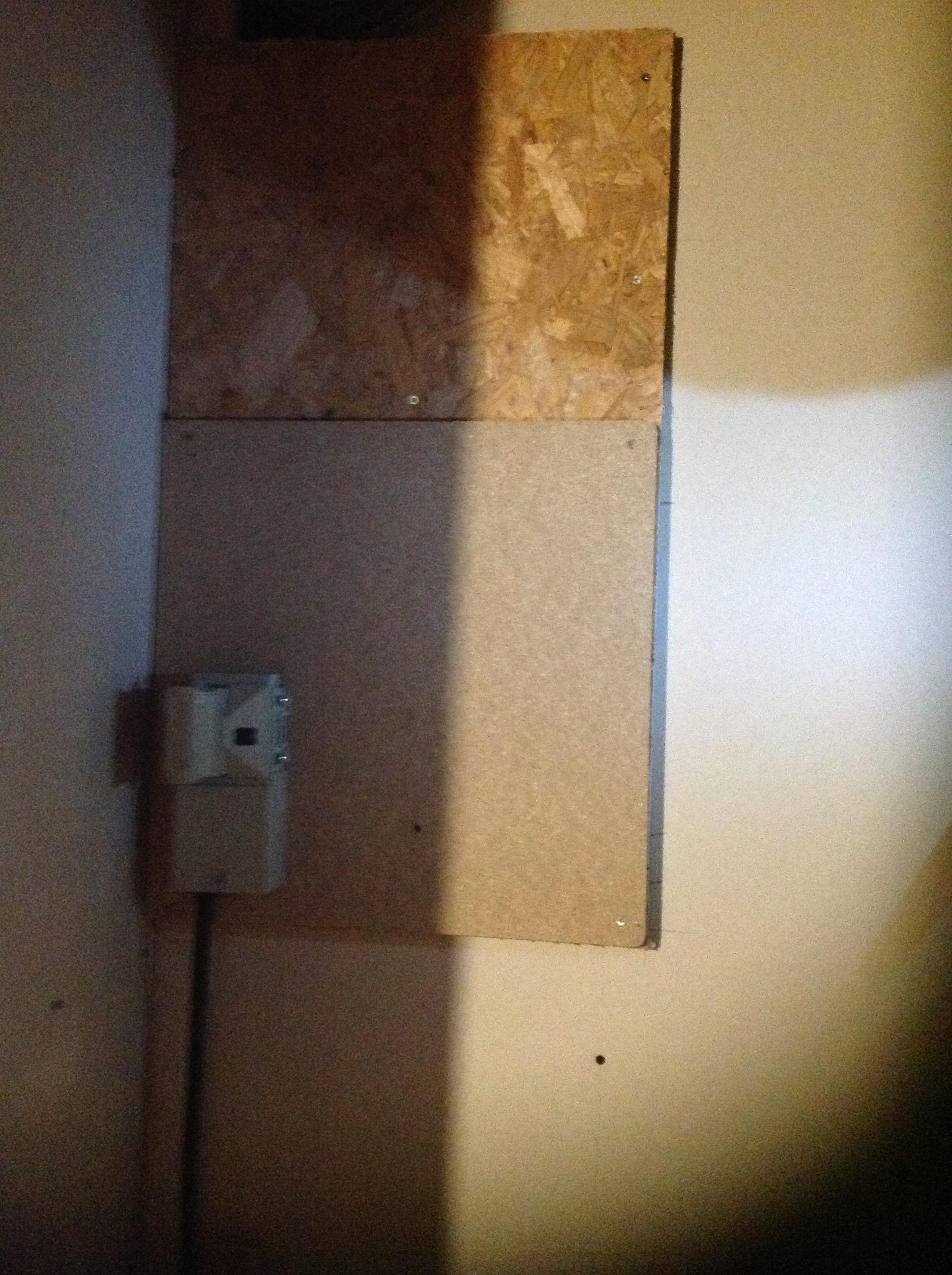

Crofter Posted August 28, 2017 Posted August 28, 2017 Ok, so I have SSE coming this week to install the supply (but not meter). I presume I will need to put something on the wall above where the duct comes out. Just reinforce it to take their own board? Or fix my own board, and if so would a piece of P5 chipboard be OK? Or fix my bit of chipboard to the wall, and then they can screw their board into that if they like? (I'm sure they must have told me this but there's been so many emails back and forth that I can't find it again!)
Crofter Posted August 31, 2017 Posted August 31, 2017 Bumpety bump... I did find the email from SSE and it just says I have to supply the meter board, they gave dimensions, but not what it should be made of. Any suggestions ( @ProDave ?) , before I screw a piece of 22mm chipboard to the wall? They're coming tomorrow so need to do something...
jack Posted August 31, 2017 Posted August 31, 2017 SSE was happy to mount our internal meter on chipboard (not 22mm - more like 10 or 12, I think).
Crofter Posted August 31, 2017 Posted August 31, 2017 22 minutes ago, jack said: SSE was happy to mount our internal meter on chipboard (not 22mm - more like 10 or 12, I think). Thanks I can't see why 22mm would be a problem in any way? And I've come across references to having the board spaced off the wall, not sure what that's about and I didn't see anything the bumph that SSE sent me.

Crofter Posted August 31, 2017 Posted August 31, 2017 Having sorted through my pile of offcuts, I don't actually have a big enough piece of chipboard after all... I could put two smaller bits side by side? Or use 11mm osb? Or 9mm ply?? (Sometimes it sucks leaving things till the last minute when you are on site on your own and have no car- can't just nip into the BM for silly little things like this!)

ProDave Posted August 31, 2017 Posted August 31, 2017 I have used chipboard and MDF in the past. As long as they can drive a wood screw into it I don't think they care. The standard meter boxes have a piece of very cheap feeling thin chipboard. An offcut of chipboard flooring would be miles better. 1

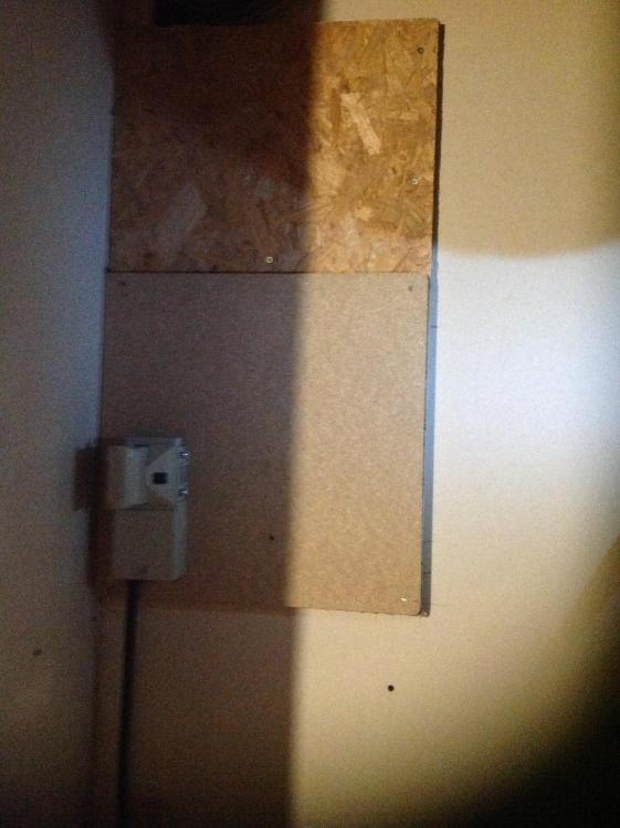

Crofter Posted September 3, 2017 Posted September 3, 2017 Just to update, SSE came round and were quite happy with what they found. They did stick their own bit of board over my double layer of OSB. Sorry for poor photo- it's on a cupboard with no lighting. They did say I ought to shield the cable with something, but it's just PB behind it so I can't just stick on any old thing. They mentioned there was some sort of self adhesive guarding available. Now I have my MPAN, so any tips on choosing a supplier? I want to have E7 if that makes any difference. 1

Onoff Posted September 3, 2017 Posted September 3, 2017 Did they mean this sort of "cover"? https://www.tlc-direct.co.uk/tcl/search?query=cable+gaurd&Submit=Search
