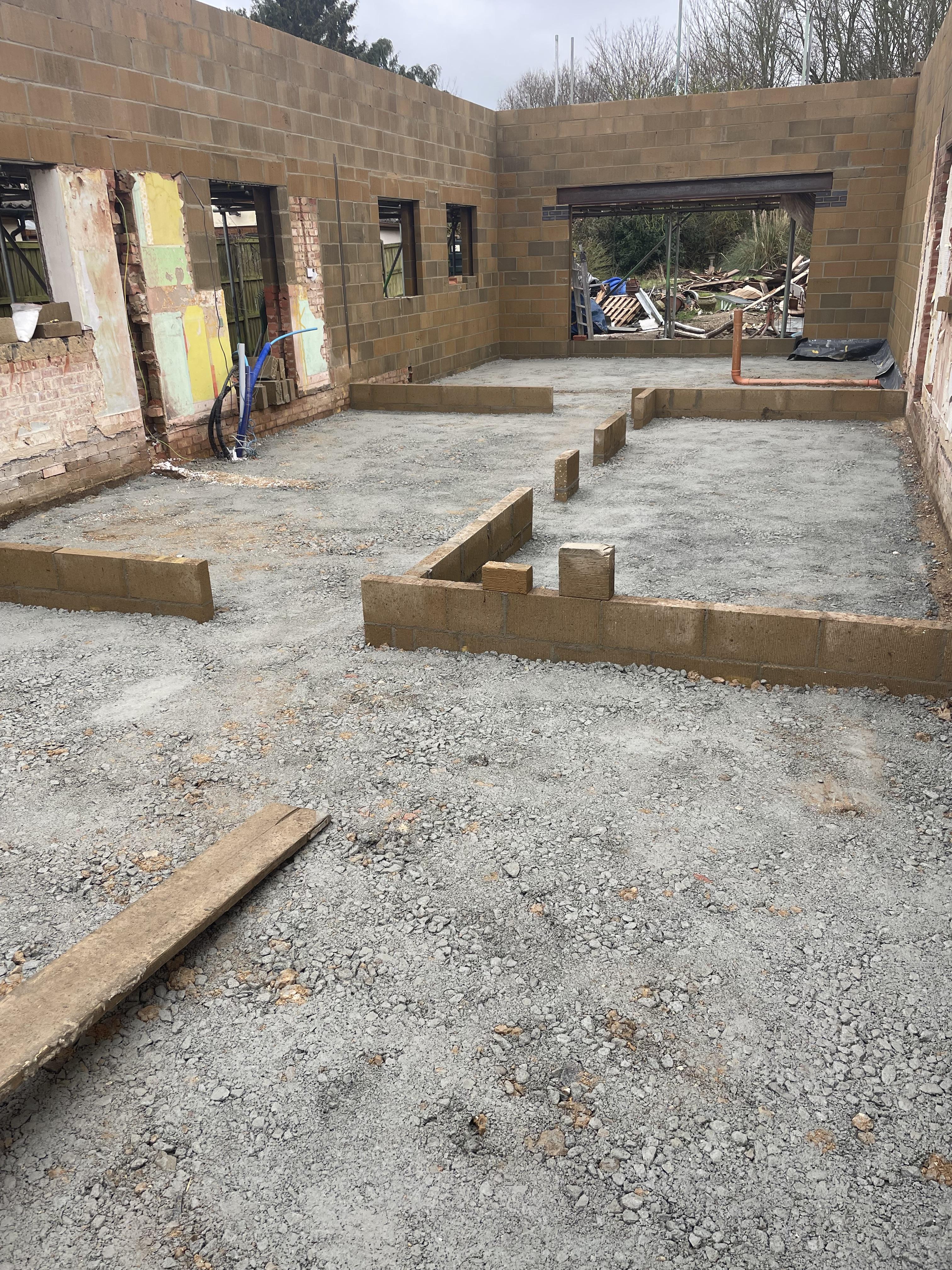

LiamJones Posted February 12, 2024 Share Posted February 12, 2024 I’m not the original poster, but in a similar situation, I have ended up getting a structural engineer involved for £1k to design be a steel ridge beam £2k for the rafter to be hung on. Get full height ceiling upstairs and velux can go wherever we want. Attic trusses were more expensive, less flexible but would have been quicker. Link to comment Share on other sites More sharing options...
rangerovering Posted February 12, 2024 Share Posted February 12, 2024 40 minutes ago, LiamJones said: I’m not the original poster, but in a similar situation, I have ended up getting a structural engineer involved for £1k to design be a steel ridge beam £2k for the rafter to be hung on. Get full height ceiling upstairs and velux can go wherever we want. Attic trusses were more expensive, less flexible but would have been quicker. Interesting, are you going to get the gables prepped for the ridge before the rest of the roof comes off? Link to comment Share on other sites More sharing options...
LiamJones Posted February 12, 2024 Share Posted February 12, 2024 41 minutes ago, rangerovering said: Interesting, are you going to get the gables prepped for the ridge before the rest of the roof comes off? Roofs already off. We’ve pretty much started again Link to comment Share on other sites More sharing options...
rangerovering Posted February 12, 2024 Share Posted February 12, 2024 Oh looks like a new build more or less! Link to comment Share on other sites More sharing options...
