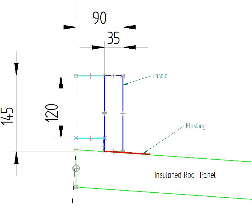

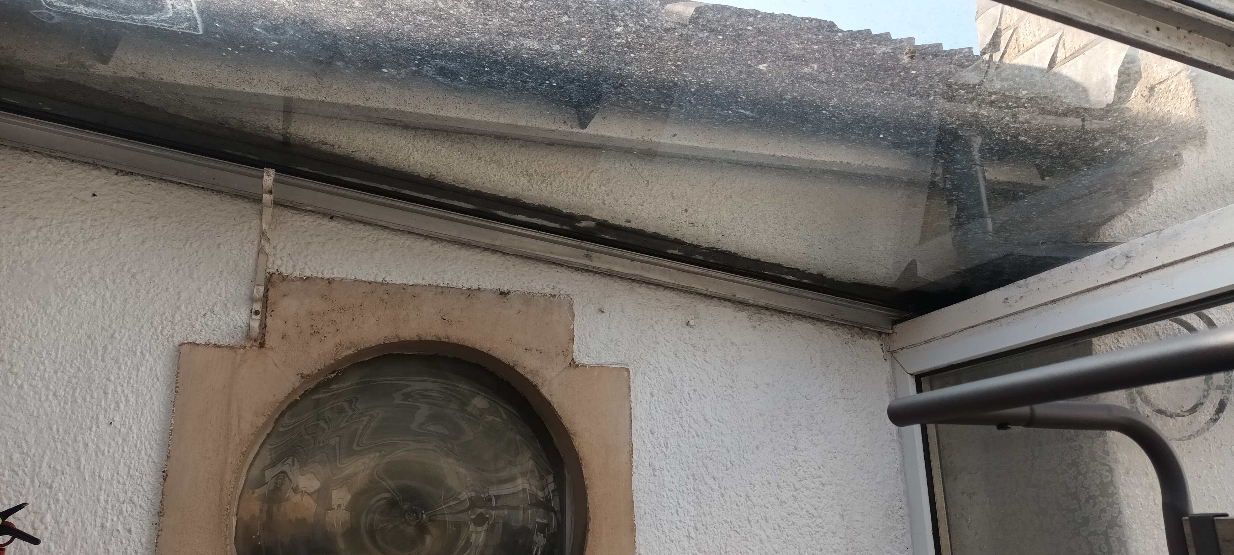

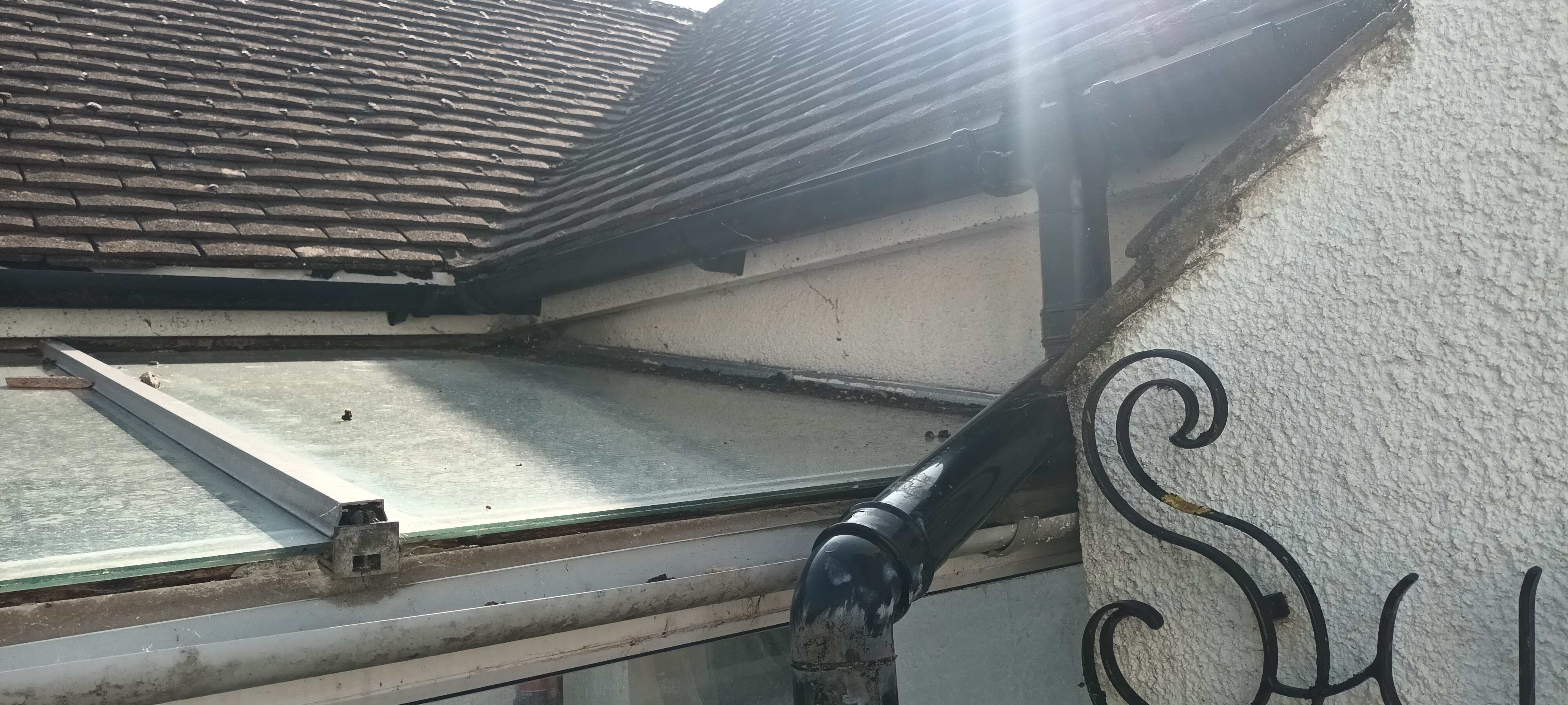

  1. That would be a much simpler solution. I'll research the lead replacement option.
  2. I was going to use a flexible flashing (Flashband?) The panel manufacturer says they can make a custom flashing for the lean-to top ridge. The ridged profile of the roof panel means though that it wouldn't be sealed against the full width...
  3. DIY. My assumption is that I need to remove a band of the Roughcast to get the flashing against the wall. The question is then: Flashbanding against the wall and over the roofing panel? Or cut a shallow angled chase for a metal flashing? Or a stepped lead flashing? Or...? Any advise would be much appreciated.
  4. Just about to remove the old glass porch roof and replace with composite insulated panels. The roof is a lean-to nestled in the crook of the L-shaped house. Thus, the verge abuts a rendered wall. Any suggestions on how to flash this join?
