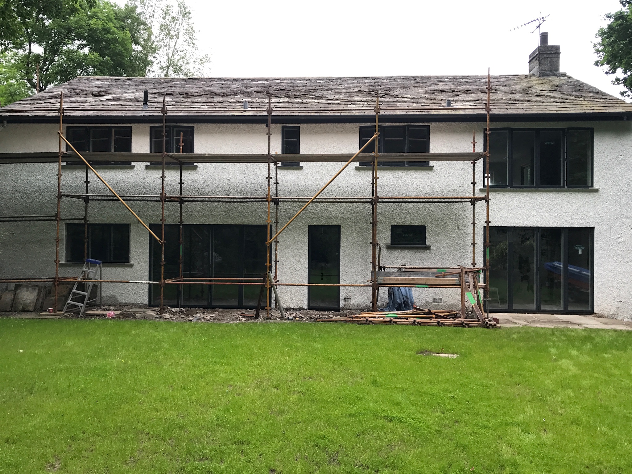

soapstar Posted August 22, 2017 Share Posted August 22, 2017 (edited) Hey folks, So we are still in the building warrant drawing stage so we have lots of spec we need to decide on for our house, one being wooden or PVC windows. Can anyone offer any advice on choosing between these two materials? From research I have gathered the obvious in that PCV is cheaper from the outset and needs less maintenance, however wooden frames can last longer (repairable) but require regular upkeep. I have also been informed that by using PVC windows in a conservation area (which our house will be in) seriously reduces the value of the house. From what i am aware there is no 'rule' in our area against using PVC windows. I have attached a picture to show the look and feel of what we are trying to achieve - we will have dormer windows in our 1.5 story. And we also will have a large front facing window as in the picture - would this effect our choice? I would also like to point out we are quite close to the coast - perhaps something to consider? Aluminium is also something I was looking at being hard wearing, has anyone had any experience with this? Any advice, pictures or past experiences would be great! Edited August 22, 2017 by soapstar Link to comment Share on other sites More sharing options...

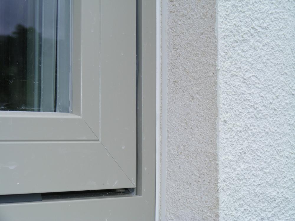

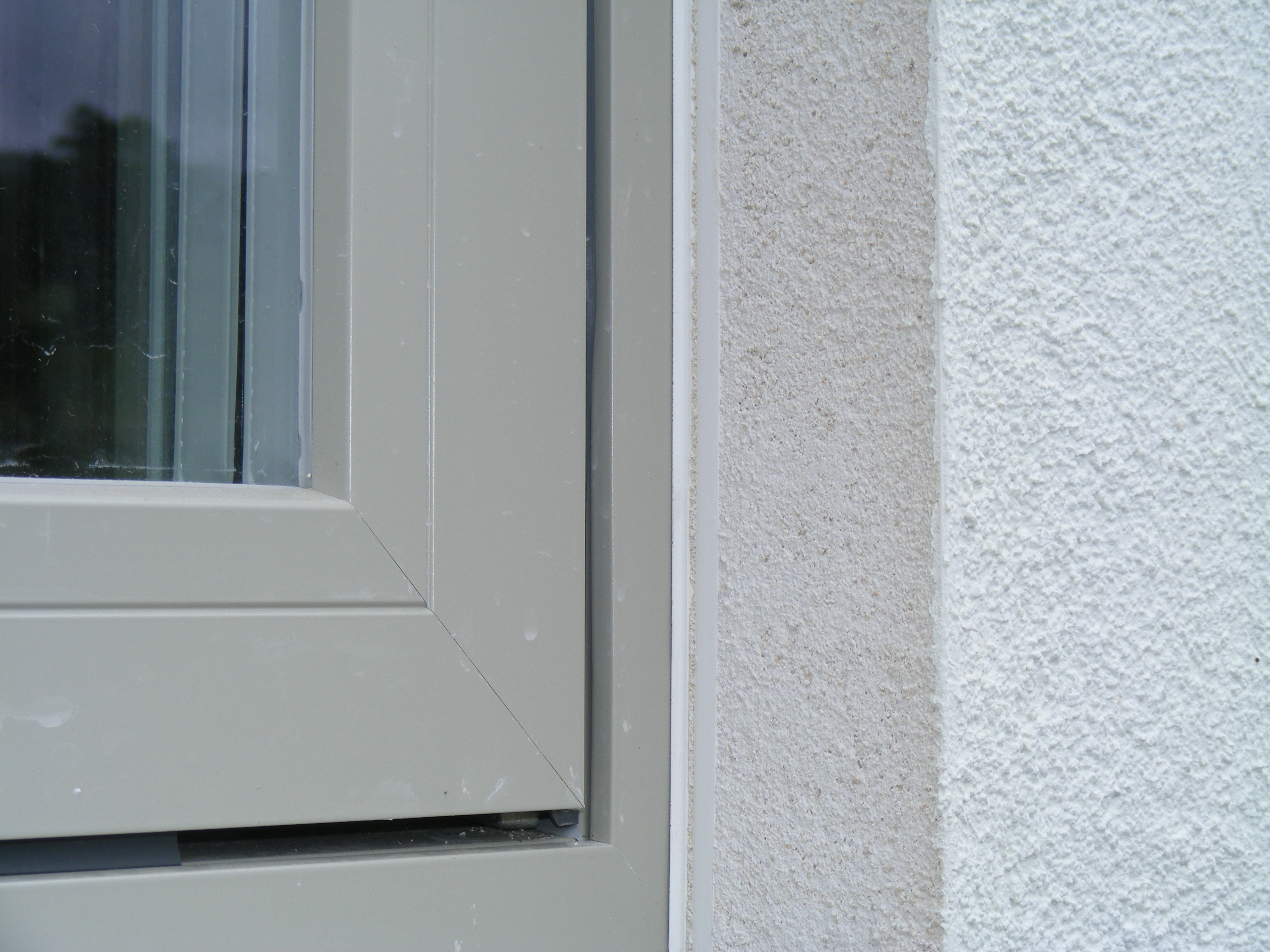

ProDave Posted August 22, 2017 Share Posted August 22, 2017 1 hour ago, soapstar said: Thanks. Never knew aluminium clad was an option! Cost wise are these much more expensive than wooden frames? Dont suppose you have any pictures of your frames, would be interesting to see the colour/texture you went with. It seems the consensus from looking around that wooden frames are a pain in the a**, however I do like the natural look of wood (as does everybody else who buys them and realises the mistake they have made by the sounds of it!) Here is a close up of one of the frames. That's an opening window, I like the crisp clean unfussy lines. That's a smooth "pebble grey" finish. I think you can have any RAL colour you like and a textured paint is an option. I never did directly compare the cost of ali clad Vs just wood so can't comment on the extra cost. 2 Link to comment Share on other sites More sharing options...

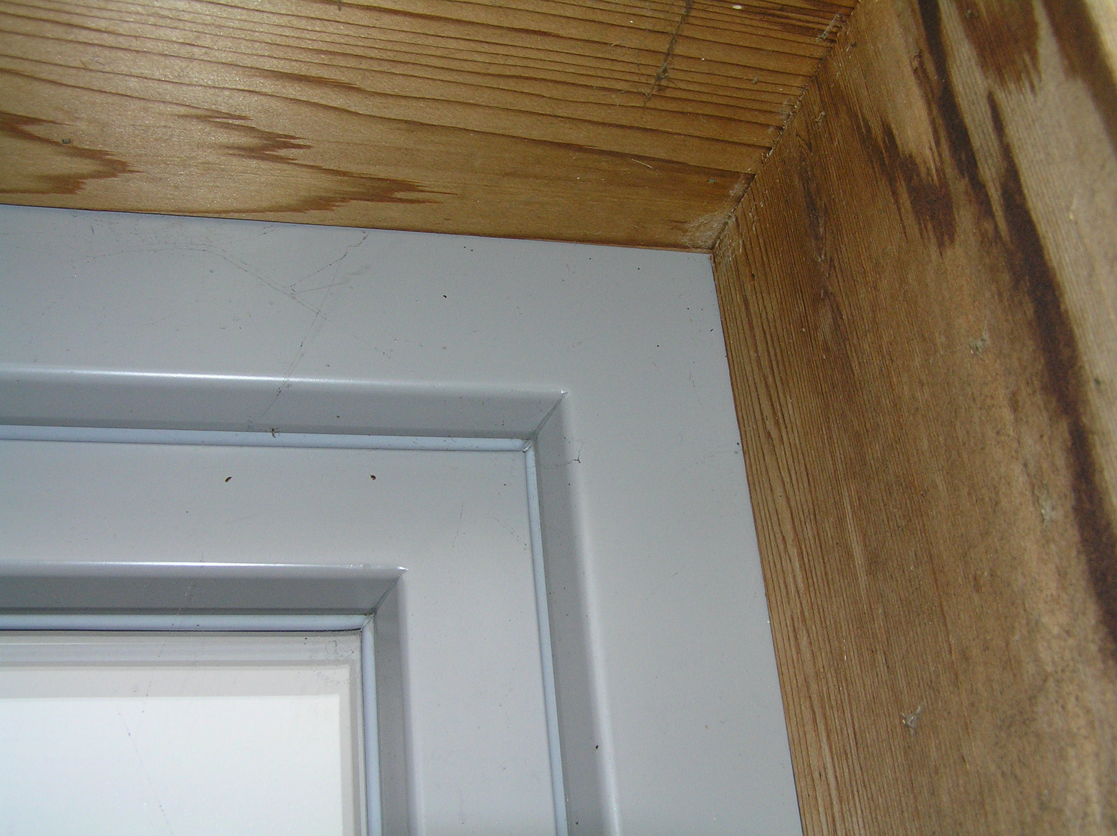

Gone West Posted August 23, 2017 Share Posted August 23, 2017 My windows are Rehau Geneo and are made from RAU-FIPRO which is a fibre reinforced uPVC. They can be painted any RAL colour and most people think mine are aluminium. Excuse the dirt. 2 Link to comment Share on other sites More sharing options...
