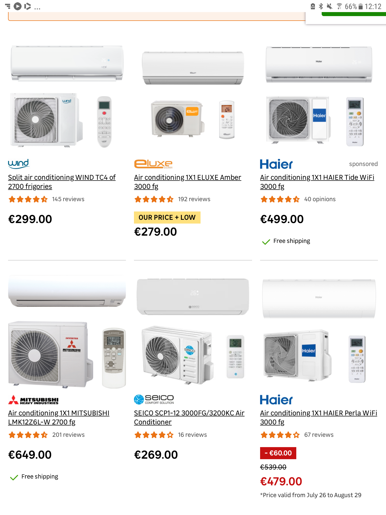

Beelbeebub Posted August 6, 2023 Author Share Posted August 6, 2023 10 minutes ago, JamesPa said: With open plan becoming more popular A2A becomes more attractive to my mind. Even where living areas aren't open plan (as in my house for example) doors are often left open. However most don't have open plan bedrooms and also value quiet in these areas. The combi of A2A for living areas, where most of the heat demand is, and A2W for bedrooms, where the demand is lower and other considerations come into play, might be attractive if it could be well packaged. Probably too complex to be practical though. This is what I mean by ecosystem. If they sold a "manifold", basically a large shoe box with a water pump small expansion vessel and a PHX plus ports for refrigerant and a hydraulic flow/return, then you could connect whatever system you wanted to your outdoor unit. UFH, few rads, whatever. The UFH bit is important as I think, with it's very low flow temps, it's about the most efficient emitter system you can get, but there is no way to use it with refrigerant directly. Link to comment Share on other sites More sharing options...
Beelbeebub Posted August 6, 2023 Author Share Posted August 6, 2023 The other ones to consider are the "through the wall" individual units. Only 1 or 2 kw, but retrofit could be easier in some circumstances (external walls available and especially high properties like flats) with little external visual impact. A really clever design would double as MHRV Currently I think they are a bit too expensive - no cheaper than a single split system with less efficency and power. If they could be got down to the £500 for a 2kw unit range, they would be very viable. Link to comment Share on other sites More sharing options...
SteamyTea Posted August 6, 2023 Share Posted August 6, 2023 23 minutes ago, Beelbeebub said: The other ones to consider are the "through the wall" individual units As a thought experiment, why don't we collectively design one. I wonder what the power of the AC unit in my car is. There are millions of them about. Link to comment Share on other sites More sharing options...
JamesPa Posted August 6, 2023 Share Posted August 6, 2023 Sounds like a good idea and fun too. We could offer the result to cool energy. Ditto for the solution to some of the other problems we have identified! Perhaps we should start with a list? Link to comment Share on other sites More sharing options...

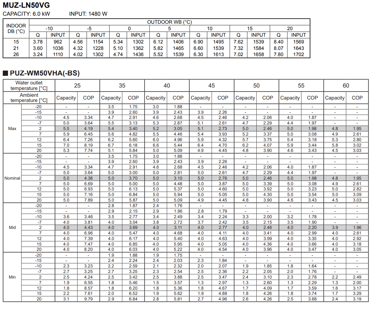

saveasteading Posted August 6, 2023 Share Posted August 6, 2023 1 hour ago, Beelbeebub said: If they could be got down to the £500 for a 2kw unit range, These are very common for diy on the med. Can be very cheap for unknown or own brands, and double for known names. They are designed for cooling though, and the heating coefficient is usually about 2.5. I dont know if that is readily swappable so the heating is the more efficient. Link to comment Share on other sites More sharing options...
Beelbeebub Posted August 6, 2023 Author Share Posted August 6, 2023 16 minutes ago, saveasteading said: These are very common for diy on the med. Can be very cheap for unknown or own brands, and double for known names. They are designed for cooling though, and the heating coefficient is usually about 2.5. I dont know if that is readily swappable so the heating is the more efficient. I think there is no reason the units can't be optimised for heating efficiency. It's just a question of world wide demand, with cooling being the bigger market. Link to comment Share on other sites More sharing options...
SteamyTea Posted August 6, 2023 Share Posted August 6, 2023 48 minutes ago, saveasteading said: They are designed for cooling though, and the heating coefficient is usually about 2.5. Possibly because of the temperature differences. Take the South of France, not unusual to se 35°C. Take the inside temperature way, say 22°C, that is 13K difference. In the UK, during the heating season, that would be an outside temperature of 9°C. There could possibly be defrost cycles when heating. Link to comment Share on other sites More sharing options...
DanDee Posted August 6, 2023 Share Posted August 6, 2023 15 minutes ago, SteamyTea said: Possibly because of the temperature differences. Take the South of France, not unusual to se 35°C. Take the inside temperature way, say 22°C, that is 13K difference. In the UK, during the heating season, that would be an outside temperature of 9°C. There could possibly be defrost cycles when heating. From mitsubishi, both same compressor size. the AC loses efficiency due to the length of line set, both by losing temp and higher workload to achieve the same condensing pressure the A/W has a compact refrigeration system, bigger evaporator, refrigerant receiver to optimize the unit The AC is sold world wide, the A/W not so much. £1.5K vs £2.5-3k Link to comment Share on other sites More sharing options...
