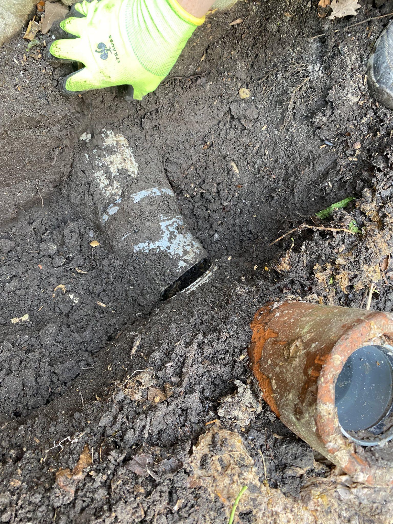

vagrantly3893 Posted August 4, 2023 Share Posted August 4, 2023 (edited) Our toilet was draining very slowly and we discovered that part of the waste pipe is falling towards the property. I'm going to adjust it so it is falling away, but how can I achieve this so the pipe doesn't fall back? The pipe is currently in soil 60 cm down. Should I simply put soil back under the pipe after adjusting, or perhaps something like gravel or sand to hopefully prevent any future sinking? Edited August 4, 2023 by vagrantly3893 Link to comment Share on other sites More sharing options...

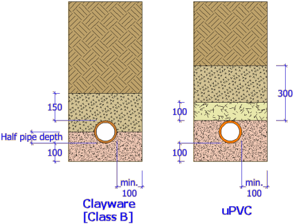

Temp Posted August 5, 2023 Share Posted August 5, 2023 15 hours ago, vagrantly3893 said: Our toilet was draining very slowly and we discovered that part of the waste pipe is falling towards the property. I'm going to adjust it so it is falling away, but how can I achieve this so the pipe doesn't fall back? The pipe is currently in soil 60 cm down. Should I simply put soil back under the pipe after adjusting, or perhaps something like gravel or sand to hopefully prevent any future sinking? It should already be bedded on/in pea gravel. I would lift that section and a further 100-150mm down. Compact any loose ground using something like a fence post to pound it down. Fill with gravel raked to give you the required fall. Fit pipe and pour more gravel to cover it. https://www.pavingexpert.com/drain02 Quote The pipe should be settled into the bedding or have the bedding packed beneath it until it is at the correct alignment and level as indicated by the guide line (string or laser). 1 Link to comment Share on other sites More sharing options...

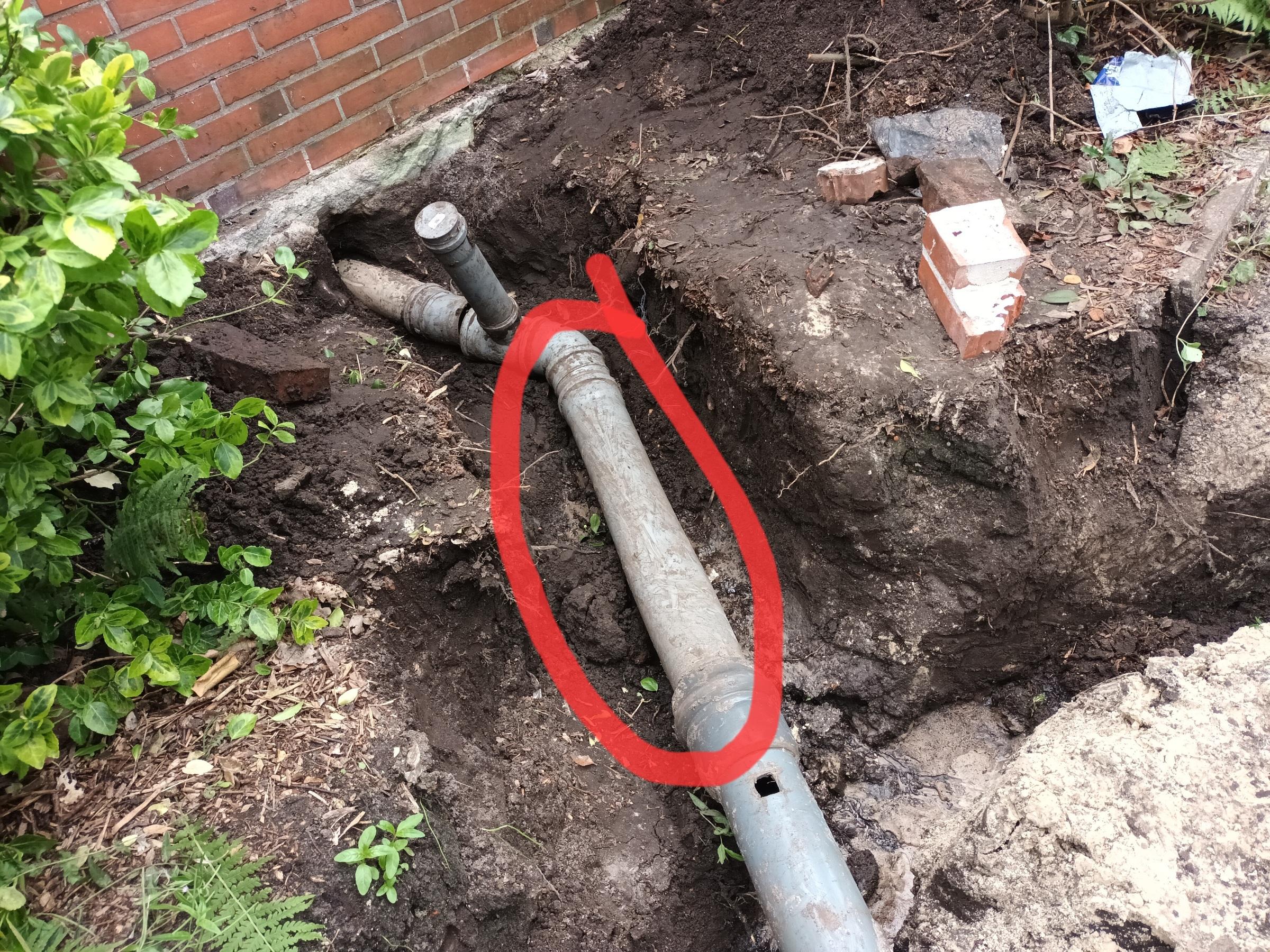

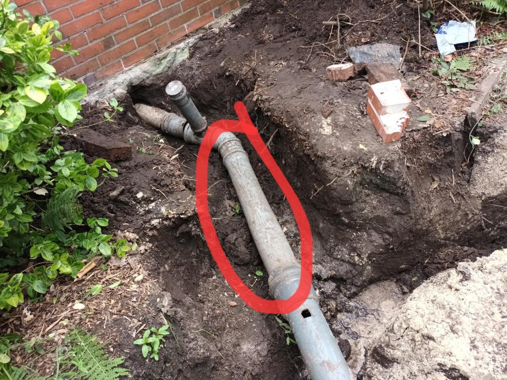

vagrantly3893 Posted August 5, 2023 Author Share Posted August 5, 2023 6 hours ago, markc said: How did you discover the reverse fall? CCTV? Unless you have already done so check the available fall to next inspection point or manhole (should it be personhole now?) Got some pics now. The red section has sagged and even has a dent on the top. No gravel under or around the pipe. The connection closest to the house was also loose. Plumber will be back in Monday and will probably replace everything from the house to the start of the long section (the part with the small hole in the top). Link to comment Share on other sites More sharing options...
Conor Posted August 5, 2023 Share Posted August 5, 2023 You should put an inspection chamber at that bend and get rid of that vertical pipe, whatever it's doing there. 1 Link to comment Share on other sites More sharing options...
vagrantly3893 Posted August 5, 2023 Author Share Posted August 5, 2023 2 minutes ago, Conor said: You should put an inspection chamber at that bend and get rid of that vertical pipe, whatever it's doing there. I assumed that was an inspection chamber. I'm also not sure why it's there though. Link to comment Share on other sites More sharing options...
markc Posted August 5, 2023 Share Posted August 5, 2023 Agree with @Conor the whole section looks pretty poor so you mayas well do it right, I would also be replacing the next section as a minimum, guessing the hole is from a pick. 1 Link to comment Share on other sites More sharing options...
Conor Posted August 5, 2023 Share Posted August 5, 2023 It's a bodge. I'm not even sure that that grey pipe is underground rated, it's normally orange/brown. I'd take it all out. 3 Link to comment Share on other sites More sharing options...
Nickfromwales Posted August 5, 2023 Share Posted August 5, 2023 1 hour ago, Conor said: It's a bodge. I'm not even sure that that grey pipe is underground rated, it's normally orange/brown. I'd take it all out. +1. 1 Link to comment Share on other sites More sharing options...
Temp Posted August 5, 2023 Share Posted August 5, 2023 +2 Most underground pipe is brown/orange and stronger, more rigid than the grey indoor pipe. Might explain the dent? 1 Link to comment Share on other sites More sharing options...
vagrantly3893 Posted August 5, 2023 Author Share Posted August 5, 2023 (edited) 3 hours ago, markc said: Agree with @Conor the whole section looks pretty poor so you mayas well do it right, I would also be replacing the next section as a minimum, guessing the hole is from a pick. The hole was from the plumber during investigation. That part of the pipe just happened to be exposed because we dug a trench for an electric cable recently. I dug up everything else today. 2 hours ago, Conor said: It's a bodge. I'm not even sure that that grey pipe is underground rated, it's normally orange/brown. I'd take it all out. 8 minutes ago, Temp said: +2 Most underground pipe is brown/orange and stronger, more rigid than the grey indoor pipe. Might explain the dent? Wouldn't surprise me considering what the previous owner has done elsewhere. Worth mentioning however that I am in Germany so grey pvc pipe for outdoor burial is common. Edited August 5, 2023 by vagrantly3893 1 Link to comment Share on other sites More sharing options...

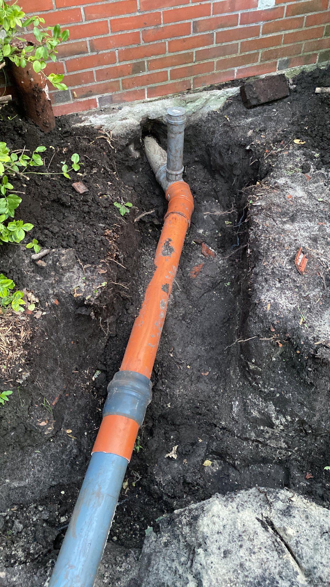

vagrantly3893 Posted August 7, 2023 Author Share Posted August 7, 2023 Here is the plumber's solution 1 Link to comment Share on other sites More sharing options...
TonyT Posted August 7, 2023 Share Posted August 7, 2023 He’s not a plumber, he’s a chancer time to bin him and find some decent trades before this buried and causes you no end of problems 1 Link to comment Share on other sites More sharing options...
Nickfromwales Posted August 7, 2023 Share Posted August 7, 2023 The transition from ‘old to new’ seems odd, which may have left a step inside the pipe. Hard for us to comment / judge tbh as these are German standards and fittings not UK. 1 Link to comment Share on other sites More sharing options...
vagrantly3893 Posted August 7, 2023 Author Share Posted August 7, 2023 1 minute ago, Nickfromwales said: The transition from ‘old to new’ seems odd, which may have left a step inside the pipe. Hard for us to comment / judge tbh as these are German standards and fittings not UK. Yes I need to check if that is a step or if it's just some orange pipe fitted over the existing pipe because there was a small hole in the top. 5 minutes ago, TonyT said: He’s not a plumber, he’s a chancer time to bin him and find some decent trades before this buried and causes you no end of problems What would the ideal solution look like? Thanks Link to comment Share on other sites More sharing options...
TonyT Posted August 7, 2023 Share Posted August 7, 2023 Ah didn’t appreciate you were in Germany. will take some of my comments back, maybe not, still looks rough.. 1 Link to comment Share on other sites More sharing options...
vagrantly3893 Posted August 7, 2023 Author Share Posted August 7, 2023 2 minutes ago, TonyT said: Ah didn’t appreciate you were in Germany. will take some of my comments back, maybe not, still looks rough.. Yeah I thought he would replace everything from the house to the existing long grey pipe. But I wasn't there today to discuss with him. Link to comment Share on other sites More sharing options...
Dave Jones Posted August 8, 2023 Share Posted August 8, 2023 if it was England, all they grey shite needs ripping out and replacing with underground drainage to a proper fall with a chamber on any change in direction. 1 Link to comment Share on other sites More sharing options...
Conor Posted August 8, 2023 Share Posted August 8, 2023 12 hours ago, vagrantly3893 said: Yes I need to check if that is a step or if it's just some orange pipe fitted over the existing pipe because there was a small hole in the top. What would the ideal solution look like? Thanks All the grey pipes and joints replaced with orange. An inspection chamber where the bend is. Pipes supported on a bed of fine stone <10mm (or whatever the local requirement is) and covered with same before backfilling. Tbh it's more of a job for a groundworker than a plumber. No offense to any competent plumbers reading this 🤣 It'll cost you more now, but will save you the hassle of digging it all up again in a few years time. 1 Link to comment Share on other sites More sharing options...

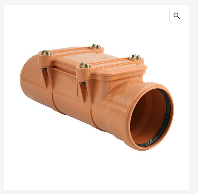

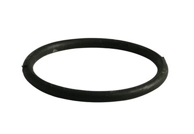

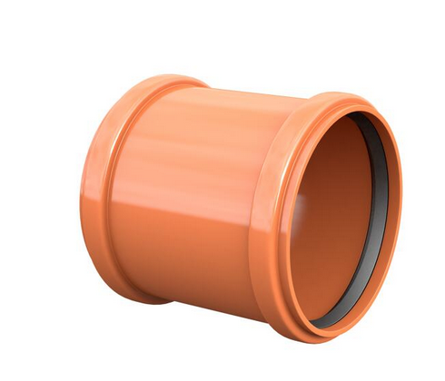

vagrantly3893 Posted August 11, 2023 Author Share Posted August 11, 2023 (edited) On 08/08/2023 at 09:50, Conor said: All the grey pipes and joints replaced with orange. An inspection chamber where the bend is. Pipes supported on a bed of fine stone <10mm (or whatever the local requirement is) and covered with same before backfilling. Tbh it's more of a job for a groundworker than a plumber. No offense to any competent plumbers reading this 🤣 It'll cost you more now, but will save you the hassle of digging it all up again in a few years time. Thanks. The existing grey sleeve is still dripping a little. A drop every couple of seconds. So my plan is to replace the grey inspection chamber with this: And replacing the grey sleeve with this: Where the connections are made, is a seal also required? Edited August 11, 2023 by vagrantly3893 Link to comment Share on other sites More sharing options...
Conor Posted August 11, 2023 Share Posted August 11, 2023 do it right: https://www.drainagesuperstore.co.uk/help-and-advice/product-guides/underground-drainage/what-is-an-inspection-chamber/ 1 Link to comment Share on other sites More sharing options...
