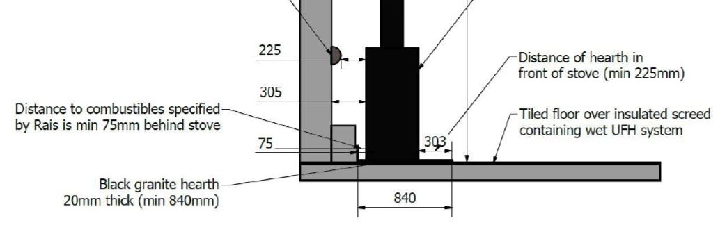

Alan Ambrose Posted July 31, 2023 Posted July 31, 2023 (edited) These are the sort of distances you're looking at, both for the 'rules' and for practical safety, but as others have said ... you need to check both the BC rules and those for the stove you're thinking of selecting. This drawing clip is for a Rais Viva 100L: p.s. plasterboard, in these calcs is not a 'combustible', wood for instance is. Edited July 31, 2023 by Alan Ambrose 1

Alan Ambrose Posted August 1, 2023 Posted August 1, 2023 If I was fussed, I could see using cement board or stainless (or even standard) steel sheet, the former (plastered and?) painted the latter powder coated. FWIW I fired up the damn thing to max for a few hours after it was installed and measured the temperatures on all the nearest points - there's 'meets the regs' and there's 'should be safe' - not necessarily the same thing. That also, kept the BCO happy - don't think he had even seen an installer do that before. FYI we used a nest smoke/CO detector rather than one of the crappy battery operated things. 1
