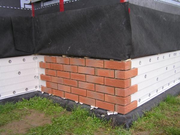

3 hours ago, Tom said:
a plinth running around the base, approx 30cm high, that I plan to clad in a cement board
This height of plinth is nigh on invisible in its context. I usually have this detail whether poured concrete or blockwork, painted in blackjack, and it then does become un-noticeable.
Nobody has ever, to my knowledge, remarked on the plinth at all (dozens/hundreds of projects).
Link to comment
Share on other sites
Agree render or brick slips is probably the done thing but that Easyboard stuff, if it's appropriate, would be far cheaper than render etc at only £10 a board - and easily DIY-able. Could do a 40cm high plinth and get a 2.4m run out of each board. Would be good to see the board in person before pulling the trigger, though would only be a £350 gamble for our 85m perimeter...
Link to comment
43 minutes ago, markharro said:
but I dont think Blackjack would be compatible with the EPS we not to cover/hide?
 you are correct. I wasnt paying attention that it was eps.
Normal cement board will be fine then black.
Or maybe try a masonry paint direct on the eps? I've used it on osb when solvents in other paints have dissolved the binders. Try on an offcut
You'd think a system like nudura would have resolved this.
