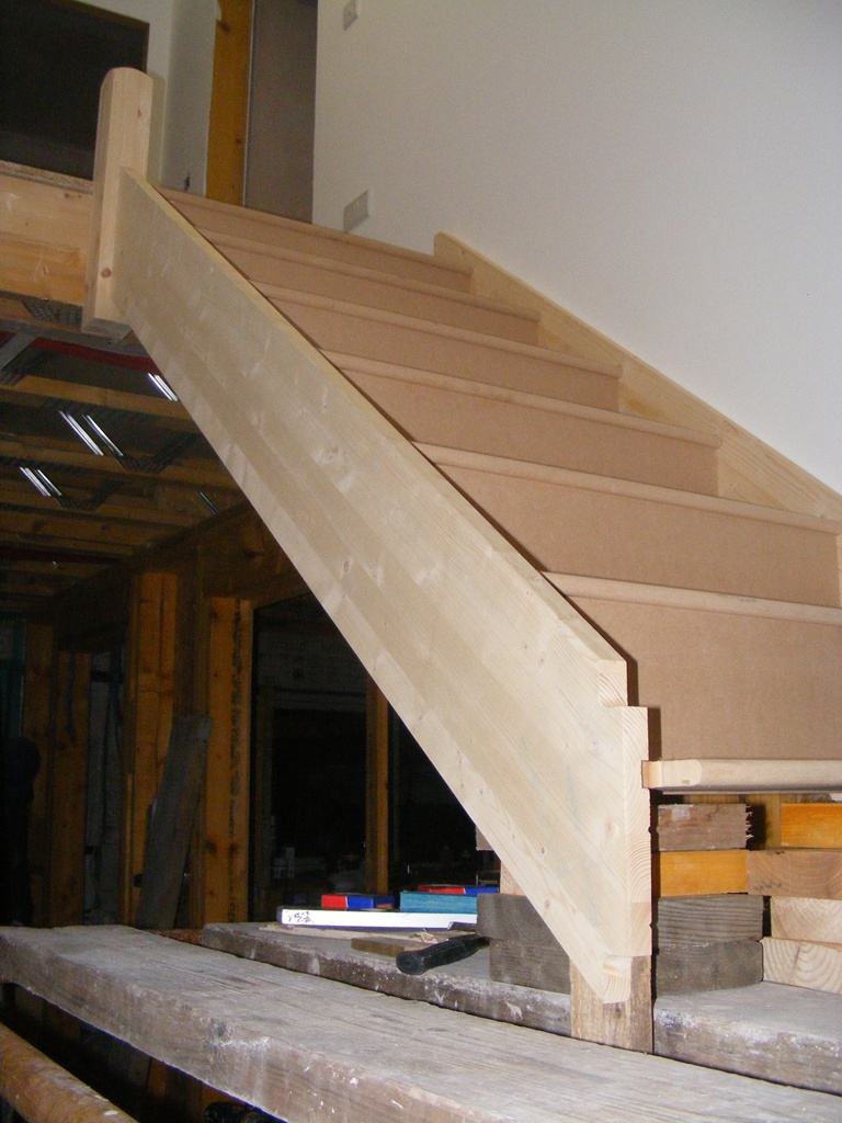

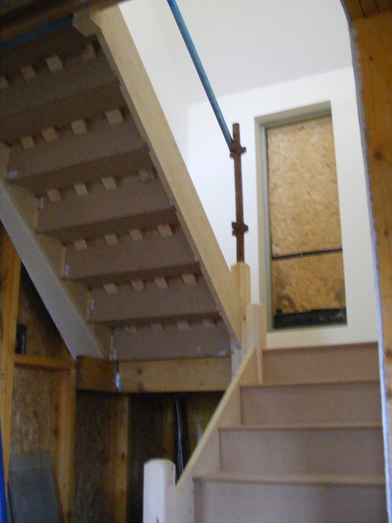

November 6, 20179 yr Author Well my stairs arrived from Staribox today. Managed to get the top flight in. Unfortunately there is a problem with the two newel posts that join the top and bottom flight. They don't fit and they have finished the top detail incorrectly. I have emailed stairbox with pictures. Unfortunately, until that is resolved I can't fit the lower flight (which in itself looks correct)
December 3, 20178 yr Author All finished now. There is a blog entry at the usual place http://www.willowburn.net/ Look for the entry "the stairs are in" It took 2 iterations to get all the correct set of parts. The first replacement pair of newel posts one was fine but the other did not have the rounded top detail for the Fusion system handrails, so that had the be re made a second time adding to the delay before I could complete the installation. But now it's finished, apart from handrails of course they will be much later.
