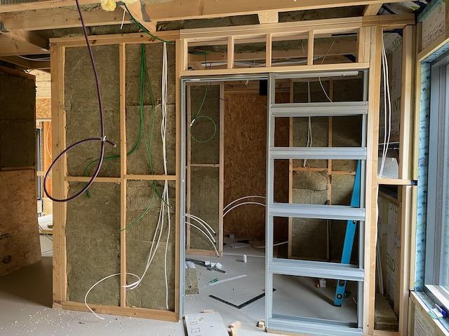

I am looking for some advice on pocket sliding doors. I am in the process of putting all the stud walls up in a new build and trying to decide on whether to use standard or sliding doors.
I have 15 doors in total and the kits I’ve looked at are around £200. I don’t really won’t to pay 3k for the kits, so if this is the only option, I’ll go down the standard door route.
I had a quick chat with a carpenter and he said you don’t need the kits, just good quality parts/fixings.
I just want to know if these can be framed without the kit and if so, are they still quality, or is it just a bodge job.
Thanks.

we had 3 pocket doors designed. in the end we converted 2 of them to normal doors as they were in an en-suite and we discovered that we couldn't get the electrics to the towel rail we wanted to hang on the back of the frame nor could we put the light switch for the bathroom on the side we wanted. so, just be aware that you won't be able to fit light sockets or cable runs safely within the frame.
and it may be that you only need good quality parts and fixings but the Eclisse pocket doors are so simple to put up (took my carpenter and me about 30 minutes tops) that you need to consider the labour costs of NOT using a kit and calculate if it's still worth not using a kit.

I've just spoken with the chippie again and he has given me a bit more info. He said that the kits vary in thickness, but as he doesnt use the steel wrapped timber studs, he works with a 120mm thick stud wall. He rips down all the timber to 35mm on the table saw, fixes these top and bottom, which gives a 50mm void for the door. He believes that doing it this way gives a sturdier wall, compared to the kits and costs a fraction of the costs.
This seems pretty straight forward for me, but I'm wondering if this wall will be sturdy enough. I may just try 1 and see, unless somebody can confirm it on here.
I'm wondering why pipes, cables and sockets/switches/back boxes can't be used between the 35mm stud or is it that your kits use much thinner steel wrapped studs.

according to my sparky and chippy there just isn't space to fit a back box in the Eclisse metal frames and even though you could potential run a cable in a gap we all thought that the risk of it catching on the door and causing issues was too high to justify it. so we just built out the timber wall to hold standard doors instead. still have one Eclisse pocket door though as I said. I just fitted the header wall above the door today as a matter of fact. 🙂
