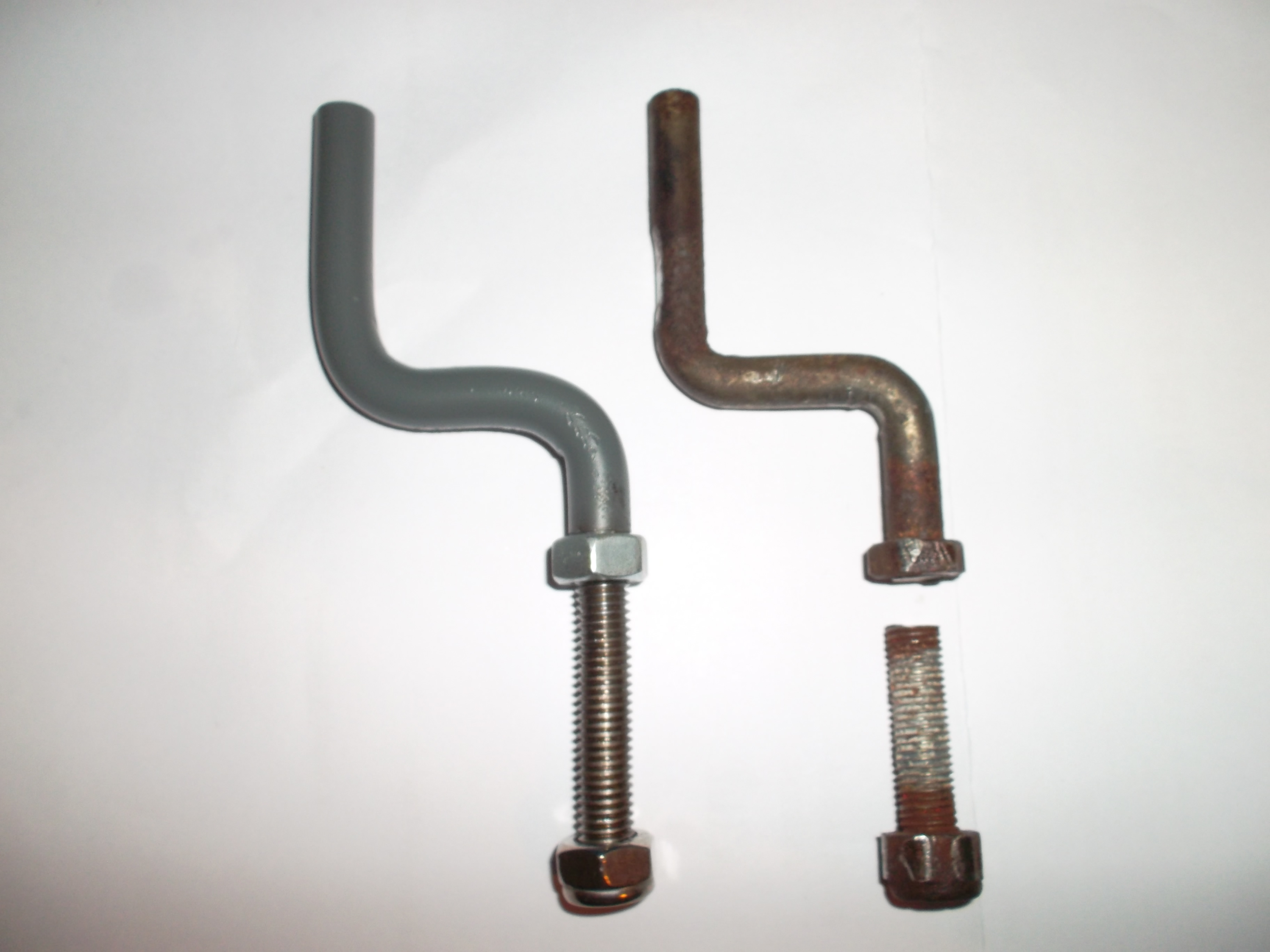

Onoff Posted August 29, 2017 Author Posted August 29, 2017 Tonight's foray into lawnmower refurb. I've got a stack of M10 bolts about 300mm long but the shanks only 9mm. Turned the end down to 8mm and stuck an M8 die down it. A bit thicker but no issue for what it does (pto tensioner):

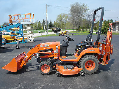

Onoff Posted August 30, 2017 Author Posted August 30, 2017 Seriously now... I'm after some plans to make a small backhoe to go on a lawn tractor like this. Thinking use the pto to drive a hydraulic pump etc. Any ideas?
Jeremy Harris Posted August 30, 2017 Posted August 30, 2017 There's a French supplier of small kits for a wide range of tiny excavators, can't remember the manufacturer, but one is called La Sauterelle, I think. There are some YoTube video around, like this one: but if you can find the site they have a range of kits and just parts available to build them.
PeterW Posted August 30, 2017 Posted August 30, 2017 39 minutes ago, Onoff said: Seriously now... I'm after some plans to make a small backhoe to go on a lawn tractor like this. Thinking use the pto to drive a hydraulic pump etc. Any ideas? Unlikely to get the RPM/pressure needed out of that size engine through a direct drive hydraulic pump. I have a Stiga mower with the hydro drive and tbh it's not amazing if you put a lot of load through it. You need the grunt in the pump to get anything like a decent flow and pressure for digging so 25-30hp is probably the minimum unless you want to dig a foot an hour ...
