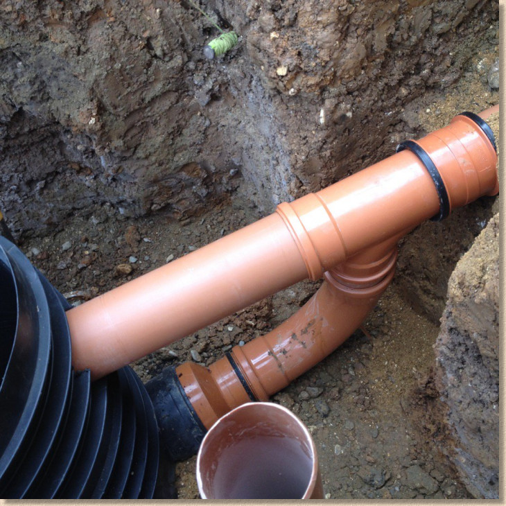

Chamber is plastic so I think I could do the same as the pic in my above post?
6 minutes ago, PeterW said:
That is an unusual backdrop but you could do that ..!!
I assume your suggestion was to have a concrete chamber?
I've never seen an external back drop - they are prone to blocking at the base.  Only ones I've seen a BCO sign off are where the pipe comes in at the side and then drops vertically to a 90 degree "shoe" that shoots it down the next section.
No easy way to rod that if it does block at the elbow.
Why do you say that, surely it can be rodded from both top and bottom inlets and the rod would reach to the bend??
You would have to rod "up" the rest bend so potentially compact anything blocked from above.
In chamber back drops are easy to do and easy to service if they block.
