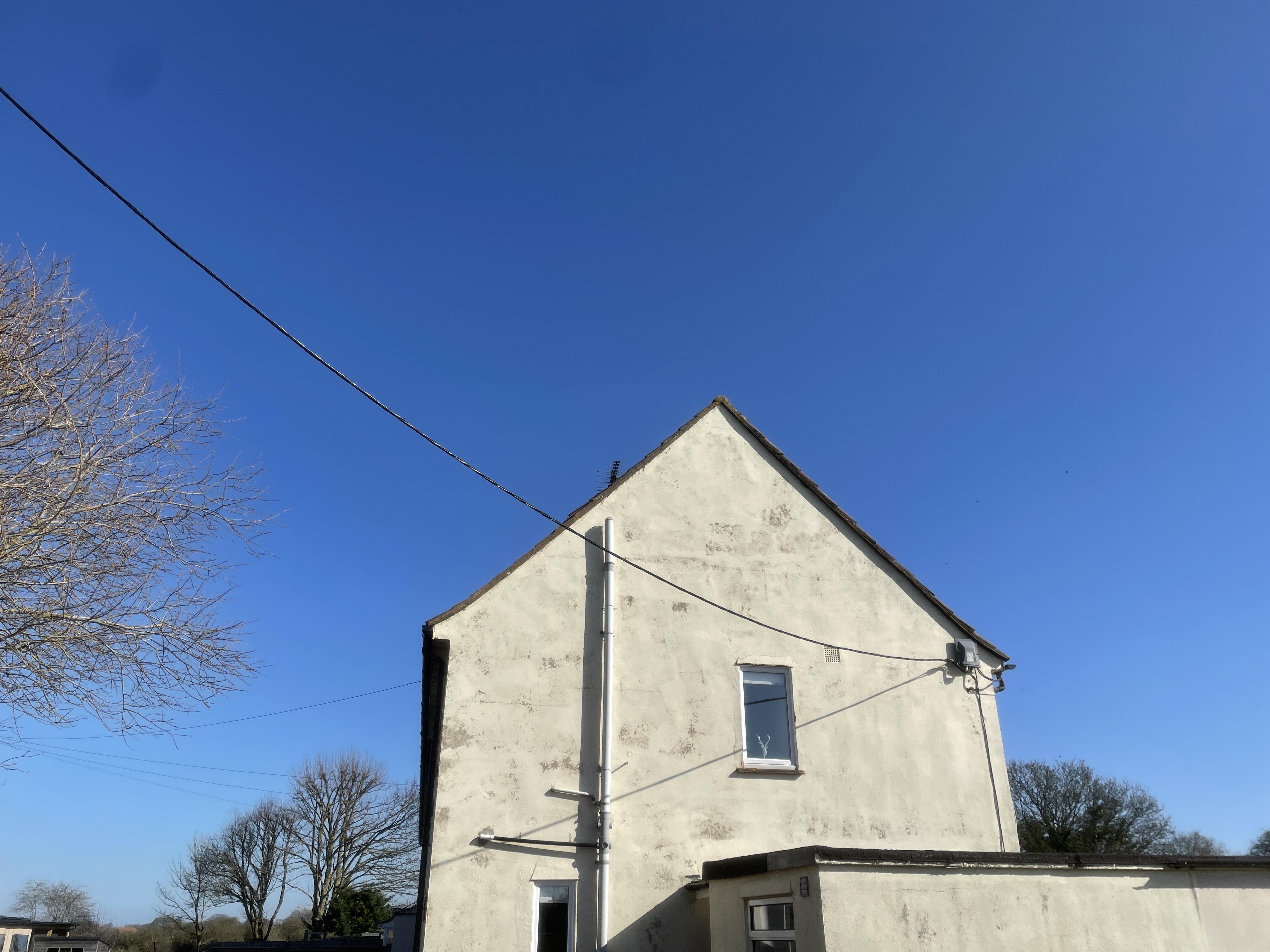

HughF Posted June 26, 2023 Share Posted June 26, 2023 (edited) The house in question: 1946 end of terrace, block + block, 50mm filled cavity (chopped and blown fibreglass) South facing, non shaded. The issue is that in summer, the constant solar gain on the southern aspect means that the walls are now a storage heater and it’s pretty nastily hot in there. Luckily I just leave and go to my rural property in Dorset which is sheltered and made of sticks. We’re up to dpc on a rear extension that will remove half of this aspect from the direct sun, moving the solar gain into the extension, which I’m hoping will be manageable through the better standard of construction. But apart from ewi, what are the options for managing the solar gain and subsequent heating of the remaining exposed wall section, the upstairs…. I’m going for 3G on the extension and will be changing the upstairs bedroom windows for 3G too. Edited June 26, 2023 by HughF Link to comment Share on other sites More sharing options...

HughF Posted June 26, 2023 Author Share Posted June 26, 2023 29 minutes ago, SteamyTea said: Will need a lot more data. Which wall is becoming a 'storage heater' assuming that the south facing wall is mostly windows and doors i.e. front of the house. What sort of areas? How does the internal temperature correlate with the outside temperature? How is the roof orientated and how well insulated? South facing walls, the whole ‘back ‘ of the house. There are four windows, all 1800x1200 (ish), all 10yr old upvc. downstairs is a kitchen and a sitting room. The front of the house (north facing just has a sitting room downstairs and the hall/stairs). House is painted white, roof is 300mm of insulation (with a bit of it compressed because the loft is boarded around the hatch). Now that it’s had a month of sunshine on it, it seems to be consistently stable at ‘hot’ temperatures internally. Link to comment Share on other sites More sharing options...

HughF Posted June 26, 2023 Author Share Posted June 26, 2023 (edited) The west wall is the end wall. We’re about to start the ball rolling (slowly) on a double height side extension to replace that single skinned outhouse. But that might be 3yrs away, planning/financing/dno depending. Edited June 26, 2023 by HughF Link to comment Share on other sites More sharing options...

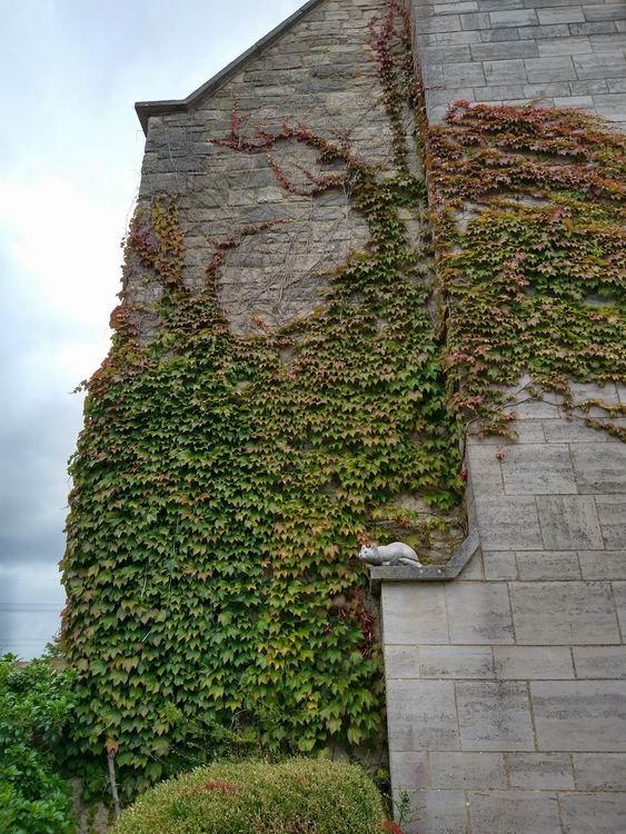

Radian Posted June 26, 2023 Share Posted June 26, 2023 Grow a virginia creeper on the wall. It won't take long to establish itself. It's self supporting on little suckers so no need for trellis. I grow one up a south facing wall to keep the inside cool in summer. Seems to work. Once in a while I cut it down at the top to stop it going over the roof. Overdid that a bit last time. Also trying a new look letting it go over the chimney! Link to comment Share on other sites More sharing options...

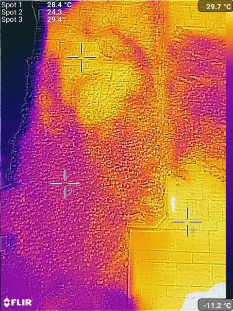

Radian Posted June 26, 2023 Share Posted June 26, 2023 5 hours ago, SteamyTea said: I did an experiment where I grew some grass in a tray and compared the temperatures to a similar tray with just dirt in it. No real difference I seem to remember. Just pointed an IR thermometer at a bit of wall behind the creeper and at the cleared area directly above... currently 5oC cooler behind the creeper. Now charging the FLIR attachment for my phone to try getting a full image (it's ALWAYS flat when I go to use it). I'm not sure if it will be so representative as the emissivity of the stone will be different to the foliage. Link to comment Share on other sites More sharing options...

Radian Posted June 26, 2023 Share Posted June 26, 2023 3 minutes ago, SteamyTea said: The physics days it should shield the wall from direct light, and as leaves absorb the red and blue light, they should heat up. As they are mostly water, quite a lot of energy is absorbed. Transpiration should be the principle process here. The fact that the air can flow freely behind the leaves as well as them shading the wall makes them an ideal sunshade. Link to comment Share on other sites More sharing options...

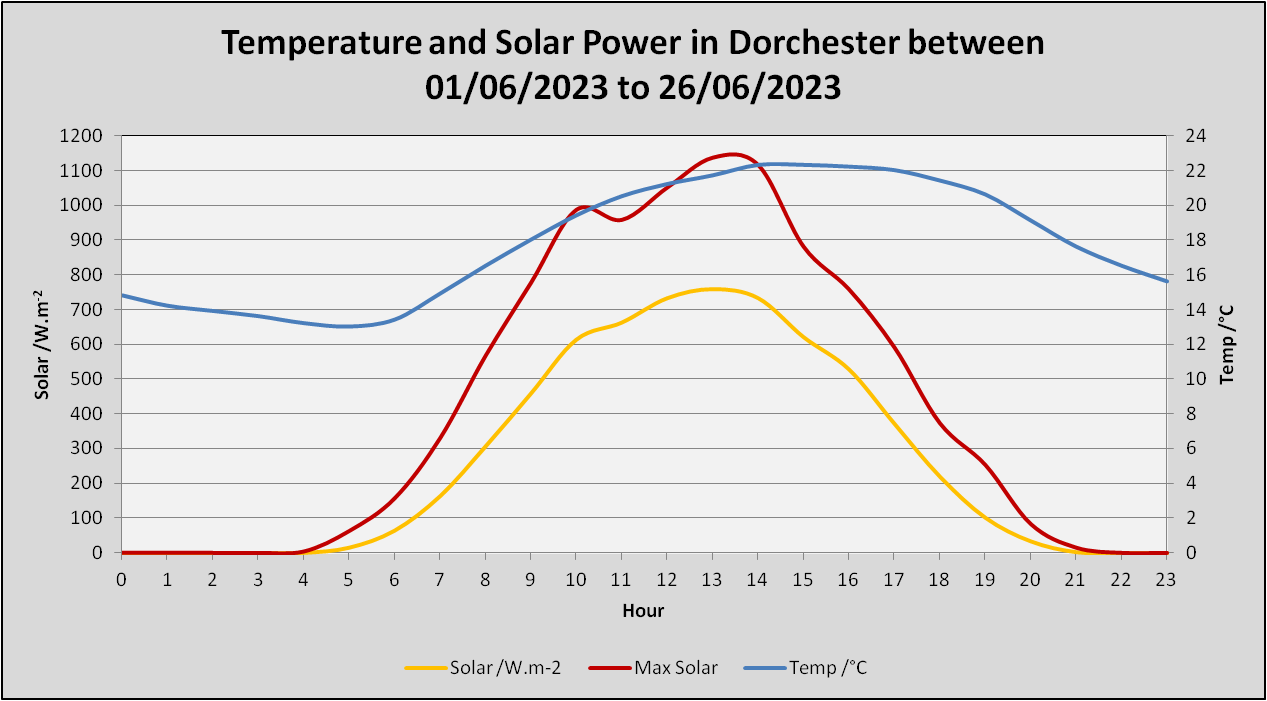

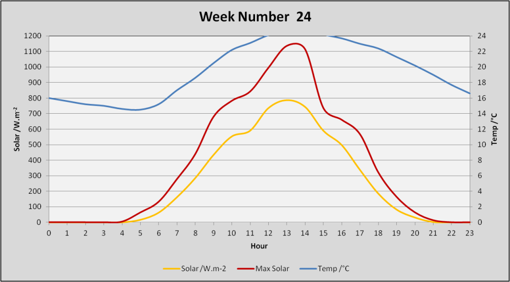

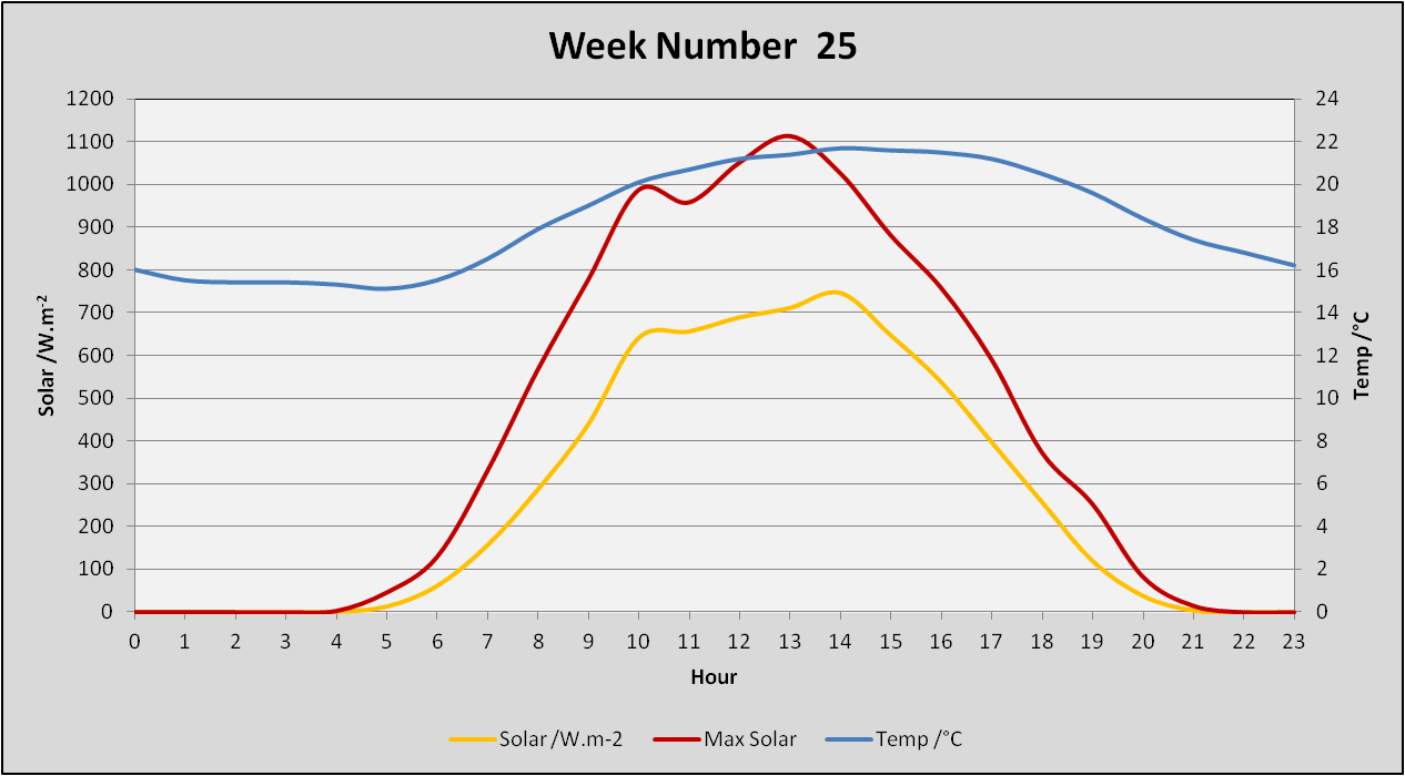

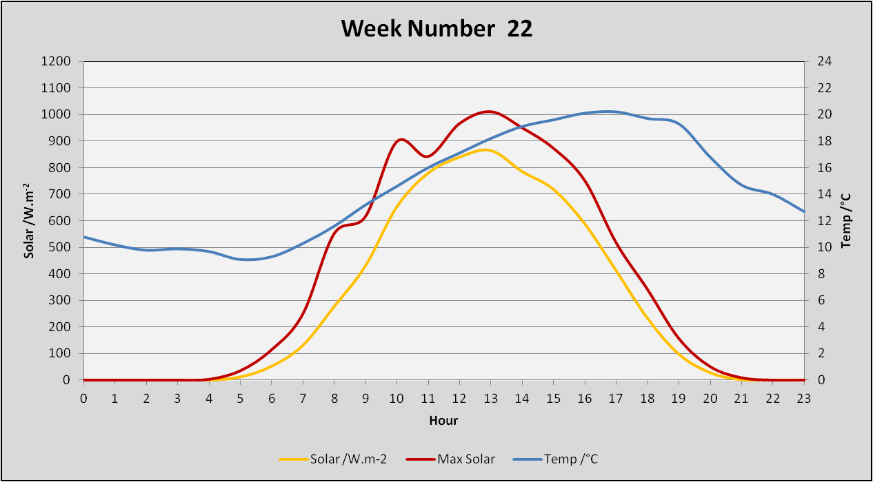

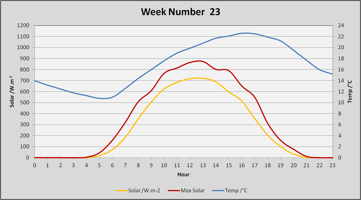

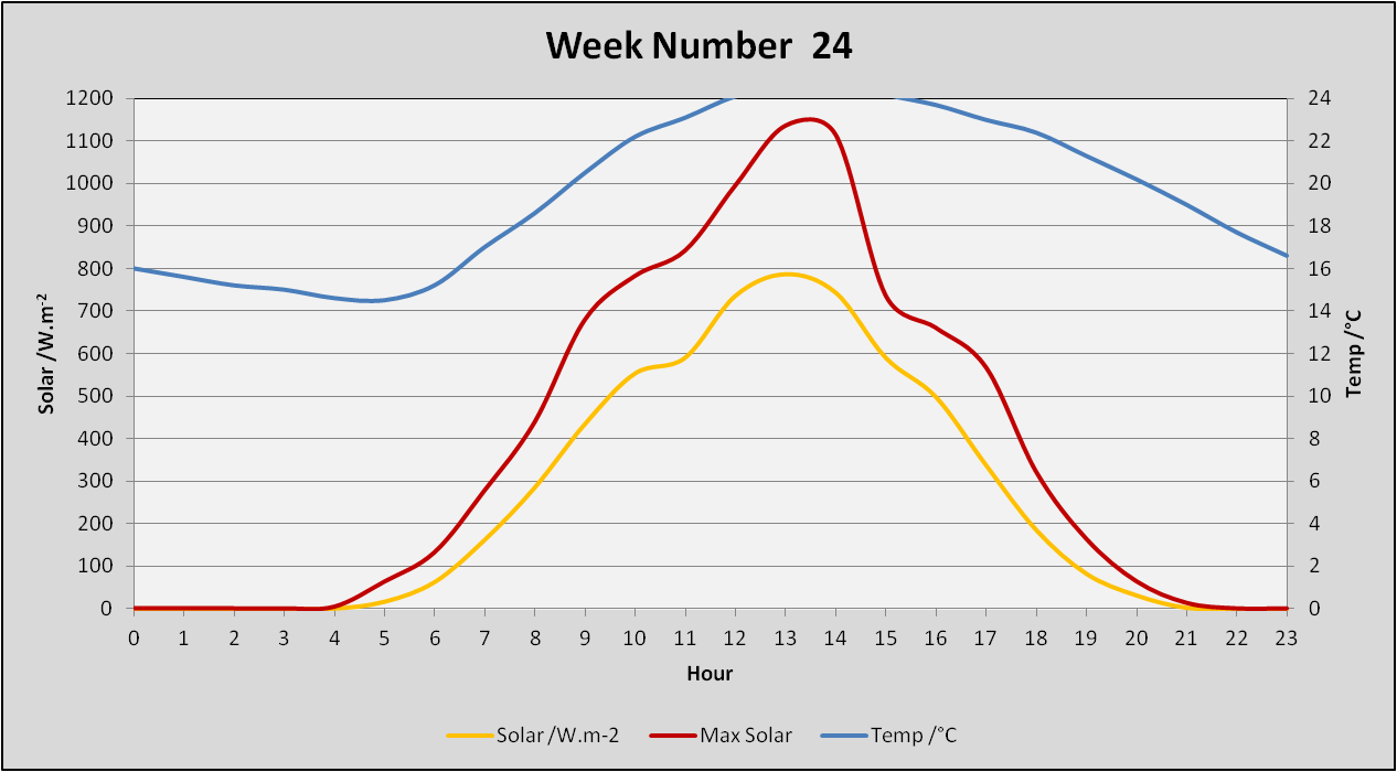

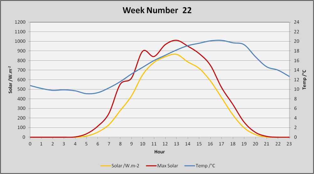

SteamyTea Posted June 26, 2023 Share Posted June 26, 2023 The reason I say that the problem is the wall, not the window(on the west side in the photo) is that there is a lot of area, the window is quite small. At this time of year, even west facing glazing is reflecting a lot of light as the sun is still quite high in the sky, we have also had high temperatures and lots of sunshine for 3 weeks now. I have picked Dorchester as an example. The solar is measured in the horizontal plain, so only noon is close to correct, either side of that, more power from the sun will be hitting the walls (if I feel up to it I shall look at the solar angles and do a bit of trigonometry, but I have a busy day tomorrow, maybe others can do it) Assuming your west facing wall starts to get a decent amount of light on it from 1 PM, then since the beginning of the month, there has been a mean of 375 W.m-2 hitting it, peaking mean is 579 W.m-2. The mean afternoon temperature, when the sun is out, has been 21°C. The night temperature has been 14.8°C, the morning till 1 PM temperature has been 16.7°C. The daily mean of the period has been 17.8°C. To see how things changed over the month, here are some more charts, but week based. Week 22 is the first week of June. Week 23 Week 24 (gone off the scale a bit) Week 25 Link to comment Share on other sites More sharing options...
