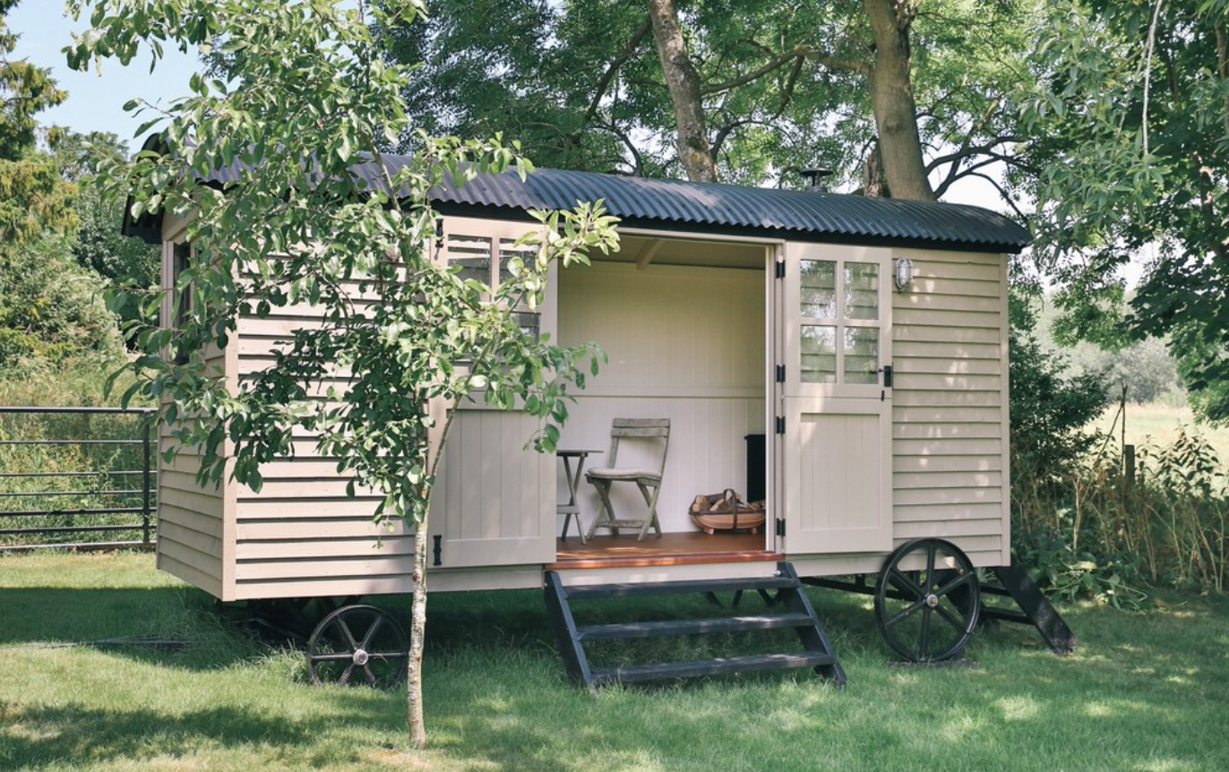

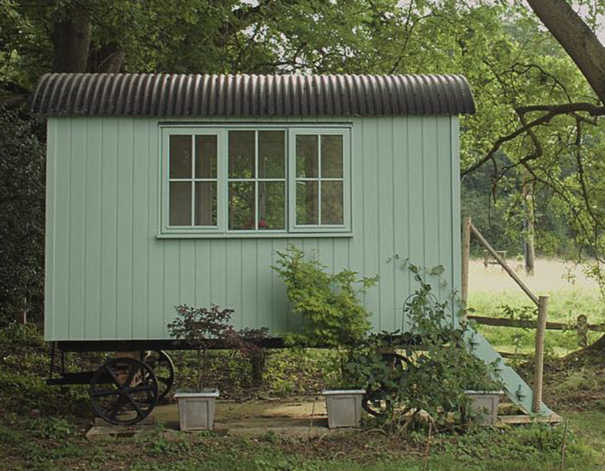

Grian Posted June 24, 2023 Author Share Posted June 24, 2023 Thank you for responses. I had a quote from a 'big company' and it was 3.2k for Douglas Fir to cover 35m2 plus corner posts. This is way over budget. I'm wondering what spec I actually need if I opt to paint the cladding? I discovered this style of cladding (pictures) which I think looks pretty charming. One producer describes it as 'matchboard', maybe that is the profile rather than the type or quality of wood? Link to comment Share on other sites More sharing options...

Grian Posted June 24, 2023 Author Share Posted June 24, 2023 It looks as though 0.7 polyester finished (not plastisol) wriggly tin is much cheaper and we will need to man-up and deal with our concerns about painting, cutting and bending it around the hut corners (don't want to use corner pieces). Link to comment Share on other sites More sharing options...
saveasteading Posted June 24, 2023 Share Posted June 24, 2023 Look at wickes website ( I suggest it because it delays does prices) and you see shiplap at £34/m2. That is per small bubble before discount incl vat. Your quote is3 x that despite thd quantity being decent. Try someone else. You could go to wickes and save £2,000 of another merchant amd save more. Remember that the overlaps require extra material. For value, I would choose tanalised pine. 1 Link to comment Share on other sites More sharing options...

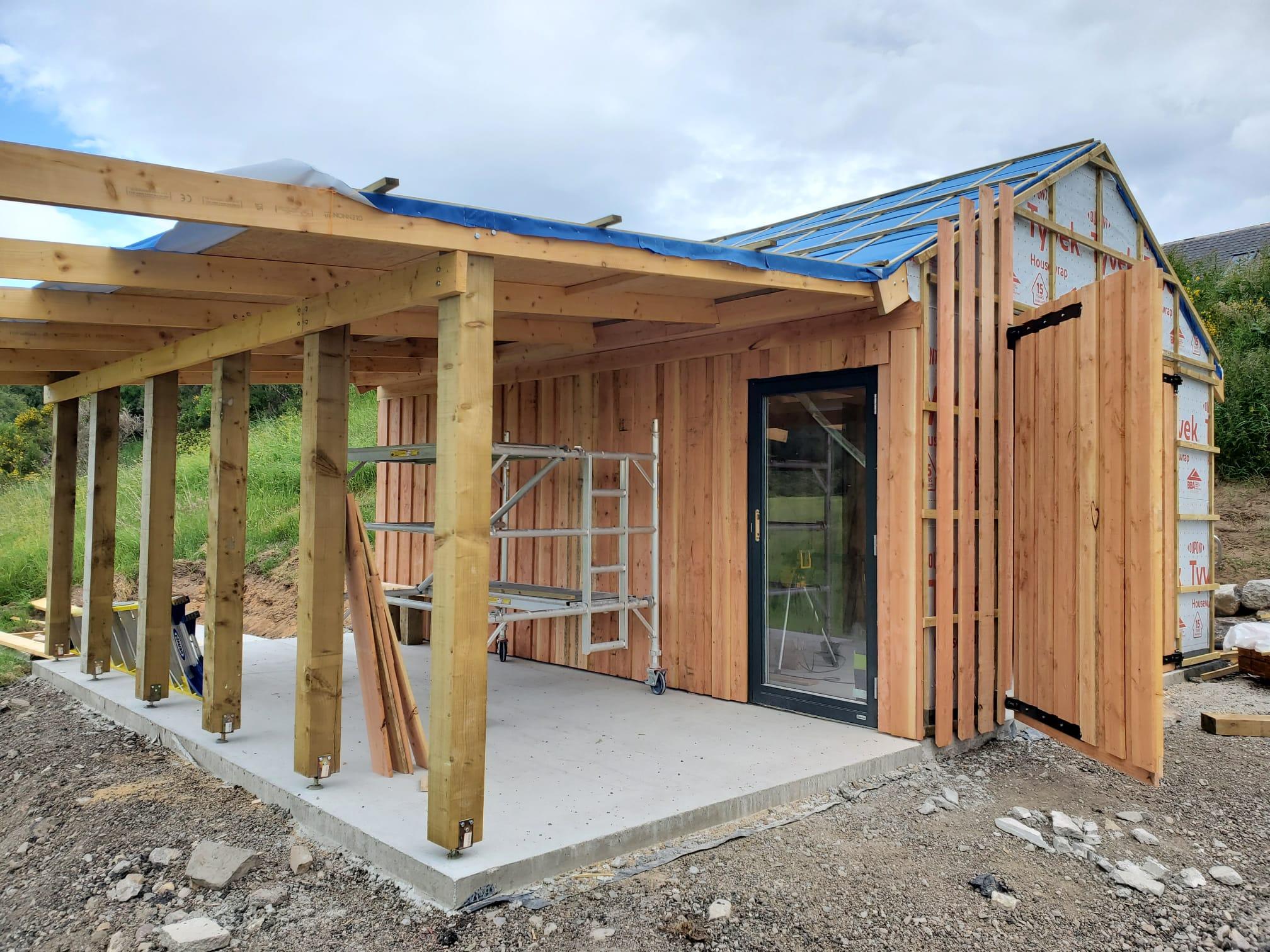

Grian Posted June 24, 2023 Author Share Posted June 24, 2023 6 minutes ago, SimonD said: Beautiful location. Strange as it may seem, take a look at Falu Red - an original paint from the copper mines in Falun Sweden. In several regions, it's the only colour you're allowed to use in rural settings and it strangely blends in very well. It also protect the timber in harsh conditions but lets it breathe. With Falu red you can use softwood. We've used locally grown Cedar for our current house due to planning (it's silvering very nicely) but I would definitely build a timber frame house finished board on board with Falu red one day - reminds me of my second home and upbringing. Here's a gallery: https://falurodfarg.com/inspiration/bildgalleri/ I reckon we have a softwood budget. Planners would have a canary if we went for that red but I can see it looks well in the right context! I've been impressed with the performance of linseed oil paint, which seems to protect for a very long time. Link to comment Share on other sites More sharing options...
Grian Posted June 24, 2023 Author Share Posted June 24, 2023 Just now, saveasteading said: Look at wickes website ( I suggest it because it delays does prices) and you see shiplap at £34/m2. That is per small bubble before discount incl vat. Your quote is3 x that despite thd quantity being decent. Try someone else. You could go to wickes and save £2,000 of another merchant amd save more. Remember that the overlaps require extra material. For value, I would choose tanalised pine. Phew, good to hear! Thank you. Knowing nothing I can't tell whether some of these timber types would be very short lived, or whether I'm unnecessarily over specifying for this purpose. Our house is clad in Siberian Larch but we can't afford it for this project. Link to comment Share on other sites More sharing options...
