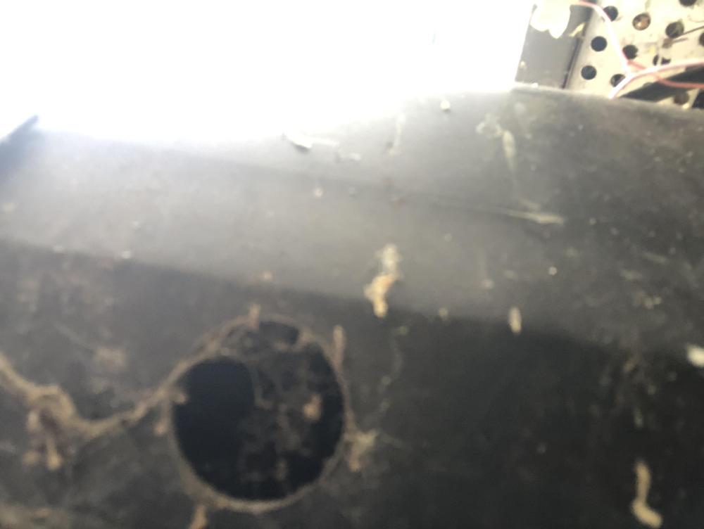

eandg Posted June 12, 2023 Share Posted June 12, 2023 47 minutes ago, Iceverge said: You'll need to seal them for the test. Either cap them or put a plastic bag over the top and seal with tape temporarily. You're unlightly to cause any damage IMO. Our airtightness test will be done after sheeting - not concerned in terms of pass/fail as we've been fairly meticulous (all windows compribanded, airtight membrane seal and then airtight taped from frame to membrane, grommets on all service penetrations etc) but hadn't thought about AAVs (or the soil vent pipe which goes to the atmosphere), which will be boxed in. Is there much of an issue not having these sealed off and/or how do you go about doing that after the fact? Link to comment Share on other sites More sharing options...
Nickfromwales Posted June 12, 2023 Share Posted June 12, 2023 1 hour ago, eandg said: which will be boxed in These need to remain accessible? Link to comment Share on other sites More sharing options...
Nickfromwales Posted June 12, 2023 Share Posted June 12, 2023 4 hours ago, Thorfun said: Qq on AAVs (maybe @Nickfromwales is best to answer?). Do I really need to remove them and cap the pipes for the Airtightness test? Aren’t they valves? so aren’t they closed until air is required? How do they behave when the internal air pressure of the house is reduced? Do they stay shut or open up as the air pressure in the pipe is higher than in the house once it’s depressurised? If it was my house, I'd cap everything and go to the nth degree to get the actual ACH of the fabric. What is the point in doing all of the work up to that point, if a slightly faulty / leaky valve then gives you a shite ACH score!?!?! 1 Link to comment Share on other sites More sharing options...
Thorfun Posted June 12, 2023 Author Share Posted June 12, 2023 17 minutes ago, Nickfromwales said: If it was my house, I'd cap everything and go to the nth degree to get the actual ACH of the fabric. What is the point in doing all of the work up to that point, if a slightly faulty / leaky valve then gives you a shite ACH score!?!?! yep. it's a very fair point thank you. consider it done! 1 Link to comment Share on other sites More sharing options...
eandg Posted June 12, 2023 Share Posted June 12, 2023 1 hour ago, Nickfromwales said: These need to remain accessible? They've not been boxed in yet but presumed they would be - plumber had previously said about access for rodding eyes and the like so we'll catch that when finishing sheeting this week. Cheers. 1 Link to comment Share on other sites More sharing options...
Thorfun Posted June 12, 2023 Author Share Posted June 12, 2023 1 hour ago, Nickfromwales said: These need to remain accessible? 18 minutes ago, eandg said: They've not been boxed in yet but presumed they would be - plumber had previously said about access for rodding eyes and the like so we'll catch that when finishing sheeting this week. Cheers. i think @Nickfromwales was talking about the AAVs needing to be accessible rather than the soil pipe? could this possibly be a crossed-wires situation? 1 Link to comment Share on other sites More sharing options...
eandg Posted June 12, 2023 Share Posted June 12, 2023 Just now, Thorfun said: i think @Nickfromwales was talking about the AAVs needing to be accessible rather than the soil pipe? could this possibly be a crossed-wires situation? I think he is - and it's a good reminder before we finishing sheeting not to box anything in that we need access to but can't get to. (Think AAVs are to be hidden in cupboards, rather than sheeted, anyway but shall confirm with the principal interior designer). 2 Link to comment Share on other sites More sharing options...
Nickfromwales Posted June 12, 2023 Share Posted June 12, 2023 56 minutes ago, Thorfun said: i think @Nickfromwales was talking about the AAVs needing to be accessible rather than the soil pipe? could this possibly be a crossed-wires situation? 53 minutes ago, eandg said: I think he is - and it's a good reminder before we finishing sheeting not to box anything in that we need access to but can't get to. (Think AAVs are to be hidden in cupboards, rather than sheeted, anyway but shall confirm with the principal interior designer). Cheer for the clarity. Rodding points not so much of a worry, and usually just a tick-box for BCO's. AAV's defo need access or locating strategically Good that you have that in hand already. Link to comment Share on other sites More sharing options...
