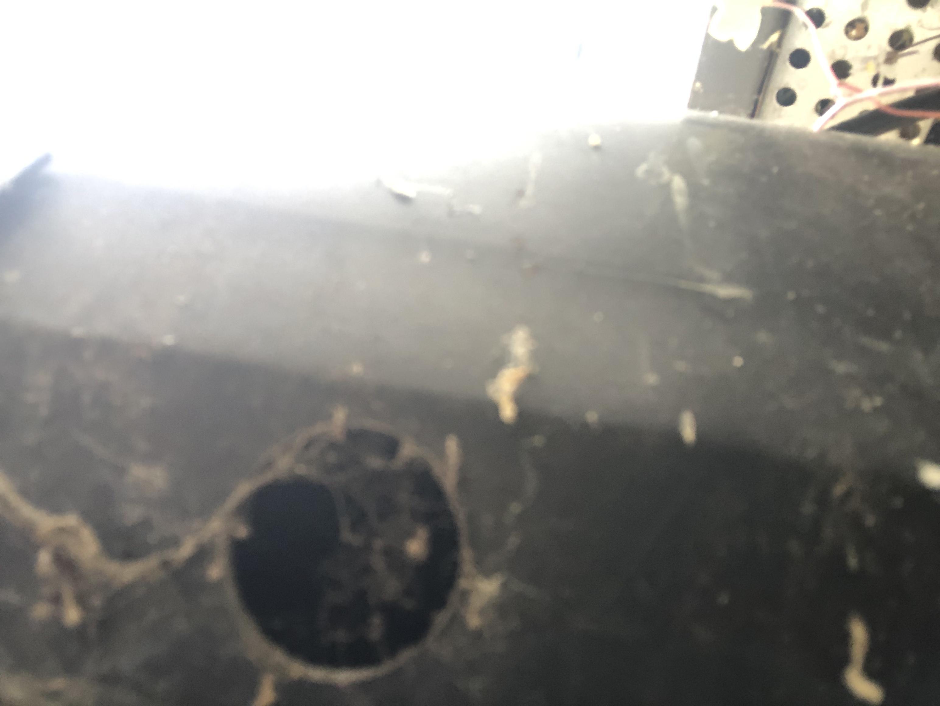

Pocster Posted June 11, 2023 Share Posted June 11, 2023 @Thorfun can’t remember if you have an internal perimeter drain ? I *guess* you would want to cap that as it would be an open pipe to your external sump ??? Link to comment Share on other sites More sharing options...
Thorfun Posted June 11, 2023 Author Share Posted June 11, 2023 13 minutes ago, SteamyTea said: You can cling film over the bogs, just make sure your wife uses one before you do. they're not fitted yet. I make her go directly into the soil pipe 1 Link to comment Share on other sites More sharing options...
Thorfun Posted June 11, 2023 Author Share Posted June 11, 2023 2 minutes ago, pocster said: @Thorfun can’t remember if you have an internal perimeter drain ? I *guess* you would want to cap that as it would be an open pipe to your external sump ??? no internal perimeter drain. 👍 1 Link to comment Share on other sites More sharing options...
Pocster Posted June 11, 2023 Share Posted June 11, 2023 6 minutes ago, Thorfun said: no internal perimeter drain. 👍 Note to self then - as mine has unsurprisingly holes in it 🤣 Link to comment Share on other sites More sharing options...

Thorfun Posted June 11, 2023 Author Share Posted June 11, 2023 46 minutes ago, pocster said: Note to self then - as mine has unsurprisingly holes in it 🤣 and some spiders by the looks of it 1 Link to comment Share on other sites More sharing options...
