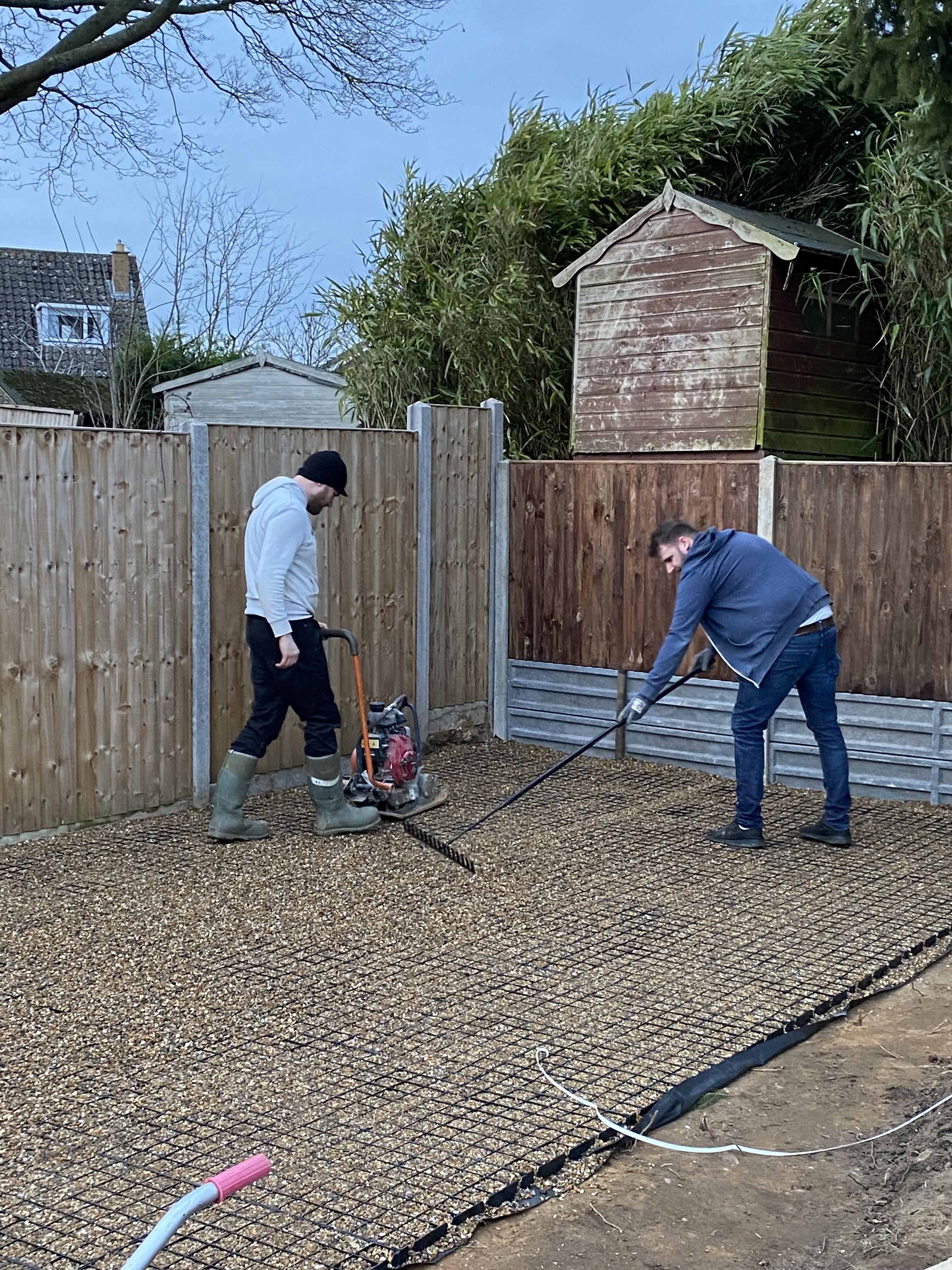

Other easier option is that it’s tear of pouring a concrete slab, you buy the plastic interlocking grids/trays. That will cost you about £120. Then you have the option of filling them with peashingle for extra stability/sturdiness, but it isn’t essential. You could just fill the grids at the perimeter or skip it altogether.
Yeah I’m going down this route i think, far easier than concreting.
Would I still need a hardcore base if I used this? If so, how deep? 3 inches of compressed hardcore then the plastic grid and then shed base?
Need is a strong word, but yes it’s recommended to do that.
That’s pretty much what I did, though slightly less. Maybe only 5cm or 6cm.
Edited by Adsibob
1 minute ago, AdamD said:
Nice. Sub base as well?
Cut the grid to the size of the shed or a slight over/under hang?

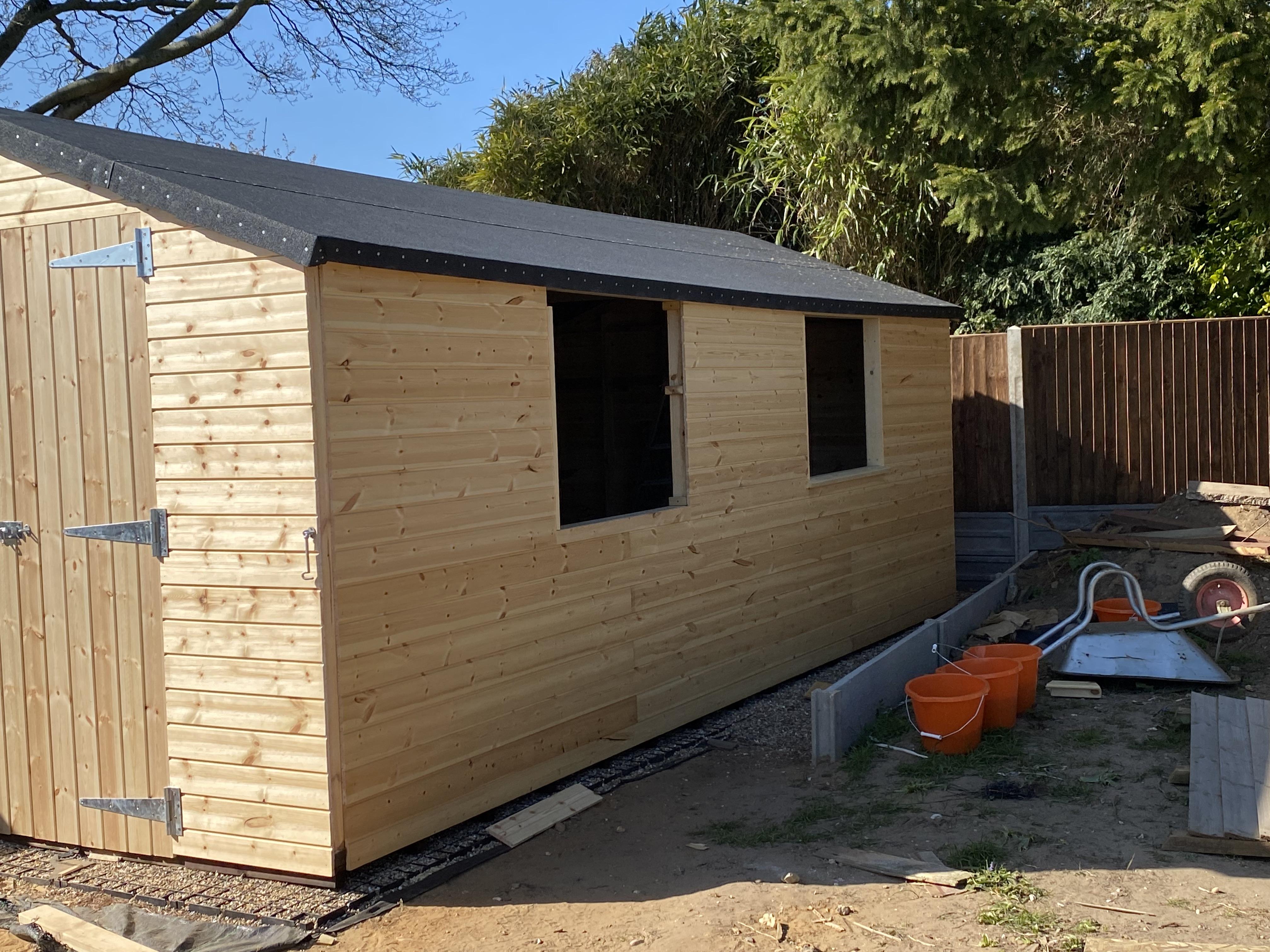

Definitely over, at least by 12cm extra, so if your shed is 300 by 400 go for 324 by 424 base. I also ordered the shed to have a roof overhang. On the front elevation the overhang is about 50cm. I made the shed base about 40cm buffet on that elevation, and this enabled me to put a doormat outside the shed and keep it dry. Wish I’d done the same on my actual house!
The ground was just sandy gravel, after I’d removed the topsoil so compacted that, put down a weed membrane then levelled the grids and filled with 10mm crushed gravel.
Crushed is much better than shingle as it compacts so much better.
no didn’t cut the grids I left overhang
How much sub base and what type? 50-60mm depth for the aggregate do the job?
I didn’t need to add sub base, I compacted what was already there as it was sand and gravel. My whole plot is sand and gravel.
So depends on your ground, but the grids spread the load so 60 -70 mm of compacted crushed concrete should be fine,
