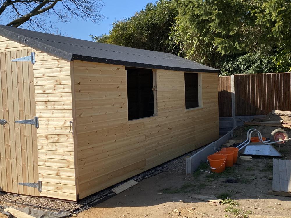

  • This is what I did on a bigger outbuilding with tiled roof. How much is necessary I don't know..   Install duct for electricity. I used rebar hammered into ground and cable ties to hold duct
  • Coming up married for 31 years. I love shifting tonnes of soil, by hand, from A to B. I'll often shift it back to A just to keep out of the house...
  • Don't just put a shed on a concrete base that's bigger. Rain lands on the perimeter and runs under or rots out the bottom.   Either raise the shed on a coarse of engineering bricks or make t

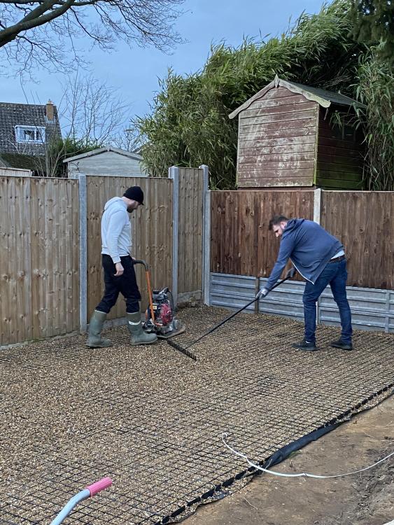

Ok, so I’m a novice therefore feel free to add anything I’ve missed.
  • dig to 100mm (60mm hardcore, 40mm grids)
  • add membrane
  • add and rake hardcore, compress to level
  • lay and lock plastic grids. Fill with pea gravel.
  • shed base in place and fixed to concreted brackets
  • reconstruct shed
Recycled type 1 adequate for the sub base?

Not pea gravel, you want 10mm crushed. Pea gravel or pea shingle has a quantity of round pebbles which move about too much, crushed stone is all angular and packs in much tighter so it doesn’t lift out go everywhere

How long should it take to compact with a 320mm wacker plate?
Worth going for a 400mm one?
