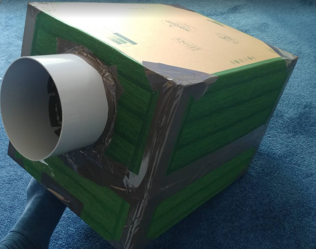

LeeV Posted June 10, 2023 Author Share Posted June 10, 2023 After scratching my head for a while about which attenuator to buy, and looking at the DIY versions on this very forum, it stuck me that a "Rapid Cardboard Prototype" was needed to test if an attenuator would actually fix the problem before spending any money on something that may not work. Which lead to the abomination below. It was just as well I built it out of cardboard, as when I tried to install it, the slope of the roof meant I couldn't actually connect the ducting from the Vent-Axia. Ten minutes, a stanley knife and more tape later, I'd move the input port to the back of the box and it fitted great. And for a cardboard box full of filter material, it works surprisingly well. In the main bedroom, you can't hear the drone from the supply vent, but now the howl from the extract vent in the ensuite is really noticeable! This is great! So due the headroom constraint, it seems like I have to build a box attenuator. I'm just unsure of the details. Out of 10mm ply? Does the inside need painting? With what? Presumably bigger is better (I'm constrained by a nearby truss and the roof slope) Insulated with 50mm of EPS foam on the outside? Fibreglass mat internally seems to be a thing with commercial boxes, but I used filter material as its what I had to hand, and I don't fancy fibreglass strands being pumped into the house. I did thing of lining the box first with the fireproof acoustic foam matting I put inside the manifolds, but that didn't seem to do much there? Then building a copy for the extract manifold? Which leaves the question, won't the mat inside the extract manifold box just get soaking wet after cooking/showers as mist/water droplets hit the filter material? Then leading to mould in the box? Or is this not an issue? Link to comment Share on other sites More sharing options...

LeeV Posted July 24, 2023 Author Share Posted July 24, 2023 On 22/06/2023 at 21:55, m0deller said: when it gets cold and humid air hits that box ... probs won't last long ! Definitely! The cardboard was only a prototype to see if it fixes the problem. Which it mostly did. I'm going to replace it with a box built from EPS Foam. Light, thick, fairly cheap and already insulated! On 22/06/2023 at 22:24, Post and beam said: I guess that this means the manifolds do not perform the same job. No, they don't seem to. I was rather hoping they would too. Especially after I'd added fireproof acoustic foam to the inside of them! But no... Link to comment Share on other sites More sharing options...

Dave Jones Posted July 27, 2023 Share Posted July 27, 2023 On 24/07/2023 at 17:49, LeeV said: Definitely! The cardboard was only a prototype to see if it fixes the problem. Which it mostly did. I'm going to replace it with a box built from EPS Foam. Light, thick, fairly cheap and already insulated! No, they don't seem to. I was rather hoping they would too. Especially after I'd added fireproof acoustic foam to the inside of them! But no... sure you want to be breathing in plastic particles ? Link to comment Share on other sites More sharing options...
