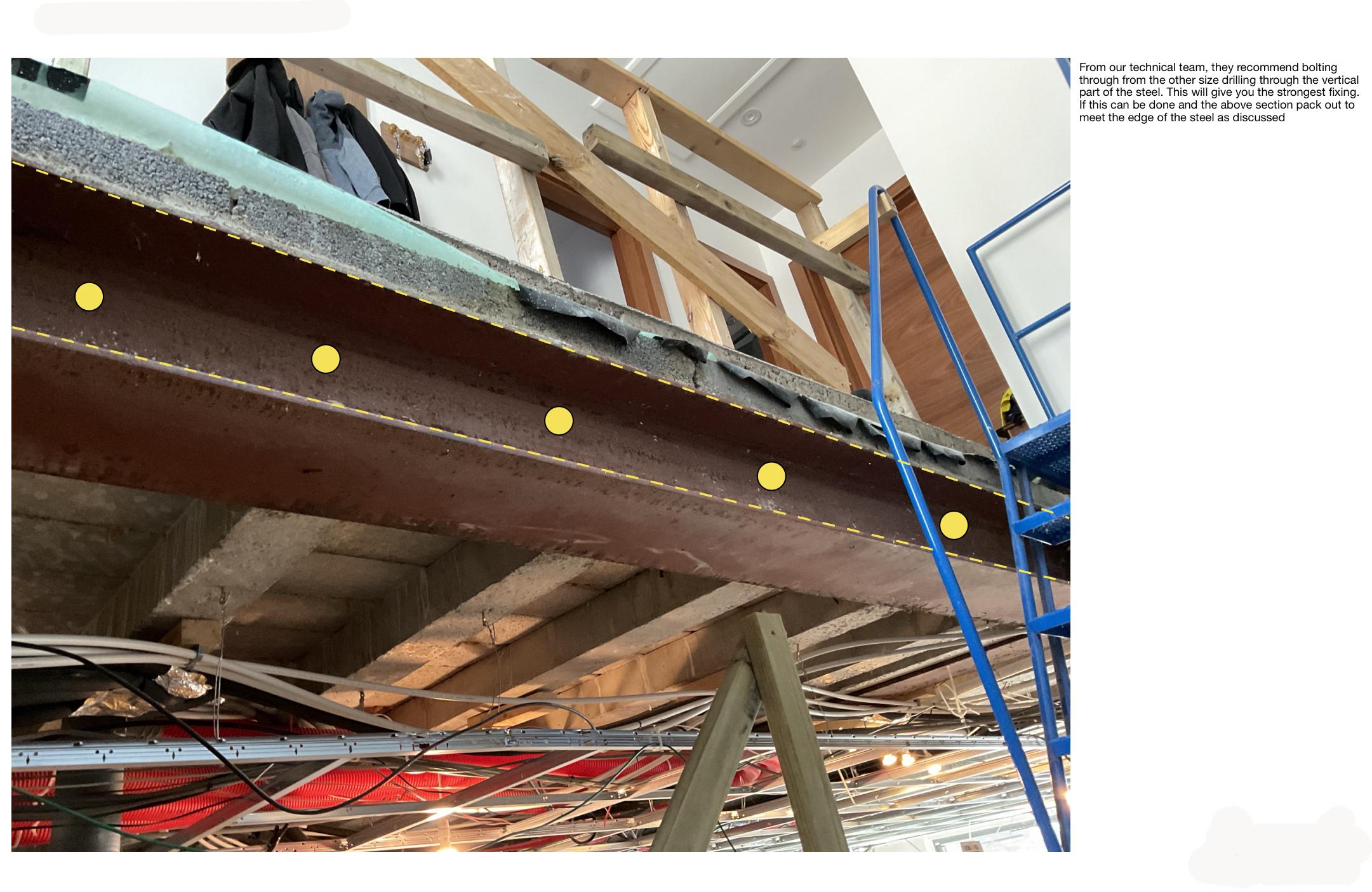

Oz07 Posted June 10, 2023 Share Posted June 10, 2023 On 27/05/2023 at 21:32, pocster said: Here's their plan. I drill the steel at these points ( presumably 2 holes ). Fix noggins. Timber then horizontal; then pack out with OSB. What bugs me is a) the work for me and b) the actual top tread fixes at just one point by the blue stairs - so why I need to do the whole lot is pointless. They fix to the steel any way they want at the top tread end to the steel! Hilti gun the timber to the steel web would save drilling the holes. I've had to this before to fix a ledger for a flat roof. Link to comment Share on other sites More sharing options...
Pocster Posted June 10, 2023 Author Share Posted June 10, 2023 3 minutes ago, Oz07 said: Hilti gun the timber to the steel web would save drilling the holes. I've had to this before to fix a ledger for a flat roof. Yeah I know of that method. They will do a steel fixing from top tread to rsj' much better! Link to comment Share on other sites More sharing options...
