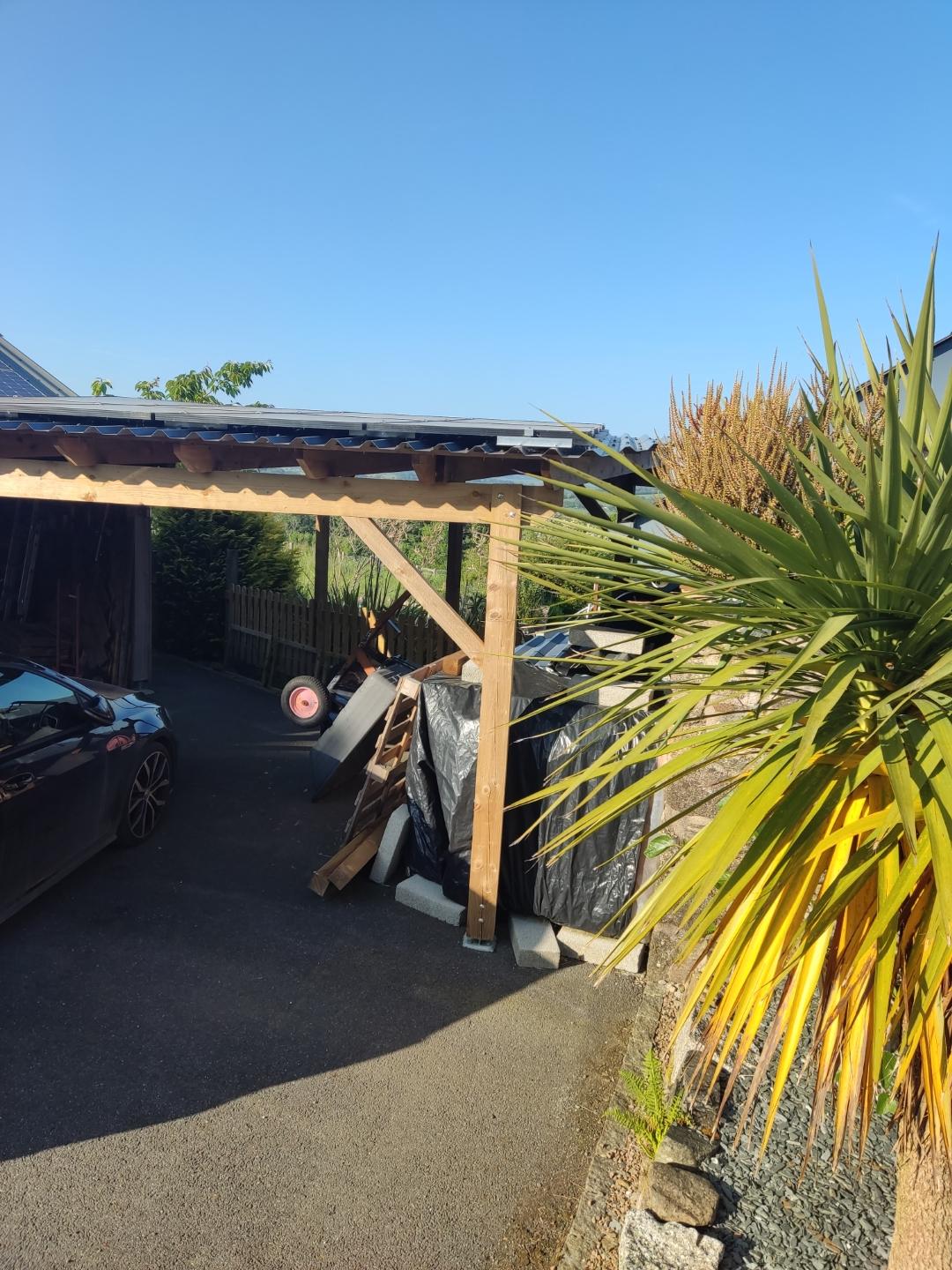

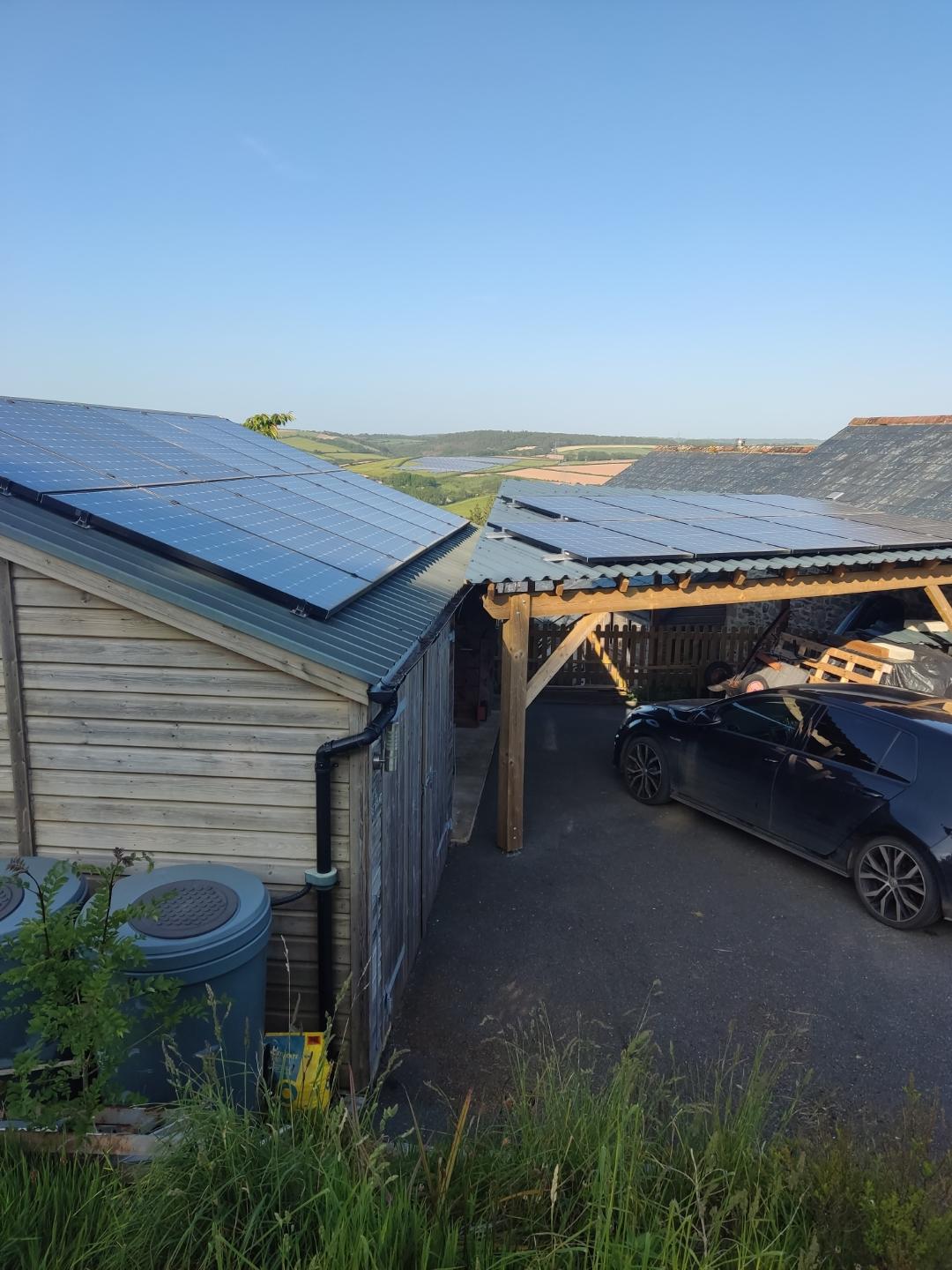

Adam2 Posted May 28, 2023 Share Posted May 28, 2023 We were all set on solar on our flat roof (single ply membrane on insulation on ply) but having experienced 90 mph winds last winter (on top of a hill facing SW with not much between us and the sea) I think really we should have put in some structural elements to fix through into before the roof went on. For us now the risk of either roof damage or worse of a panel lift up isn't balanced by the ROI in 5 or so years (depending on impact of various "special operations")! We pre-planned lots of important aspects but this is one that got away! So just a word of caution for people in exposed locations with a similar thought and time to plan. Link to comment Share on other sites More sharing options...
Nickfromwales Posted May 28, 2023 Share Posted May 28, 2023 8 minutes ago, Adam2 said: We were all set on solar on our flat roof (single ply membrane on insulation on ply) but having experienced 90 mph winds last winter (on top of a hill facing SW with not much between us and the sea) I think really we should have put in some structural elements to fix through into before the roof went on. For us now the risk of either roof damage or worse of a panel lift up isn't balanced by the ROI in 5 or so years (depending on impact of various "special operations")! We pre-planned lots of important aspects but this is one that got away! So just a word of caution for people in exposed locations with a similar thought and time to plan. Any space for a ground-mounted array or create a structure to take even 4kWp? 2kWp is better than nowt! Link to comment Share on other sites More sharing options...
