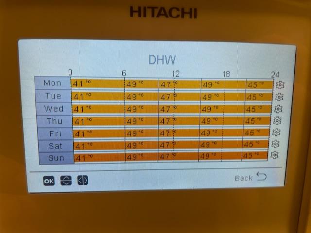

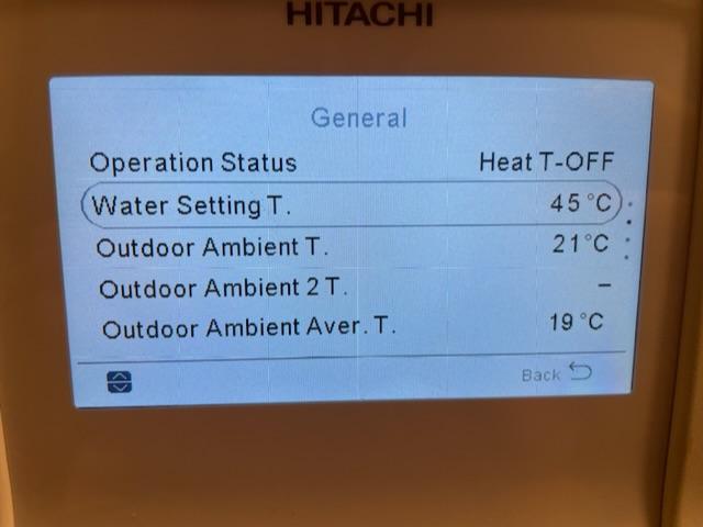

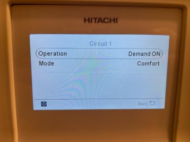

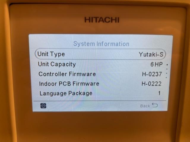

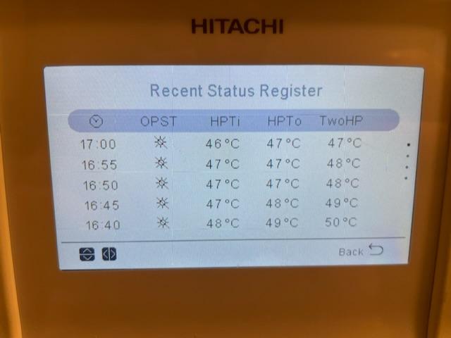

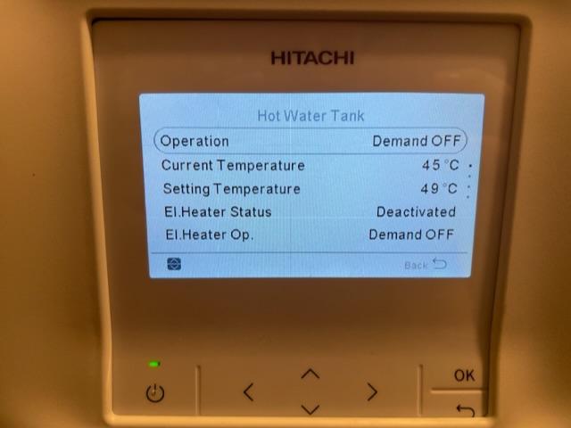

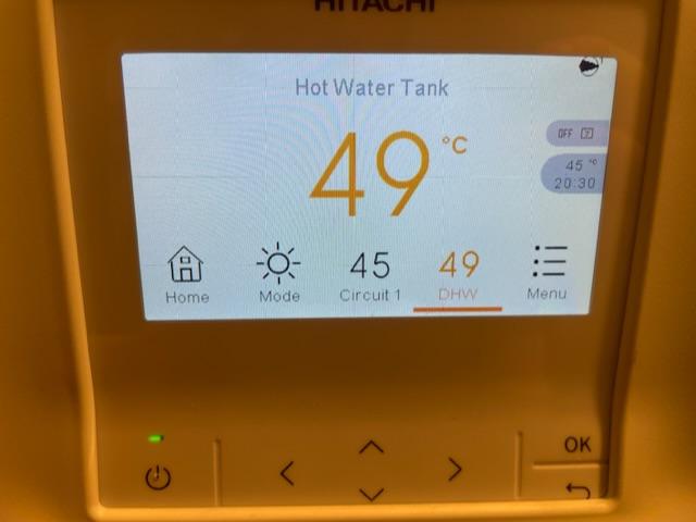

ashthekid Posted May 25, 2023 Author Share Posted May 25, 2023 Thank you all for your replies. I'm still averaging 30 kWh per day even with all UFH set to low temps so I know it's not pulling anything in any of the zones. Within the ASHP settings (it's a Hitachi Yutaki S split system as the outdoor unit is 35m away) I attach some of my settings screenshots - would be interested if anything flags up for anyone when looking. My solar PV(11x panels of 360w each) is generating an average of 15-24 kWh per day at the moment - peaking at 24.8 on yesterday. I generated: Feb 169 kWh (ave 6 per day). -- OVO usage 70 per day March 212 kWh (ave 6.8 per day) -- OVO usage 55 per day April 407 kWh (ave 13.5 per day) -- OVO usage 43 per day May so far(upto today 25th) 405 kWh (ave 16.2 per day) -- OVO usage is 703 so far (ave 29 per day) Link to comment Share on other sites More sharing options...

JohnMo Posted May 26, 2023 Share Posted May 26, 2023 Not sure what I am reading from the screen shots. Can you confirm The cylinder looks to at 49? Your radiators 46 to 47? Is this correct? Link to comment Share on other sites More sharing options...
Conor Posted May 26, 2023 Share Posted May 26, 2023 If you heating flow temp is 45+ then you need to lower it. Ours runs at 32-35c. You'll gain a whack of efficiency by doing this. Link to comment Share on other sites More sharing options...

JohnMo Posted May 26, 2023 Share Posted May 26, 2023 If your UFH is running at 45 your CoP will not be much better than 3, if your running the UFH for short periods then CoP will drop from that. Running at 35 your CoP jumps to 4, so you use 33% less electric. UFH runs better if you run for a long periods at the lowest possible temperature. You need to drop the temperature on the heat pump controller, not the mixer on the UFH manifold as such. Link to comment Share on other sites More sharing options...

JohnMo Posted May 27, 2023 Share Posted May 27, 2023 Or just running everything too hot, for too short a period, therefore getting a rubbish CoP. Basically trying to run like a gas boiler. Link to comment Share on other sites More sharing options...
