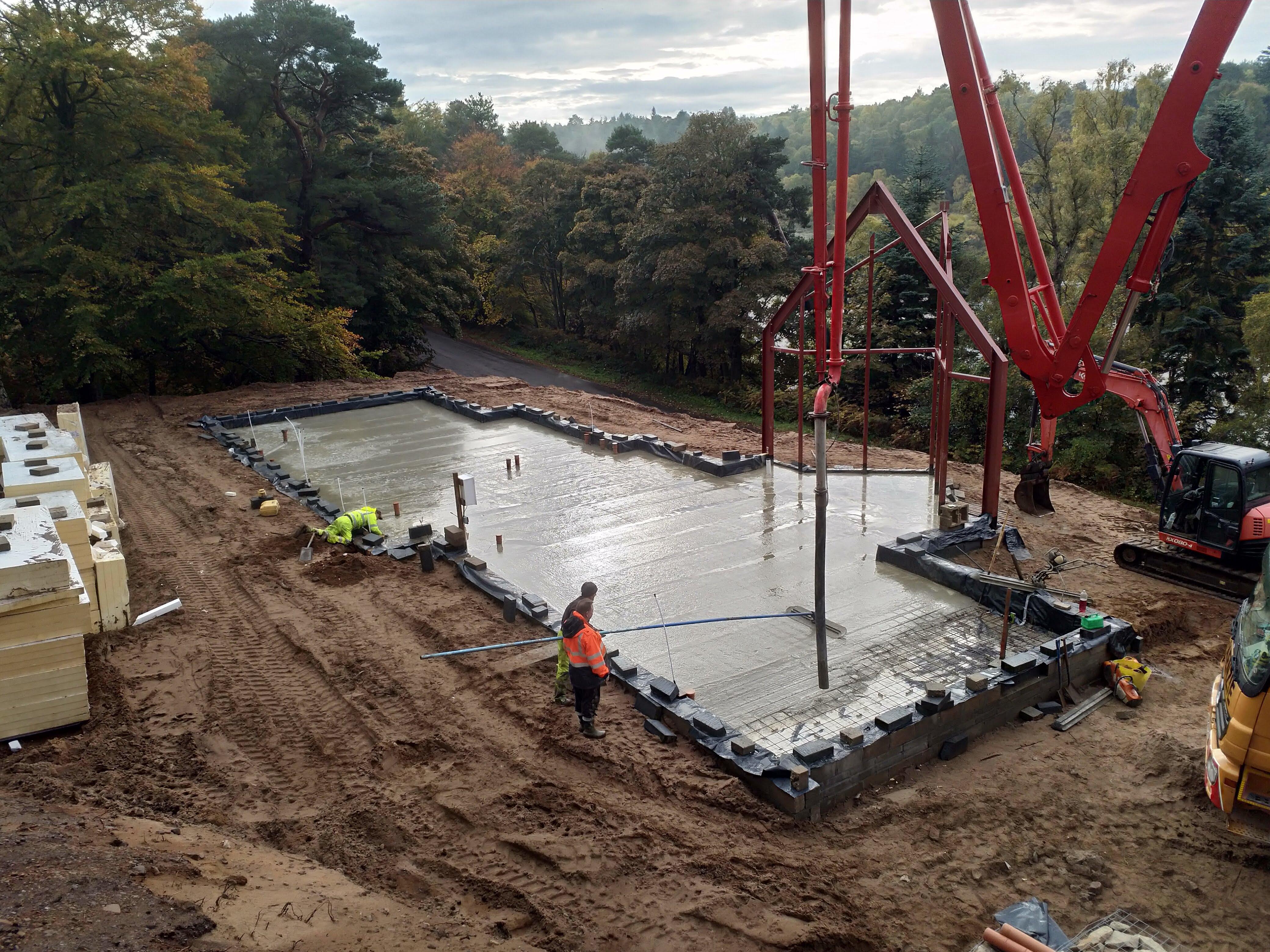

IanR Posted May 15, 2023 Share Posted May 15, 2023 (edited) 1. Insulated raft. 2. Nope, but wouldn't personally use SIP, especially with a light-weight rain screen. Green Oak structure? Looks lovely, but will continue to move for the next 10 years and kill any airtightness you achieve. 3. Not something that can be ball-parked, very much site and design specific. Insulated raft will likely reduce the dig and concrete. When comparing costs, include the slab/block & beam, insulation and screed costs, so that you are comparing apples with apples, and make sure you are comparing equal performance. ie. no point in comparing an Insulated raft with a 0.10 U value and zero cold bridging with a building regs strip foundation with Block & Beam. An insulated raft is pretty easy to install, but does need to have calcs to get it through Building Control. I went with Advanced Foundation Technology Ltd. and am happy to recommend. Edited May 15, 2023 by IanR 1 Link to comment Share on other sites More sharing options...

IanR Posted May 15, 2023 Share Posted May 15, 2023 38 minutes ago, greenqueen said: I do like the idea of an insulated raft buy also in two minds because of the cost, If it's a like for like comparison an insulated raft should be cheaper. I don't know if they still do, but AFT will come and install with 1 guy, if you have two labourers to work with him. Your Groundworks would get to a flat site, with drainage runs dug, and sub-base layers down then AFT would come in and layout the EPS sheets and formers, DPM, UFH, Mesh and Rebar, then help with the pour and teh power-floating. Link to comment Share on other sites More sharing options...

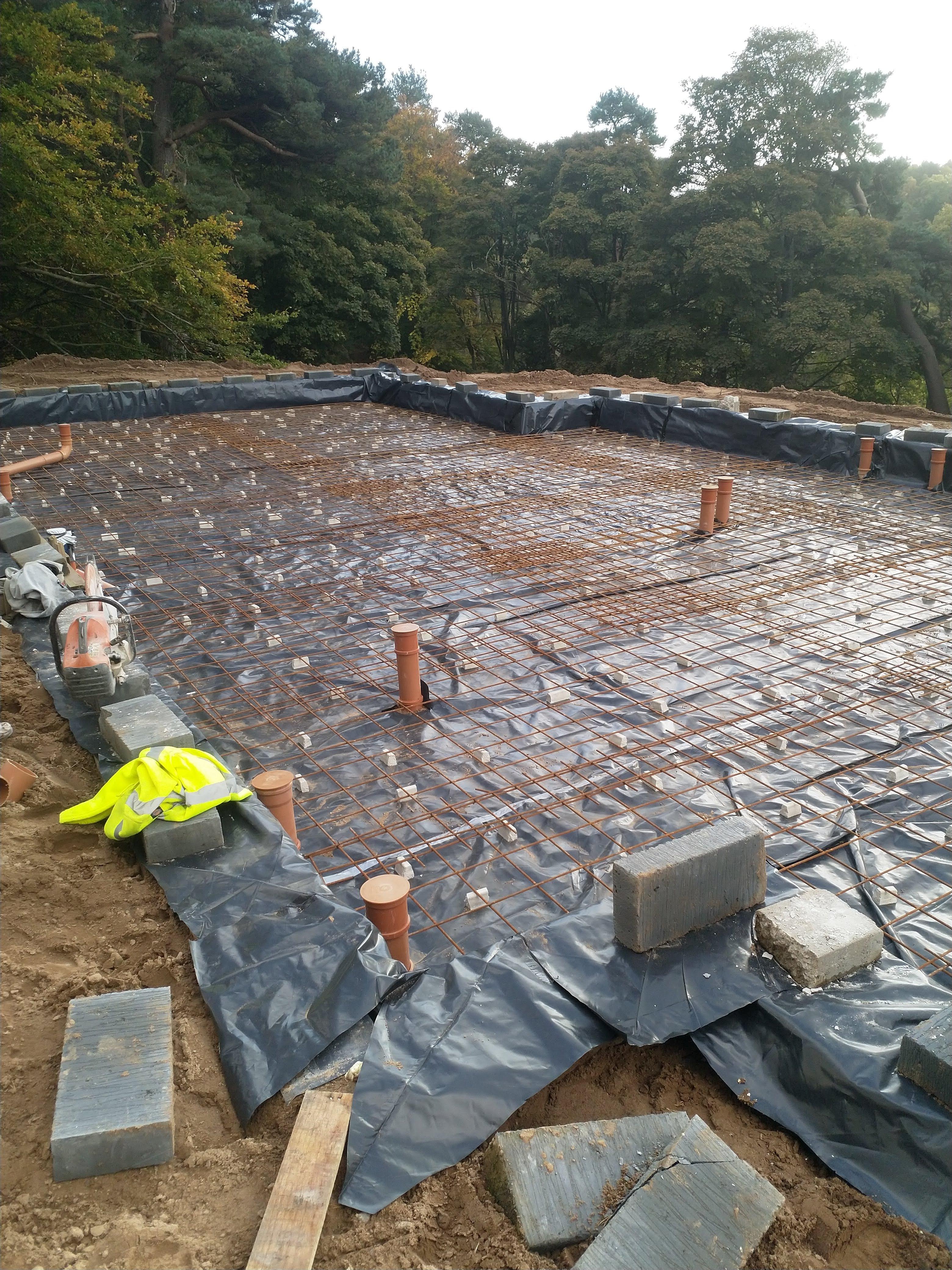

IanR Posted May 15, 2023 Share Posted May 15, 2023 2 hours ago, saveasteading said: A raft is a structure where the slab is thicker, heavily reinforced, and integrated with the perimeter concrete beam. Only needs as much concrete and steel as is required to take the load. My raft has a nominal thickness of 100mm with a single layer of mesh. The Integral perimeter ring beam is 300mm thick with some additional rebar and there's a couple of internal beams for load baring walls at 200mm thick. Link to comment Share on other sites More sharing options...

saveasteading Posted May 15, 2023 Share Posted May 15, 2023 52 minutes ago, IanR said: My raft has a nominal thickness of 100mm with a single layer of mesh My point exactly. That is not structural, only taking floor loading (you in an armchair). Floating is a good term. So that is not normally called a raft, not among Engineers anyway. Our project was cautiously designed with a structural raft, about 200mm thick and with 2 layers of heavy reinforcement. For urgency we proceeded while discussing and agreeing the matter with the SE. We then did the other half with 100mm and fibre mesh. Hence I know the cost difference was 15k for 170m2 of each. (BTW I am a Chartered Engineer but not on the Scottish register so had to use another SE.) Link to comment Share on other sites More sharing options...
IanR Posted May 15, 2023 Share Posted May 15, 2023 57 minutes ago, saveasteading said: My point exactly. That is not structural, only taking floor loading (you in an armchair). No, you misunderstand, it is the structural foundation and floor combined. It is a raft. Many on here have a similar construction from either AFT, Kore, MBC, et. al. 1 hour ago, saveasteading said: So that is not normally called a raft, not among Engineers anyway. You'll need to tell that to the Engineer that Designs them. 1 hour ago, saveasteading said: Our project was cautiously designed with a structural raft, about 200mm thick and with 2 layers of heavy reinforcement. For urgency we proceeded while discussing and agreeing the matter with the SE. We then did the other half with 100mm and fibre mesh. Hence I know the cost difference was 15k for 170m2 of each. Sounds completely over-engineered, but perhaps you have a very heavy super-structure. I'm pretty familiar with the cost of mine also, and had initially costed strip foundations and ground bearing slab + screed, before realising the performance benefits of an Insulated Raft. For me, an Insulated raft was cheaper. Link to comment Share on other sites More sharing options...

Big Jimbo Posted May 15, 2023 Share Posted May 15, 2023 @JohnMo.It looks like you are building on the edge of a cliff ? Link to comment Share on other sites More sharing options...
IanR Posted May 15, 2023 Share Posted May 15, 2023 47 minutes ago, saveasteading said: I don't really understand the eps system of raft, but it seems to be somewhere in-between the two I have described. ie it is done on good ground with a reinforced ring beam, so the load doesn't have to spread far into the slab. It is an insulated raft, that can sit on quite a low baring capacity, if you have a light structure, and there are versions that can go on very low capacity ground. Typically EPS200 or EPS300 is used under the beams. 51 minutes ago, saveasteading said: Convenience and speed at, presumably, a cost premium. No, not at a premium, at least it doesn't need to be. Less dig, less concrete, EPS instead of PIR/PUR and no screed required. Materials are less than a strip foundation with slab/block&beam + insulation + screed. They are niche in the UK, so some companies are charging a premium for a package, but it doesn't need to be. 57 minutes ago, saveasteading said: My point as originally stated is that you and I are using the term raft differently, perhaps 3 ways, and the OP should be aware of the possible confusion....which we are increasing. I don't believe you are using the term "Raft" differently, you are just not accepting that a raft can be engineered down to 100mm thick + a ring beam when it's sitting on 300mm of EPS. It functions the same way as your Raft, ie. it transfers the entire loads from the structure into the ground. https://www.advancedfoundationtechnologylimited.co.uk/?utm_source=google&utm_medium=organic&utm_campaign=gmb-listing# Link to comment Share on other sites More sharing options...

IanR Posted May 16, 2023 Share Posted May 16, 2023 8 hours ago, George said: the model that works in my head is that the EPS is just replacing the sub-base There's still a sub-base under the EPS. Typically 150mm - 200mm thick. Link to comment Share on other sites More sharing options...
JohnMo Posted May 18, 2023 Share Posted May 18, 2023 On 15/05/2023 at 20:48, Big Jimbo said: @JohnMo.It looks like you are building on the edge of a cliff ? Living life on the edge. But its not as bad as looks really, more a 45 degree slope. 1 Link to comment Share on other sites More sharing options...
