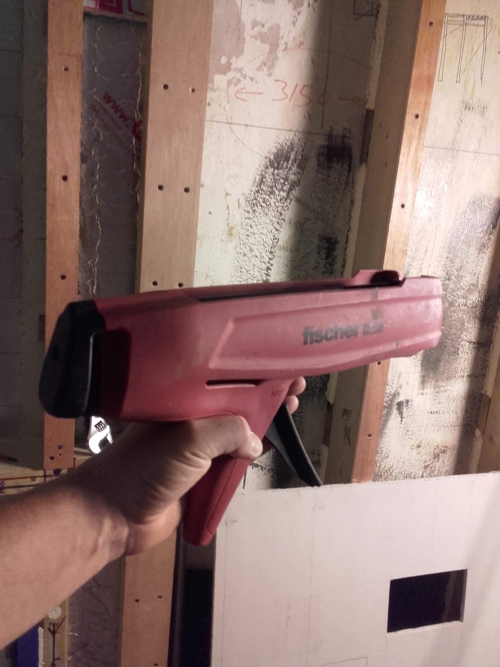

jamiehamy Posted August 7, 2017 Share Posted August 7, 2017 Ah well - moving on swiftly! I went with a mix on application method rather than glass capsules. You need a special applicator gun - standard one won't do I'm afraid. I've not done it yet, it's on my endless list of tasks! http://www.screwfix.com/p/fischer-fis-vt-vt-vinylester-chemical-mortar-resin-380ml/14364 http://www.screwfix.com/p/rawlplug-rawlplug-resin-gun/30939 Link to comment Share on other sites More sharing options...

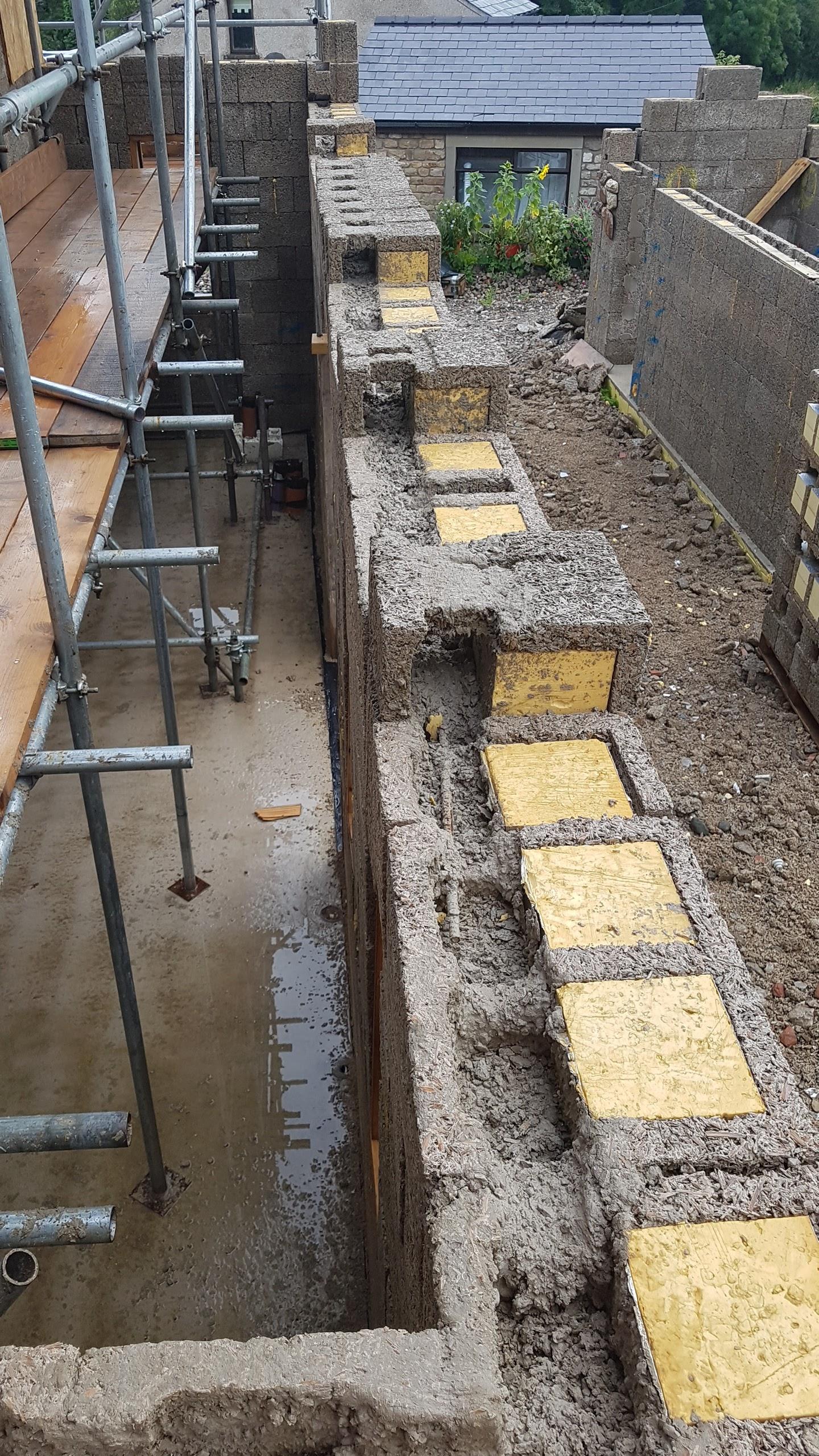

ToughButterCup Posted August 7, 2017 Author Share Posted August 7, 2017 This is what we've got: The insulation is 'backed up' as it were by the concrete-filled holes. Tanners suggested every fourth hole ought to have a bit of rebar sticking up, ie. one piece of rebar in every other block. The bit of rebar you can see is the one strengthening the soldier course at head of a window. This section of the build only needs one more full course (plus a bit) to sit on the top of the existing blocks. So, not much needed here, but it needs to be 'reet' as thyey say up here. Ian Link to comment Share on other sites More sharing options...
Jeremy Harris Posted August 7, 2017 Share Posted August 7, 2017 I see the problem! I didn't realise the concrete had already been poured, but you are where you are, so do now need to drill and bond rebar ties in. I guess a lesson may have been learned for future pours............... Link to comment Share on other sites More sharing options...
jamiehamy Posted August 7, 2017 Share Posted August 7, 2017 Hmm, surely you just need to pop in some dowels into a slightly oversize hole? Resin fastening rebar is not only time consuming but is not offering anything here - apart from costing a lot. Still baffled as to why they didn't just finish the wall before pouring but you are where you are. That piece of half cast rebar annoys me - what poor workmanship - it's essentially a lintel that has being cast in two parts. I would absolutely put a fresh length over that on a concrete chair or something and cast it anew. As for resin fastening rebar - its your money but if that's what the S. E demands, fair enough but if not, dowels are what should be needed if you want peace of mind. The cement in the concrete will embed it and do the job as it would in any other area - resin not required. Link to comment Share on other sites More sharing options...

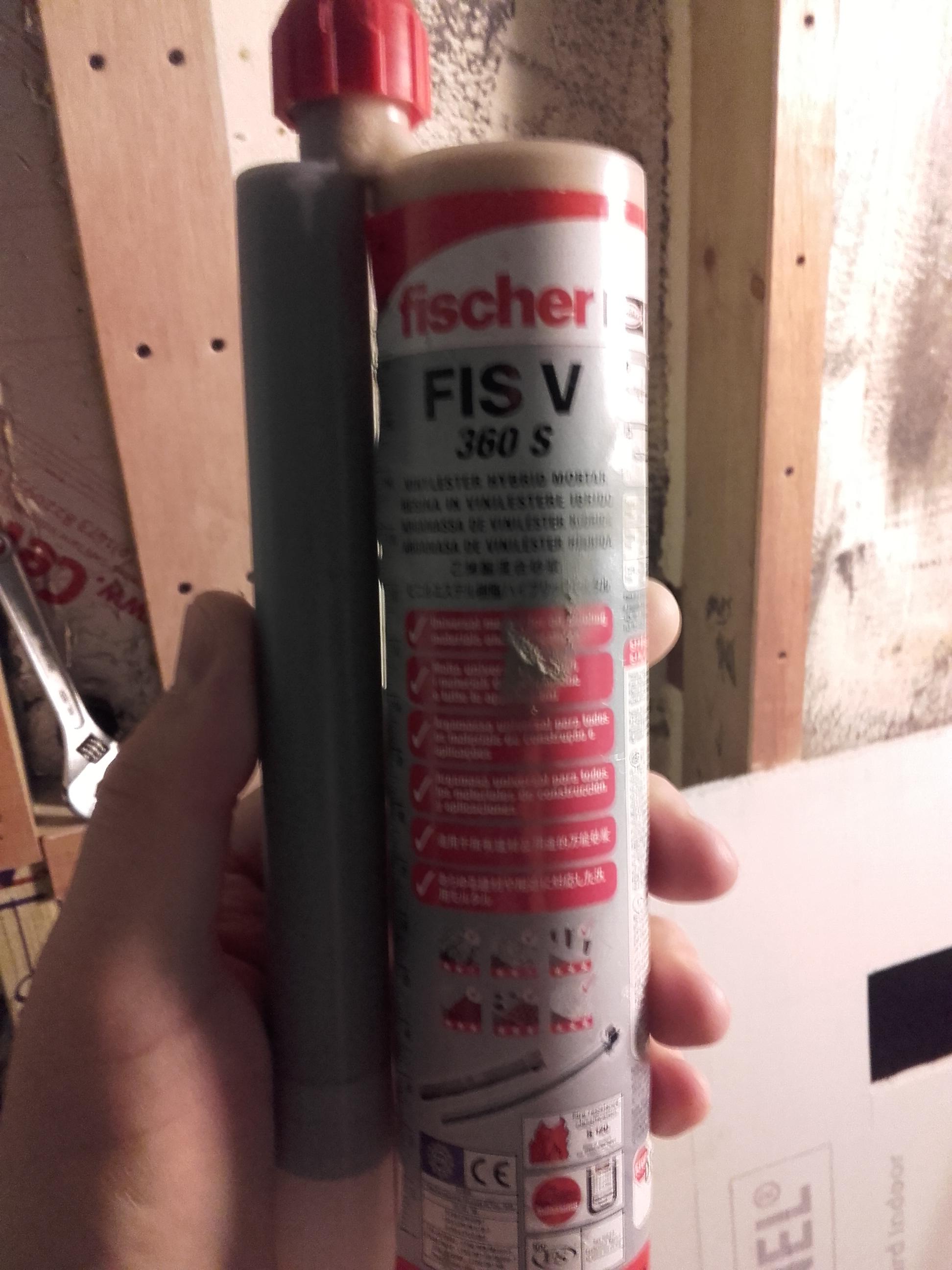

Onoff Posted August 7, 2017 Share Posted August 7, 2017 Another + for Fisher: This is used for anchoring safety harness eyebolts etc, Fischer FIS V 360S. It's brilliant stuff. They do a rebar specific one...not sure this is it though: It is two pack as in resin & hardener in separate, piggy backed tubes. Far superior than the stuff that "fits in a normal mastic gun". It takes a special gun. This is the plastic one, they also do a metal version: Tbh I have of late used the DeWalt "standard mastic gun" one for some non critical stuff and it was OK but not Fischer grade to my mind. I got given a couple of slightly out of date Fischer tubes that couldn't be used along with the gun and have used the system to fit M10 studs for supporting some of the heavier timber stud sections in the bathroom, the wc frame etc. Since been buying the resin, not cheap! You MUST get the proper puffer to blow the holes out after drilling. A vac with bit of thin tube is no good nor is a compressor. Each are better than nothing but they only blow/suck in one direction so force loose debris into the sides of the drilled hole. A manual puffer sucks and blows on alternate strokes and really dislodges crap & clears things out. I've tried a Henry and a compressor then the proper tool and more dust always comes out. Before Fischer we used Rawlplug R-Kem. (Their tech support was great). Both systems take special guns. In a previous life way back I used to use Hilti stuff and again special guns required. Think I've still got a couple up the shed people are welcome to if any use. Though I suspect the systems have moved on after 20/30 years and the guns are obsolete. Funny feeling I binned them of late during the Great Clear Out of 2017 which appears to have achieved precisely nothing in terms of "getting tidy"! Link to comment Share on other sites More sharing options...

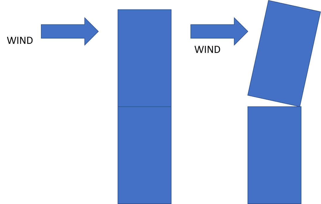

jamiehamy Posted August 7, 2017 Share Posted August 7, 2017 So let's start with the problem statement- You are casting a concrete wall in two pours. You want to join the two sections to ensure no horizontal movement? Solutions- 1 - drill and then resin bond pieces of steel reinforcing bar vertically on the top of the first poured course to be covered with the final pour thus providing the horizontal interlock. Given that the rebar is in a vertical hole it can't move horizontally anyway so not clear on resin benefit here. 2 - drill an oversize hole, say 20mm wide and 300mm deep. Pop a 12mm x 600mm piece of rebar in prior to pour. Pour concrete and gentle vibrate to ensure concrete gets down the hole and once concrete has gone off you have an interlock. Ensure at least 40mm concrete cover of the rebar all round. 3 - do nothing. Between the top of the first pour not being smoothed(which is fine) and the holes in the tops of the icf, you have a very good key already there and once you pour the concrete there is not going to be any horizontal movement anyway. If you chose to recast the lintel, you need to place a new piece of horizontal rebar - you can sit this on a piece of concrete at either end, can really be any old piece, although when laying founds you can buy chairs for this which mean they become a part of the founds/slab that are the same material unlike say a wooden chair which might deteriorate and cause a weakness. Link to comment Share on other sites More sharing options...
ToughButterCup Posted August 7, 2017 Author Share Posted August 7, 2017 At last, someone who is clear about the need for concise problem statements. What a relief. I'm going for 2 and 3, as well as a bit of the addendum. And I'm going for @Onoff's puffer and @PeterW's Hilti '...solution....' (Christ how I HATE the abuse of that innocent little word). I'm going to trial the use of resin because I'm going to need to fix the first floor POSIs, and they need to be 'resined' in. And for that I need clean holes. ================================ Monday morning: HERAS unlocked, 0700. PC's arriving today. Cos He Told Me 0900, a quick polite text to the PC: 'You coming today? 'I'm going to be with you erm, ahhhh, mid-week, Ian' 'And you knew that you were going to be delayed yet again by Wednesday of last week didn't you?' 'Er, well, yes' If you can't take a joke, don't self-build 1 Link to comment Share on other sites More sharing options...
MikeSharp01 Posted August 7, 2017 Share Posted August 7, 2017 Hi Ian. You won't want to hear this, and it may not be a problem, but in case it has not been addressed there is also a toppling force on the wall which needs to be 'managed' which may or may not be why the pull out resistance of the rebar needs to be good and the number of them high enough. As depending upon how high the next pour is you will have a weak line along the join which could, in some weather conditions, put pressure on the top of the wall and cause a failure. If there are corners in the pour or a good number of castelations (you picture shows a few) the risk is lessened. Sorry! Link to comment Share on other sites More sharing options...
