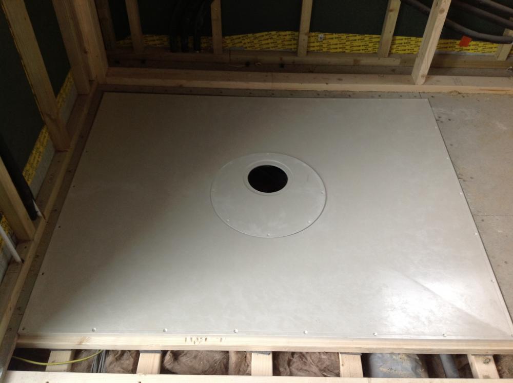

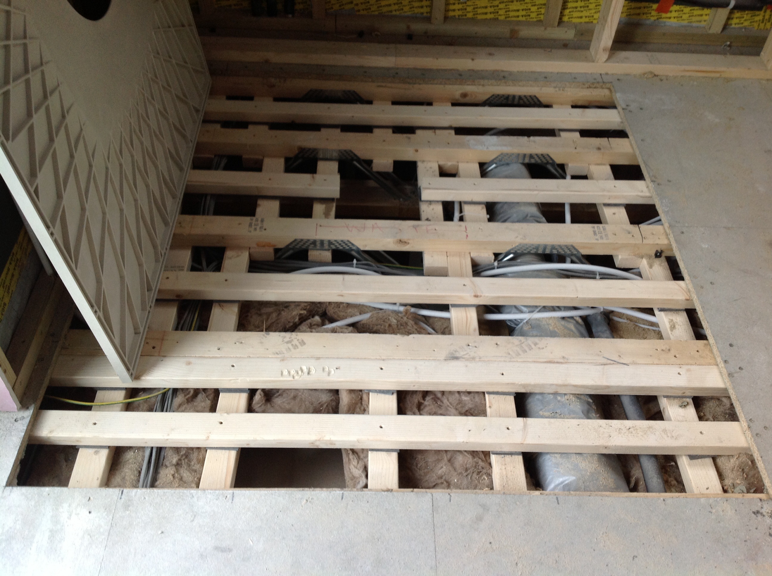

Nickfromwales Posted June 5, 2016 Share Posted June 5, 2016 JG would be my last choice. Sorry. Hepworth push fit is the best I've come across to date, and even with its higher price tag I'd still think twice about going for JG SpeedFit. The inserts for JG are very thick walled, especially their 'super seal' ones, whereas Hep ones are slim stainless sleeves which don't infringe on the internal bore diameter anywhere near as much. Quite important when you're designing for 10mm runs to basins / other outlets and you don't want a trade off between delivery losses and flow rates. The diamond tray I fitted was a one piece jobbie that had the waste outlet offset with a simple / clever design that meant to miss a joist you just rotated the tray by 180 degrees. It's currently and happily nestling away under those mosaics as we speak. . Been in for 6 - 8 months or more now and zero complaints. I'm in regular contact with my customers so I get real life feedback which is helpful. That pic shows the 300/500mm offset, and the joists ran parallel with the length of the tray, so an 800mm wide tray with a centre outlet would have landed 3/4 onto the second joist. Impey are the innovators though as they do a rotatable 'double off-settable' outlet which is second to none. This pic shows ( look carefully ) the MBC pozi joists ( with the metal webs ) and then the ~15 lengths of graded CLS timber ( 3x2 ) that I retrospectively added to provide support for the Impey former shown. Impey say that they're happy with less, my OCD says otherwise ( and CLS is pennies in the grand scheme so I choose belt and Bracey-McBrace ). The mosaics got grouted with an anthracite grout and looked great alongside the Amtico. Word of warning, the bars in the Amtico ( where the joins are ) want to suck the grout wash-up residue in with capillary action. Mask the edges well as it's a right pita to be cleaning that until 3am, ask me how I know . Solvent weld waste of any decent make will be fine. Most important discipline is cleaning the swarf / burr from inside the pipe after each cut. Failure to observe that will leave a rough 'crown' inside each joint where hair will snag and cause issues later down the line. From an ongoing self-maintenance POV I always run 50mm waste to any shower / tray / former etc and always make sure the pipework can be got to for rodding later down the line. Always try to avoid 90o bends, and use 2 x 45o bends instead, slightly separated, which will make rodding / clearing much easier and make the run 'further penetrable' during such action. 3 Link to comment Share on other sites More sharing options...

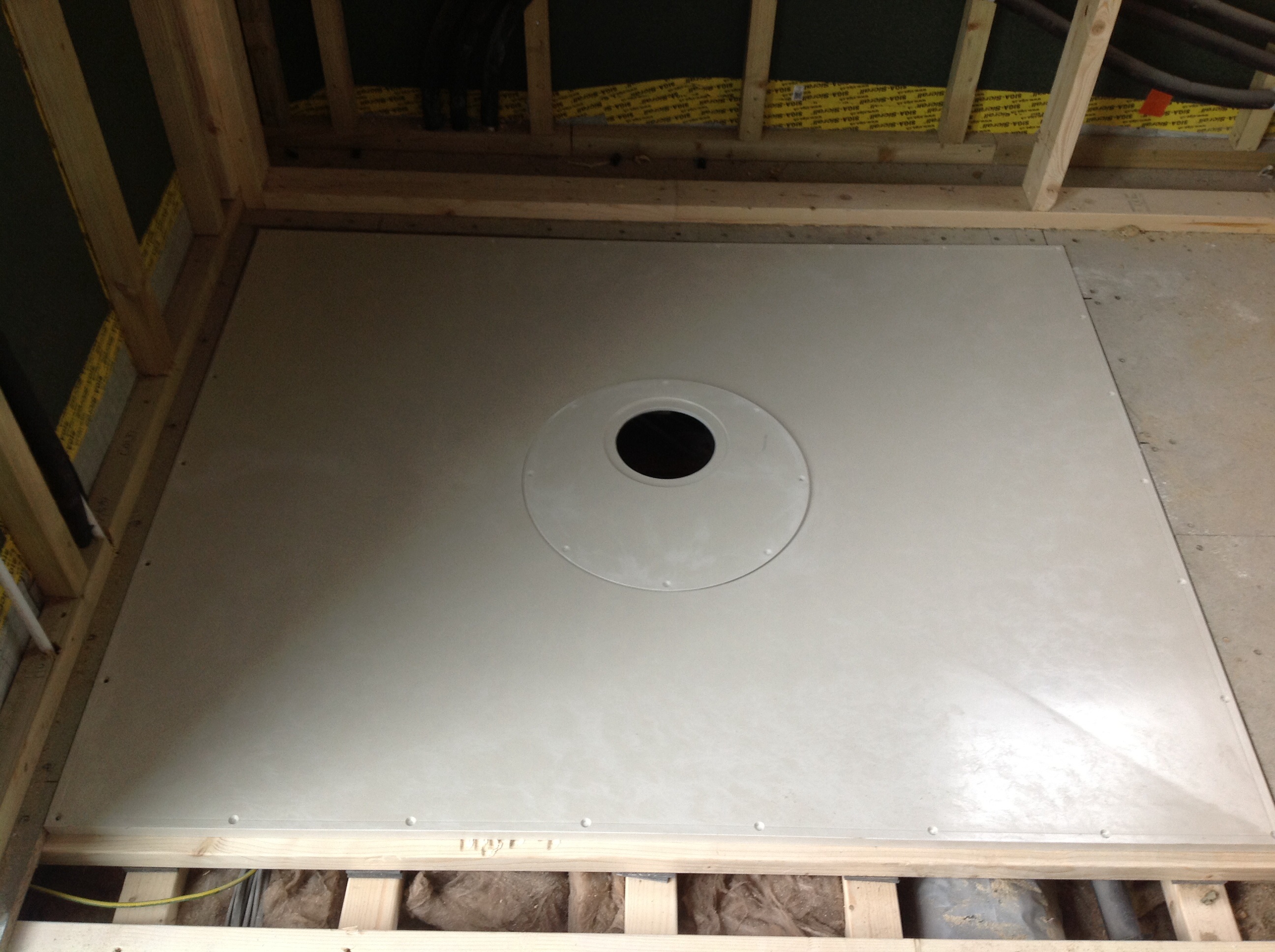

JanetE Posted June 6, 2016 Author Share Posted June 6, 2016 (edited) This is very useful, thanks. The pics look great Nick. We will look at Hepworth. Out of interest should we use the pipe that is inside a sleeve for our runs? I seem to recall that Jeremy used marine ply glued to his bathroom floors, would we need to do that? We shall probably be using ceramic tiles on two of the floors and Amtico on the other. Edited June 6, 2016 by JanetE Link to comment Share on other sites More sharing options...
Jeremy Harris Posted June 6, 2016 Share Posted June 6, 2016 I laid large format travertine stone (600 x 300) 12mm thick on our bathroom and the 18mm OSB flooring (on top of Posijoists on 400mm centres) was already down. I fitted a relatively low profile, very large (2000 x 900) shower tray cemented directly to the sealed OSB. I then screwed and glued 9mm marine play over the remainder of the floor, up to the edge of the shower tray (which fills the whole width of the bathroom). I sealed the edge of the marine play to the edge of the shower tray (just belt and braces) then laid the travertine on that. The travertine has ended up around 10mm below the shower tray upper surface, so it was nice and easy to run yet another bead of sealant to seal that to the tray. We ended up with a shower room that is close to being a wet room, but without me having to take the risk of getting a wet room former right etc, something I'd not done before and didn't have the confidence to do well in a first floor shower room (had it been on the ground floor I'd have gone for a wet room, I'm sure). The downsides were the high cost of the large shower tray and the size and weight of the thing, which made fitting it on my own more than a little bit interesting. It looks OK though, in my view: 2 Link to comment Share on other sites More sharing options...

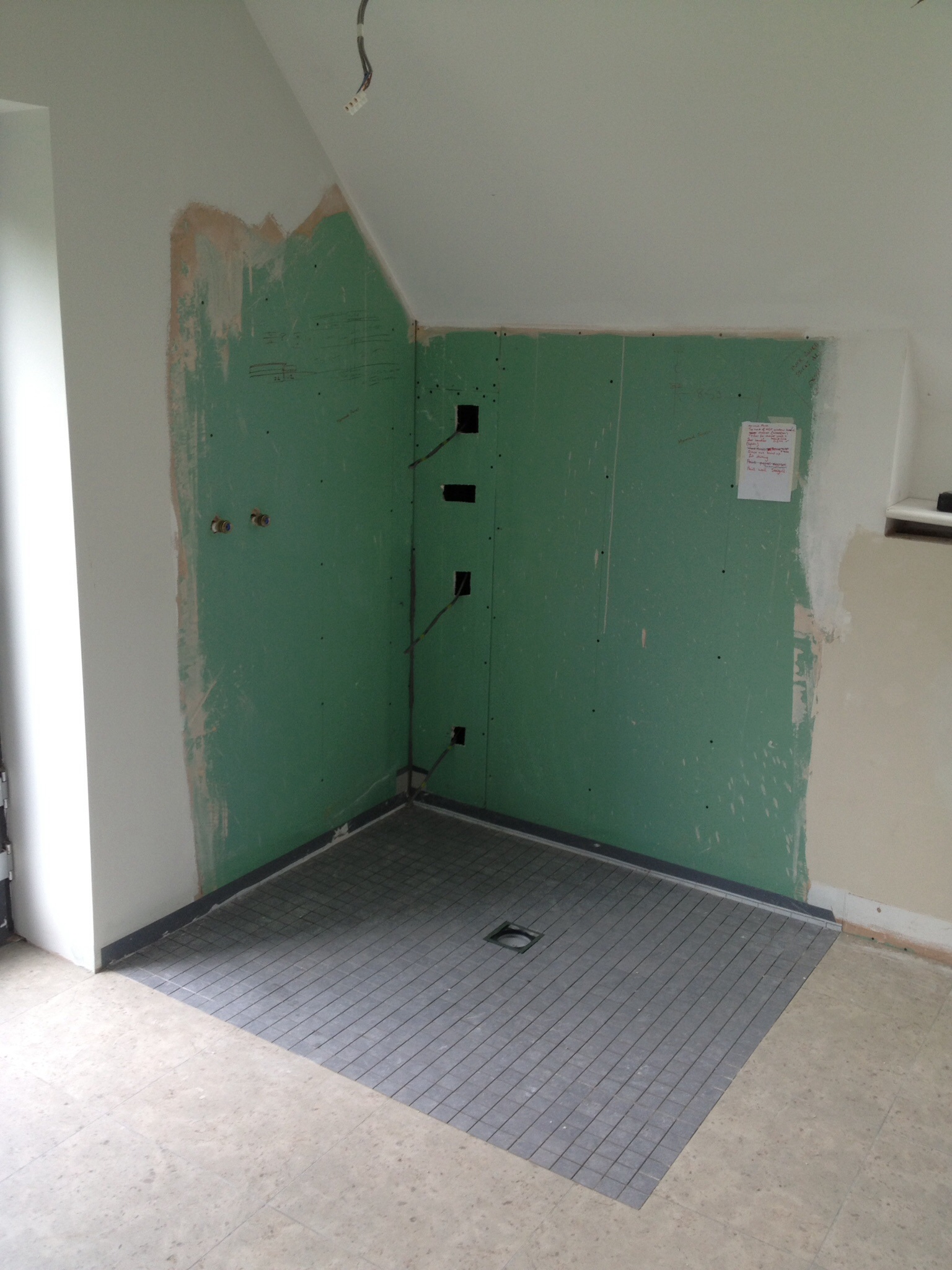

ProDave Posted June 6, 2016 Share Posted June 6, 2016 12 hours ago, Nickfromwales said: It's currently and happily nestling away under those mosaics as we speak. . Been in for 6 - 8 months or more now and zero complaints. I'm in regular contact with my customers so I get real life feedback which is helpful. That pic shows the 300/500mm offset, and the joists ran parallel with the length of the tray, so an 800mm wide tray with a centre outlet would have landed 3/4 onto the second joist. Impey are the innovators though as they do a rotatable 'double off-settable' outlet which is second to none. This pic shows ( look carefully ) the MBC pozi joists ( with the metal webs ) and then the ~15 lengths of graded CLS timber ( 3x2 ) that I retrospectively added to provide support for the Impey former shown. Impey say that they're happy with less, my OCD says otherwise ( and CLS is pennies in the grand scheme so I choose belt and Bracey-McBrace ). Quick question. You added the strips of CLS for extra support. So did you "put up" with a step up into the bathroom? or did you add strips of CLS throughout the whole first floor to raise the entire upstairs floor slightly to avoid a step? Having a level threshold from room to room is perhaps the one place where I am a bit OCD? Link to comment Share on other sites More sharing options...

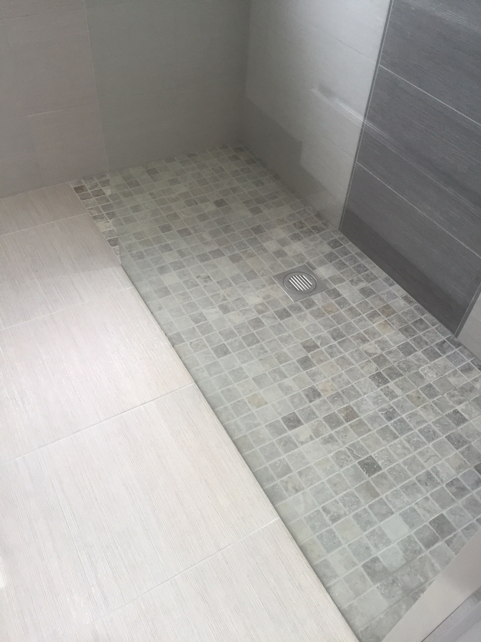

ragg987 Posted June 6, 2016 Share Posted June 6, 2016 13 hours ago, Nickfromwales said: The mosaics got grouted with an anthracite grout and looked great alongside the Amtico. These look great, Nick. Can I just ask about some detail... We will have flush-to-floor shower trays (Bettefloor) and are considering Amtico or Marmoleum flooring, plus tiles on wall and boxing of baths. What did you lay below the Amtico? Aquapanel? We will need to raise the level to match the finished floor in adjacent rooms. How do you waterproof the junction between Amtico and shower-tray? Would a bead of silicone suffice, as with floor tiles? And how would you treat the junction between Amtico on floors and tiles on vertical surfaces? Silicone bead below the wall tile? If it matters one shower tray will be on ground floor, so anhydrite screed below, and the other will be first floor so we would cut out the boards as per your pictures for shower tray. Link to comment Share on other sites More sharing options...
JanetE Posted June 6, 2016 Author Share Posted June 6, 2016 Have another question for Nick. How do you seal between the shower tray former and the floor? Also I notice from your picture that you have turned the mosaics up to the wall, wondering why? If I recall you paint the walls with the waterproof sealant. Thanks Link to comment Share on other sites More sharing options...
Nickfromwales Posted June 6, 2016 Share Posted June 6, 2016 4 hours ago, ProDave said: Quick question. You added the strips of CLS for extra support. So did you "put up" with a step up into the bathroom? or did you add strips of CLS throughout the whole first floor to raise the entire upstairs floor slightly to avoid a step? Having a level threshold from room to room is perhaps the one place where I am a bit OCD? Look again at the pics All that 3x2 was retrospectively fitted to the existing MBC pozi joists but all under slung, perpendicular first to create a cradle, then overlaid with more 3x2 run parallel ( spacered accordingly to allow for the thicker timber of the pozi joist ) so all the timber I added never added a single mm to the existing entire floor level. The Weyroc you see in those pics is the original monolevel deck laid by MBC. I cut out that section of 22mm Weyroc and dropped the Impey tray in flush +3mm. The company that fitted the Amtico first overply'd the entire first floor with ply this raising the floor to my anticipated final height, and then I just used tile adhesive to give me the mil or two of fine tuning to get the mosaics completely flush to the amtico. I don't 'do' steps so my OCD is on a par with yours! . And yes, it wasn't easy. Link to comment Share on other sites More sharing options...
Nickfromwales Posted June 6, 2016 Share Posted June 6, 2016 49 minutes ago, JanetE said: Have another question for Nick. How do you seal between the shower tray former and the floor? Also I notice from your picture that you have turned the mosaic's up to the wall, wondering why? If I recall you paint the walls with the waterproof sealant. Thanks The dark strip you see returned up the walls is the Impey tanking strip, not a row of mosaics . The tray to floor junctions were all tank stripped too prior to the Amtico going down. That job had mermaid panels fitted so no need to tank any further up the wall than the remainder of the width of the tanking strip, eg 120mm ( or so ) wide strip = 60mm flat and 60mm vertical. 1 Link to comment Share on other sites More sharing options...
Nickfromwales Posted June 6, 2016 Share Posted June 6, 2016 2 hours ago, ragg987 said: These look great, Nick. Can I just ask about some detail... We will have flush-to-floor shower trays (Bettefloor) and are considering Amtico or Marmoleum flooring, plus tiles on wall and boxing of baths. What did you lay below the Amtico? Aquapanel? We will need to raise the level to match the finished floor in adjacent rooms. How do you waterproof the junction between Amtico and shower-tray? Would a bead of silicone suffice, as with floor tiles? And how would you treat the junction between Amtico on floors and tiles on vertical surfaces? Silicone bead below the wall tile? If it matters one shower tray will be on ground floor, so anhydrite screed below, and the other will be first floor so we would cut out the boards as per your pictures for shower tray. Some answers are in my previous two posts. Check through and come back with anything I've missed. The junction between the tiles and floor covering is done in CT1, NOT silicone. CT1 doesn't have a short life like silicone and doesn't go black / mouldy. 1 Link to comment Share on other sites More sharing options...
