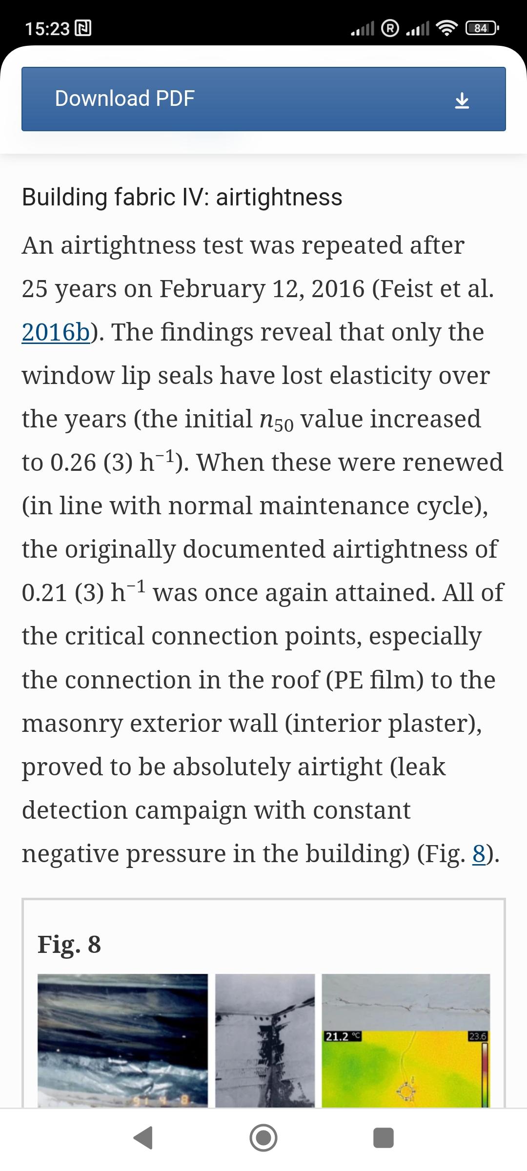

Iceverge Posted May 1, 2023 Posted May 1, 2023 1 hour ago, SteamyTea said: Airtightness and continuity of insulation. Airtightness is all down to the junctions. This is common to all build types. If you do a good job of the penetrations and use wet plaster with masonry it's not rocket science. No reason you couldn't do a membrane and service cavity inside a masonry wall like a TF. It'd be a lot cheaper. I was worried about continuity of insulation with ours but the bonded beads filled every single nook and cranny. I test drilled some awkward places to check and had a good scan with the thermal camera too.

SteamyTea Posted May 1, 2023 Posted May 1, 2023 Just now, Iceverge said: use wet plaster with masonry it's not rocket science. Every place I have ever lived in that had plastered solid walls, all had cracks in them. Some had bulging plaster. So I would not think the long term airtightness is going to be brilliant. But no need to worry, people will quote the ACH figures from the testing date.
Iceverge Posted May 1, 2023 Posted May 1, 2023 1 minute ago, SteamyTea said: Every place I have ever lived in that had plastered solid walls, all had cracks in them. Some had bulging plaster. So I would not think the long term airtightness is going to be brilliant. But no need to worry, people will quote the ACH figures from the testing date. We have some settlement cracks but I've filled them with sealant and painted over. At least I can see them. Time will tell about the overall airtighess. I would be curious to do another test in 10 years. There have been some suggestions of houses getting more airtight over time. This masonary house only got a worse score after 25 years due to the window seals. https://link.springer.com/article/10.1007/s12053-019-09781-3
