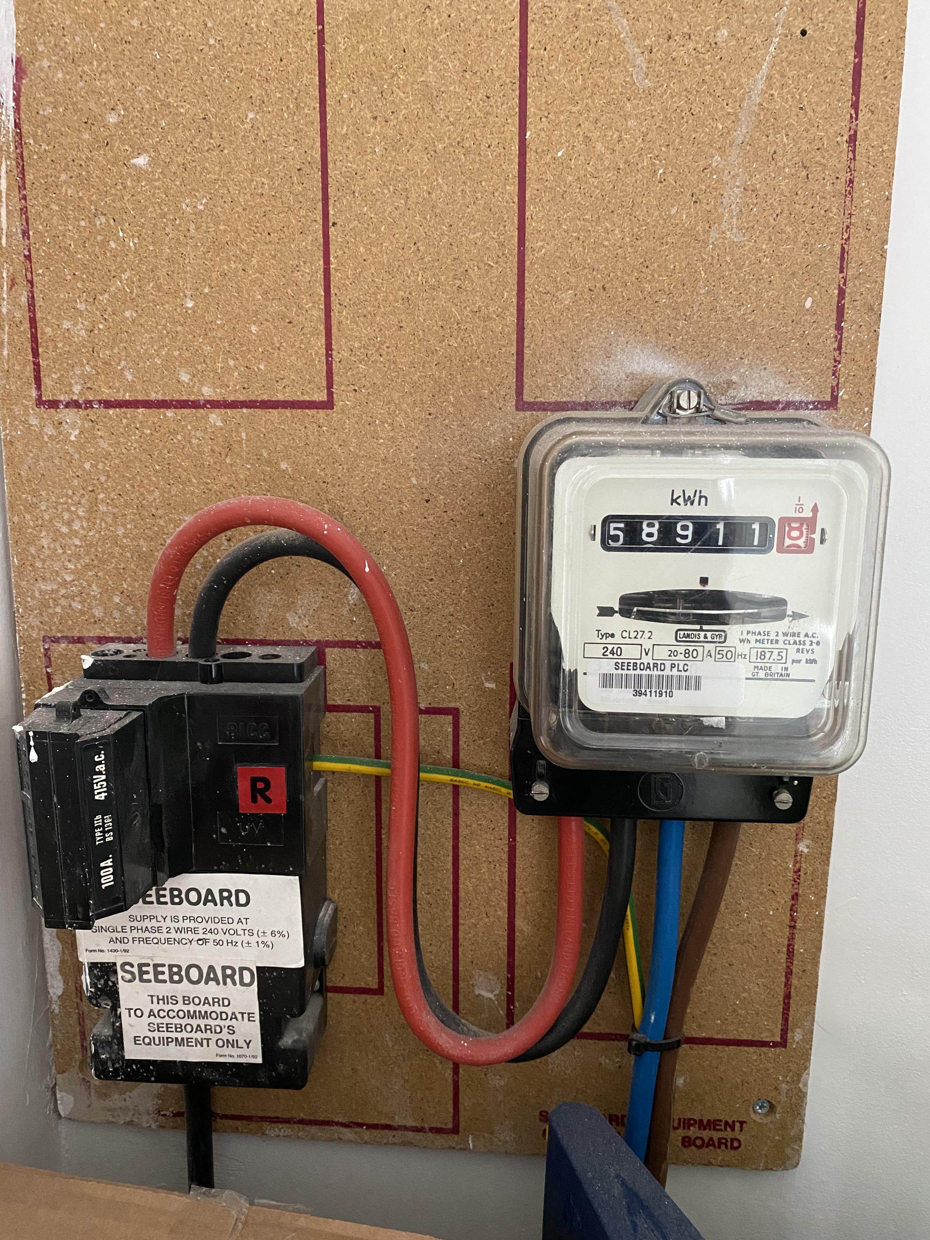

Just on that - should I get one fitted by my current supplier now, or would it make more sense to have it done after I sign up to Octopus? Is there a lead in time for meter changes?
Also, as my meter installation has never been touched since the house was built in 1995 it doesn't have a DNO cutout and I'm guessing I'll have to have one fitted.
Will the meter people sort that or will they turn up, sharp intake of breathe then "sorry mate can't fit your meter as no DNO cutout" and then scarper?

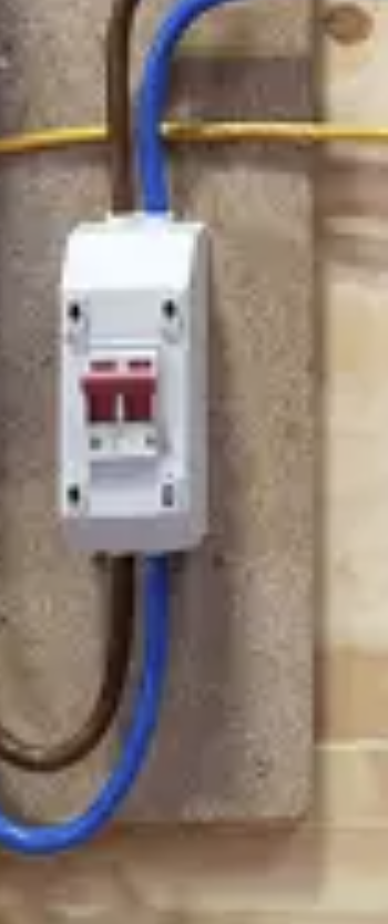

Everything before the meter is DNO responsibility, so you won't ask anything of the fitters other than "would you like a cup of tea?" Do not start off by saying "please fault my sub-standard home!". ;) Just leave them to it.
Go on, post a picture, I find it hard to believe a 1995 install does not have a DNO cutout.  Lets at least see the bodge someone has done.  If it was you, don't admit to doing it.
Here you go.
Pretty much as it was when we bought the house in 1995, except for the upgraded meter tails the electrician did a few years ago when we extended and had a new consumer unit installed (hence the missing seals!)
1 hour ago, Rob99 said:
Here you go.
I hope that black thing is a DNO cutout otherwise I don't have one either!
Yes, that's technically a DNO cutout, it's the incoming main with a 100A supply fuse.
I was referring to the type of DNO cutout which is a double pole isolator installed after the meter so that fixed wiring/consumer units etc can be isolated without touching the meter/supply fuse (which technically you're not supposed to as it's not yours.
