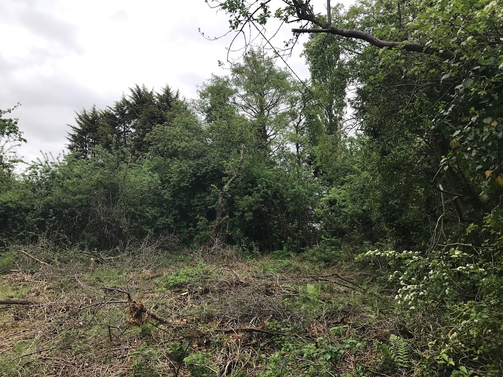

Andrew Posted August 3, 2017 Posted August 3, 2017 Hello, We have had our offer accepted on a plot in a Cheshire village. It has detailed planning permission for a five bedroom house. It's quite a traditional design and we're uncertain at the moment whether we are going to try to modify the existing permission or start again with a new design, but we'll get to that once we've got the land purchased. I've been lurking on this forum for quite a while and it's definitely one of the most helpful and knowledgable forums I've seen. You often get a lot of armchair experts on forums but what strikes me is that there's so much practical knowledge and real world experience being shared. We're very much at the beginning of our journey and so far there's a bewildering amount of choices to be made and knowledge to be gained. To start with I'm sure I'll be mainly asking questions here, but do hope to contribute wherever I can. So in that vein, what would you recommend to commission in terms of surveys before purchasing a plot? As it already has PP there were obviously a number of reports submitted with the application, which we've been able to obtain. These include bat and badger survey, arboricultural survey, contamination report and a design and access statement. The plot is a former orchard, although most of the centre of the site has been cleared. There are a number of mature trees around the perimeter of the site, some of which are earmarked to be removed in the arboricultural report. I've already done a fair bit of research around services and have a quote for connecting the electricity supply. There's no mains sewerage so we'll need a treatment plant and no mains gas so we'll be looking at ASHP. I'm having difficulties getting a plan of the nearby water supply as Welsh Water, Severn Trent and United Utilities all say it is definitely not them and pass the buck to one of the others! Any thoughts on the surveys would be really appreciated. Thanks, Andrew
Mr Punter Posted August 3, 2017 Posted August 3, 2017 Can you find out about services from the seller of a neighbour? Also, have they done a ground investigation to establish what foundation type you are looking at?
Andrew Posted August 3, 2017 Author Posted August 3, 2017 No soil survey yet, that's the main one I'm considering. Seller says there is a water pipe running down the road but on opposite side of street. Haven't asked him about the water company, communication is very slow through the estate agent. I want to get a bit further before talking to the neighbors. Both of the immediate neighbors strongly objected to the PP. 1
ProDave Posted August 3, 2017 Posted August 3, 2017 Drainage is the key. If there is no mans sewer then you need a treatment plant. That has to drain somewhere. So you very first test is get some test pits dug and get a percolation test done. The results of that (and the size of the house) will tell you what area of infiltration field (soakaway) you need to provide. Then you need to work out if you have room for that and still have room to build a house. Or are there alternative arangements like a soakaway under an adjoining field etc. No drainage solution = no house so this is crucial. 2
Andrew Posted August 3, 2017 Author Posted August 3, 2017 Thanks for the replies. There is a small brook running down one of the boundaries to the plot and the rough plan was for the outflow from the treatment plan to run into there. I know other nearby properties do this. However I haven't started doing any research into what's involved in terms of permissions, logistics, etc of doing this. It's not a massive plot so if that's not an option then there may be a problem.

ProDave Posted August 3, 2017 Posted August 3, 2017 1 hour ago, Andrew said: Thanks for the replies. There is a small brook running down one of the boundaries to the plot and the rough plan was for the outflow from the treatment plan to run into there. I know other nearby properties do this. However I haven't started doing any research into what's involved in terms of permissions, logistics, etc of doing this. It's not a massive plot so if that's not an option then there may be a problem. You should be okay with that. Getting permission for discharge from the EA seems a whole lot easier than from SEPA up here in Scotland. I had so spend months proposing different schemes, which each got rejected before SEPA would give permission to discharge to the burn, something they only do here as a last resort. 1
ToughButterCup Posted August 3, 2017 Posted August 3, 2017 Welcome. All sensible advice above. One thing might have been missed; a topographical survey. Levels become incredibly important. We are on a gentle slope ; knowing how much of a slope helped us save several thousand pounds of topsoil removal fees. Ian 1

Andrew Posted August 4, 2017 Author Posted August 4, 2017 11 hours ago, recoveringacademic said: Welcome. All sensible advice above. One thing might have been missed; a topographical survey. Levels become incredibly important. We are on a gentle slope ; knowing how much of a slope helped us save several thousand pounds of topsoil removal fees. Ian Interesting point. The site seems generally quite flat and level, but it is slightly lower than the road / pavement level and there is an initial drop down when entering. I've no idea at the moment whether that's an issue or not. With regards to the survey, the site is only partial cleared at the moment. I've attached a photo to demonstrate, most of the site is like this, except for a corner which is still overgrown. Also, the photo was taken in May and things have grown a bit since then. I had assumed the topographical survey would need to wait until the site is fully cleared?

Andrew Posted August 7, 2017 Author Posted August 7, 2017 Thanks for the advice and suggestions. The PP runs out in October 2019. It's probably too early to tell with the solicitors - my observations so far are based on the standard letters / documentation they've sent. They don't have the contract from the sellers solicitor yet and I hope that once we get a bit further they will prove to be competent. I did speak to several solicitors and made a selection based on their knowledge, professionalism and frankly how easy it was to communicate with them. I do accept that, correct or not, it's my responsibility to ensure all the bases are covered and risks that it's possible to know about have been identified. @JSHarris - thank you for the list of considerations, all are covered or under investigation. I am going to commission a soil survey before purchase - if anything untoward is identified then it will give me cause to re-negotiate. There is quite a lot of recent development in the village, including plots across the road and a new house being built in an immediate neighbours garden. That gives some reassurance that there are no fundamental issues, but I appreciate conditions can change in a short distance, hence the survey. I am unsure about a topographical survey - I think the site probably needs to be cleared before we cans do this but I'm going to speak to a local survey company later today and see what they say. I have done a considerable amount of reading, including the Housebuilder's Bible from cover to cover. I've also spoken with anyone who will give me the time of day, including local estate agents (mainly to get an idea of potential value, to assist in my negotiations on the price), the local council building control office to get any insight they may have, the architect who put together the PP submission (obviously working for the vendor) and some of the builders working on the nearby developments. One challenge we do have is that we currently live 100 miles away from the plot, but will move up before starting any work. On 06/08/2017 at 08:25, recoveringacademic said: Why? Because your design taste will be changed by the process of planning for building it. Exactly the same way that drinking cheap red wine , with persistence, evolves into the odd glass of serious claret. Because the PP came with the plot. The architect who produced the design for the PP told me himself it was the simplest, most uncontroversial design they could muster to get through planning. There were issues with planning, not with the design, but a question of whether the site was within the built up envelope of the village. It was granted on appeal. As there's no guarantee another design would get through planning we asked ourselves would we be happy with the house as it was currently designed - the answer was yes, but with some changes to the internal layout which we confirmed wouldn't be an issue. However if we sat down with a blank piece of paper the house that has planning is not the house we would come up with. Like everything there are many considerations, including - the house needs to be designed for the plot (the current design sits pretty well on the plot), the likelihood of a new PP submission being approved, the impact on timescale and finally the impact of cost. We have had the current design costed by an estimator service, so we know in theory what the build costs could be. We have a (starting) budget and timescale in mind so when we have the land purchased we will work with an architect or designer to help us, taking into account the constraints, decide what the best way to proceed is. On 06/08/2017 at 08:25, recoveringacademic said: But solve the water supply issue first. There is a long cautionary tale about that to be found on @JSHarris blog. I had a breakthrough on Friday, United Utilities fessed up to being the supplier. A plan is on its way and I'll also get a full quote for the connection.
Ferdinand Posted August 7, 2017 Posted August 7, 2017 (edited) It sounds as though you are taking your risk / opportunity -assessment very seriously, which is excellent, On 07/08/2017 at 11:23, Andrew said: I am unsure about a topographical survey - I think the site probably needs to be cleared before we cans do this but I'm going to speak to a local survey company later today and see what they say. They probably could - it is not difficult to apply a staff to the ground through a bush or twenty. And topos are an inexpensive one to do. On 07/08/2017 at 11:23, Andrew said: As there's no guarantee another design would get through planning we asked ourselves would we be happy with the house as it was currently designed - the answer was yes, but with some changes to the internal layout which we confirmed wouldn't be an issue. Your position is stronger in that the principle of development is conceded for that site, and that entrances etc are approved - so those are elephant traps which have been filled in. And October 2019 is comfortingly far away for you to try Plan B before Plan A turns back into a pumpkin.Assuming the purchase happens quickly-ish. You should also be able to reuse some of the reports with no even potential problems due to expiry dates etc (even though the LPA are very unlikely indeed to notice). If you have problems with assignment of report you could possibly use weasel wording such as "a previous report on this site found that...". Ferdinand Edited August 17, 2017 by Ferdinand
