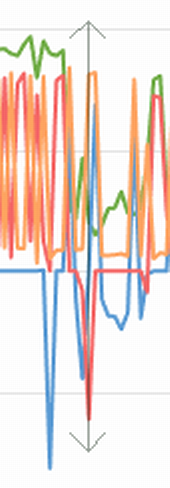

That spike looks like those random (to me!) spikes that I see sometimes

3 hours ago, MrTWales said:
If it was consumption of 6kw I think the orange line would be at 6kw,
"Consumption" does indeed sound like local power demand - be it supplied by solar PV, battery or grid (or combination thereof) but seeing as how Grid is positive for exporting (i.e. when your battery is max'd out, all the excess power suddenly switches to going out to the Grid) then negative (below the line) would signify import.
image.png.183f435a740e4fb915e7311fc71b0acb(1).png.88113d5b72d9b6f48c04224b3b2f4d1c.png
The way the red trace slopes down initially looks more than a spike to me. Just before, the battery took on charge while PV briefly rose. Then the Grid spike overlaps the battery discharge and consumption making it look to me as though the battery inverter reached its maximum generation limit (3kW?) and the load was such that a top-up was needed from the grid. That's what it looks like.

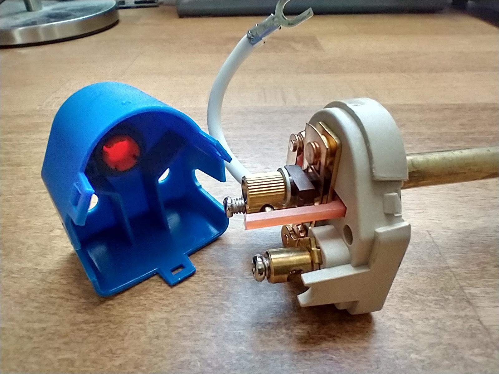

I put my immersion on to an external thermostat, as I could never get the cylinder hot enough, even replaced the immersion and integrated thermostat, but it made little or no difference.  Max temp I could get to was about 60, even the immersion thermostat set at 75.
I'm also struggling to get more than 58oC hot water even when the built-in immersion thermostat is dialed all the way up to 70oC
While I've also contemplated bypassing the immersion thermostat and controlling the heater with an external thermostat, I'm wondering if there's a reason for this apparent 'universal limitation' among like devices?
Do they deliberately underrate them because they'll rapidly fall over if made any hotter? Seems odd that they'd consistently mislead with the temperature dial.

It could be the thermostats in the heating element, it could be seeing local temperatures at the set point, but the cylinder isn't at that temp.  My view it's just a rubbish design that is just copied.

So perhaps the water right next to the pocket with the sensing element in it does actually reach the setting on the dial, in which case the 70oC might be the truth. Maybe the difference with the temperature at the top of the tank reflects the physics of the water blending?
The worry here is that bypassing the stat could lead to local boiling. I'm not worrying about catastrophic boiling of the whole cylinder but the consequences of boiling at the element might have a subtle effect on the element - might it push it past some design limit?

I can see what you are saying but it does seem like consumption really is consumption (though how accurate it is is another matter). If I look at the history data it shows the following: it looks like the immersion flicked on and it took a while for the battery to discharge. As far as I can see, the battery can discharge at 4kW at least as I've seen this "pDisCharge" value on other days (I'm fairly sure that this is the limit).
The chart uses 5 min incremements so I think some spikes can look bigger than they are.
Your Luxpowertek app says that your system is capable of discharging at up to 180amps = c. 9kW
Thanks, that seems like a lot. I think I just assumed 4kW as when I looked at the data there were a few discharge figures around there but it may be concidence.
Testing the rod thermostat out of the cylinder I found the switching point is around 15oC lower than shown on the adjustment pointer. Difficult to say exactly because of around 5oC hysteresis. 15oC certainly tallies with what I was finding with the dial set to 70oC and getting water at 55oC. I took the cap off the thermostat assembly and found the pointer sits on a splined shaft so can be put back on with an offset. Trying that now.
In defence of @Radian I did much the same.
My immersion (similar design) cur out at I think it was about 62 degrees with the thermostat at max. So I made pretty much the same adjustments.
Each time I raised the "thermostat range" I tried it, using the ASHP's probe to measure the new cut off temperature.  I stopped adjusting when it would reach 78 degrees and then cut out.  That is still well below any danger level but allows quite a bit more surplus PV to be stored in the tank.
All I would say is if you try such a thing, you need an independant, trusted means to measure  the temperature your thermostat cuts out after being "adjusted"
I can't say I've ever thought of accurate calibration as a risk of any kind, moreso when there's a failsafe anyway...
Don't under estimate the danger of boiling the water in an UVC, hence why I made a series of small adjustments checking progress after each one.
Absolutely. But it would be *incredibly* bad luck for both the 'stat's redundant overtemp AND the T&P valve to both fail.
