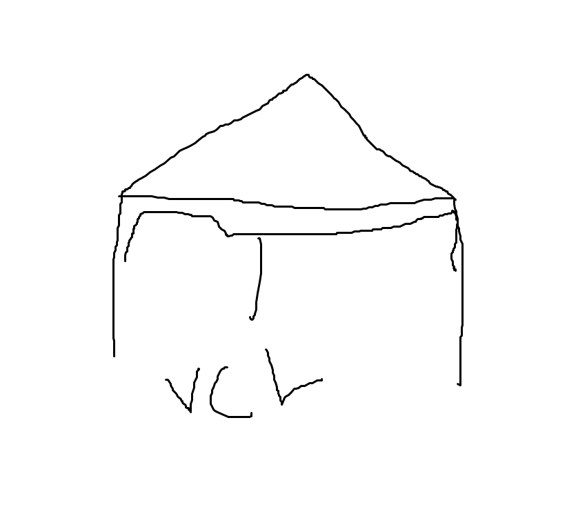

BotusBuild Posted April 17, 2023 Author Share Posted April 17, 2023 On 13/04/2023 at 09:23, Dave Jones said: be sure to bring it down onto the internal walls. Can you show a diagram of this so I totally understand what you mean? Thanks Link to comment Share on other sites More sharing options...
Dave Jones Posted April 17, 2023 Share Posted April 17, 2023 9 hours ago, BotusBuild said: Can you show a diagram of this so I totally understand what you mean? Thanks   1 2 Link to comment Share on other sites More sharing options...

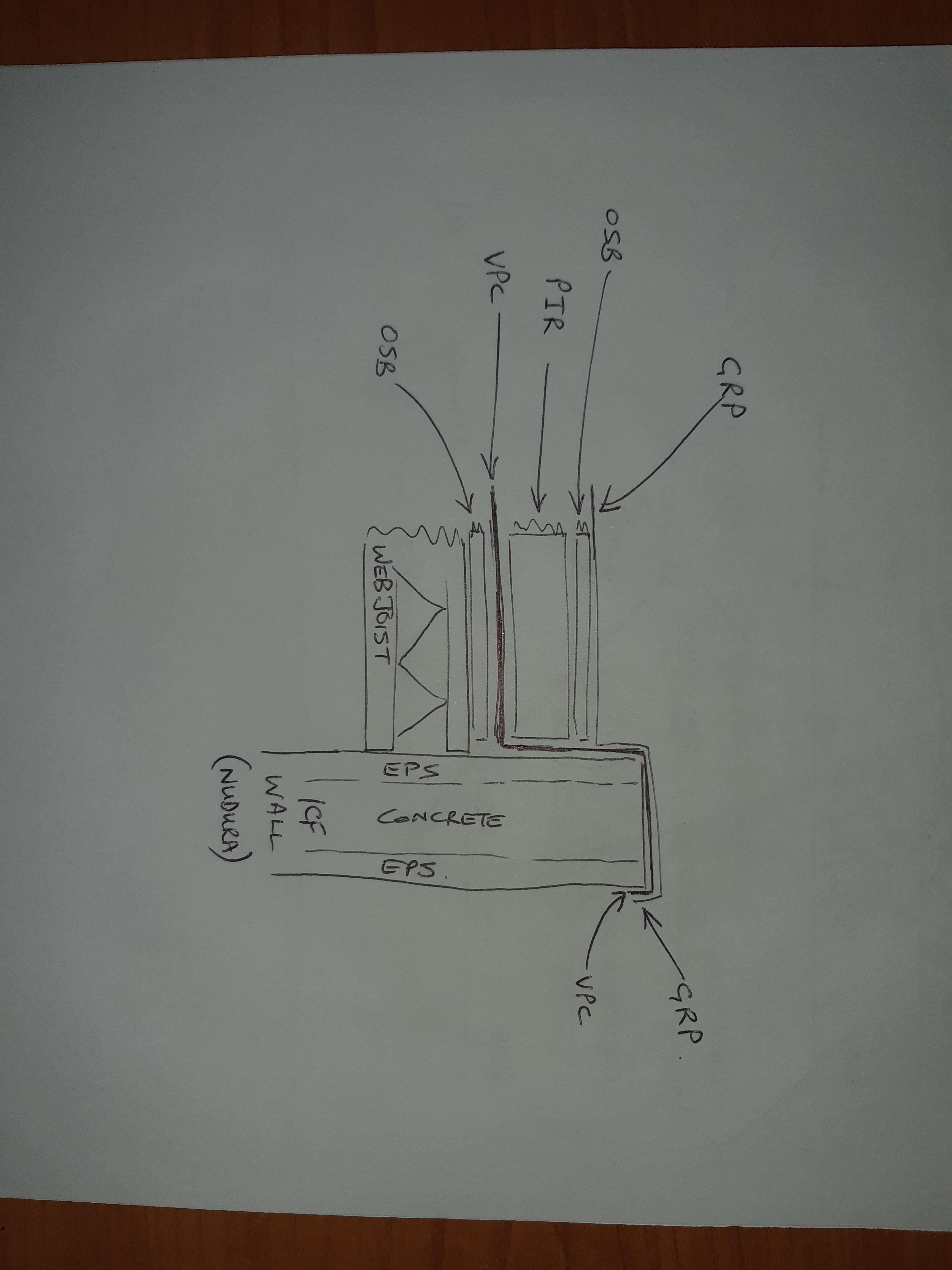

BotusBuild Posted April 24, 2023 Author Share Posted April 24, 2023 Back to the VCL. For the flat roof build up in the OP, if I've laid OSB over the top of the joists how the heck would I get VCL to go down, past the joists as suggested by Dave Jones. Doing that would be a ballache. Surely the VPC should go up and over the wall, with the PIR on top of it? FYI, the exterior walls continue up above the joists to withhold the warm roof and then a green roof. The GRP will also go up and over the external walls. I'll add a drawing later, and maybe a photo or two Link to comment Share on other sites More sharing options...
BotusBuild Posted April 24, 2023 Author Share Posted April 24, 2023 Link to comment Share on other sites More sharing options...
Dave Jones Posted April 24, 2023 Share Posted April 24, 2023 is it a parapet roof ? Link to comment Share on other sites More sharing options...
