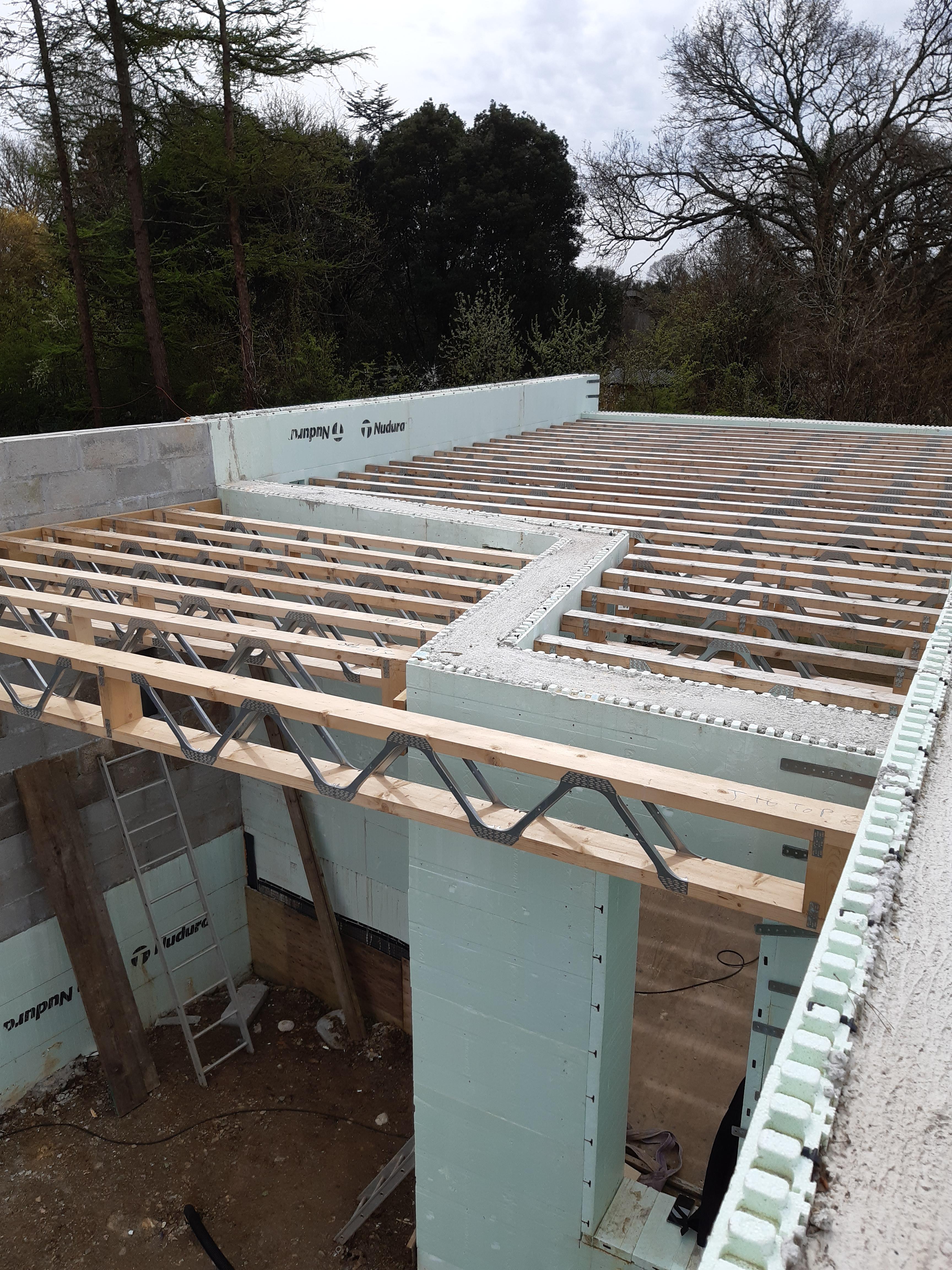

Warm roof - which vapour control layer and which PIR?
The Nudura in the above diagram is shown in this photo
if thats the flat roof then its easy, run the alutrix up the wall. Have a look at kingspan thermataper save having to mess about with firring strips.
12 minutes ago, Dave Jones said:
is it a parapet roof ?
Part is flat, see photo above, part is a single slope of about 9-10 degrees, but essentially being treated as if it is a flat roof.
The whole lot will have a green roof on top of the warm roof construction
